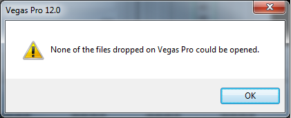

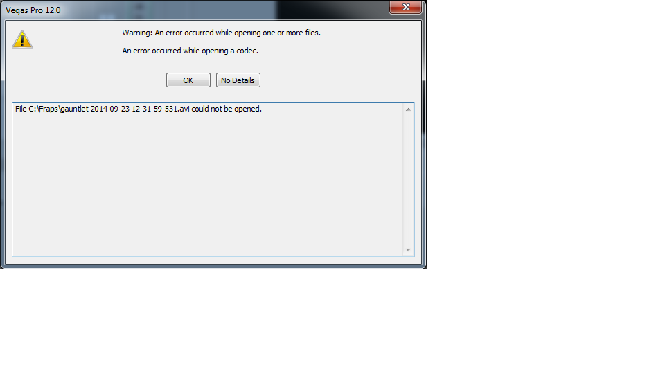

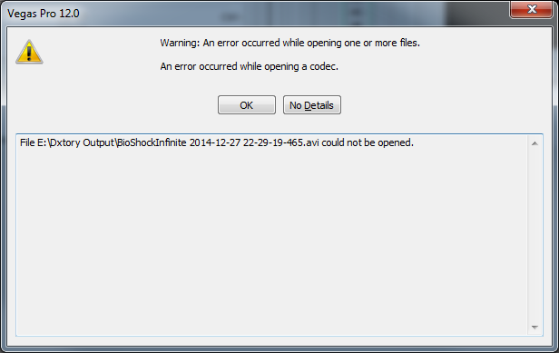

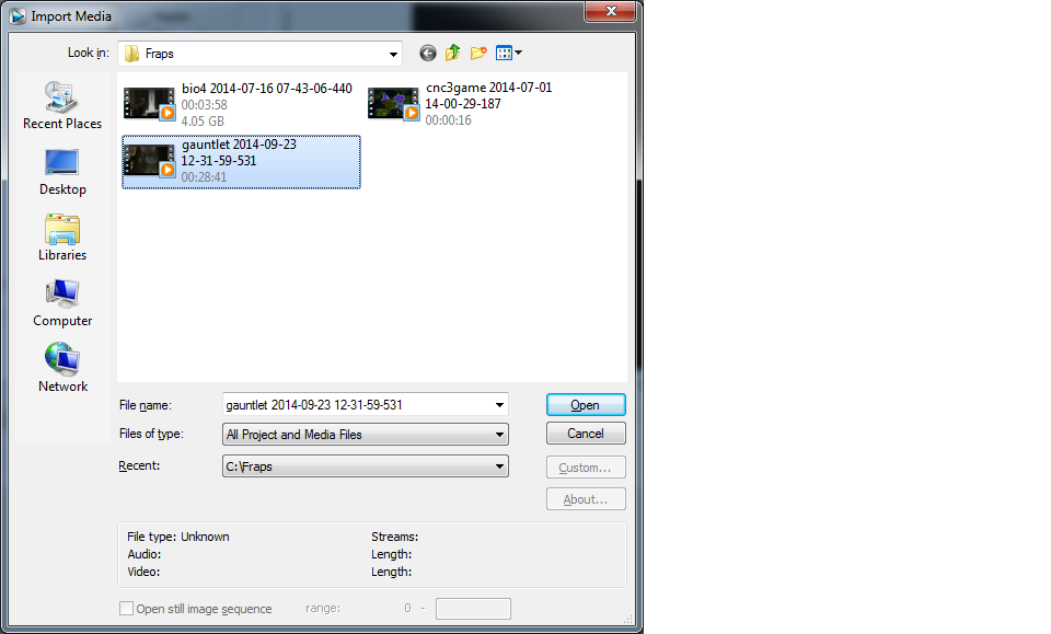

  1. Hey guys for some reason Sony Vegas just randomly decided not to work with my videos for like no reason.
    Just a few days ago i could take footage i recorded in DXtory with the Lagarith lossless codec and it just says when i drag it in "None of the files dropped on Vegas Pro could be opened".
    and when i try to import it it says "Warning an error occurred opening one or more files" An error occurred when opening the codec.
    I have lagirth installed so why isn't it working? I tried installing and uninstalling it, i re installed vegas and nothing, and i removed any other codecs i had downloaded and it still won't load my videos, please help me out here.
    Oh and when i try to import it, it lists the file as unknown so what the hell???

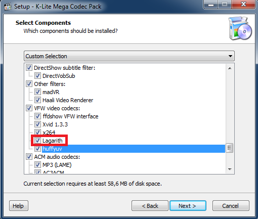

  6. Member budwzr's Avatar
    Apr 2007
    City Of Angels

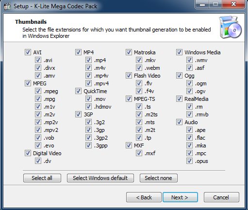

    You need a VFW codec pack like K-Lite, and then enable Lagarith in the Decoder section.
  7. when installed K-Lite I can view the video files now in WMP, but sony vegas still refuses to accept the movie files.

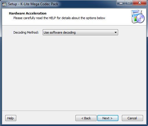

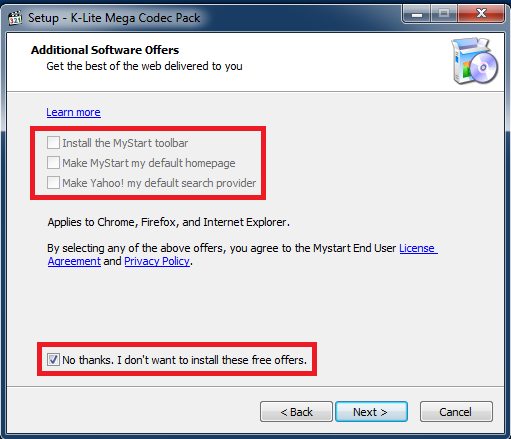

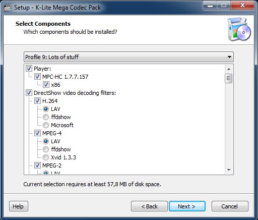

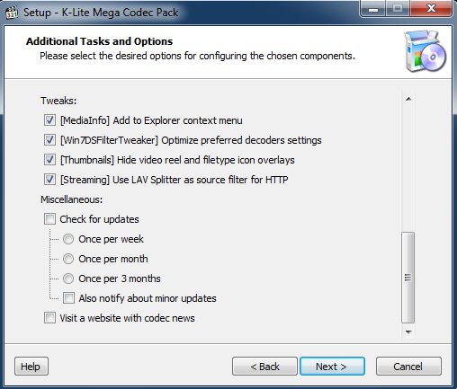

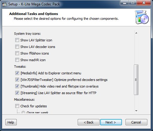

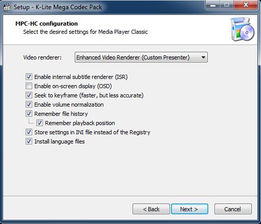

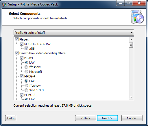

    Hi DarkShadowRage,
    Just install K-lite Mega Pack using LAV filters for ALL.

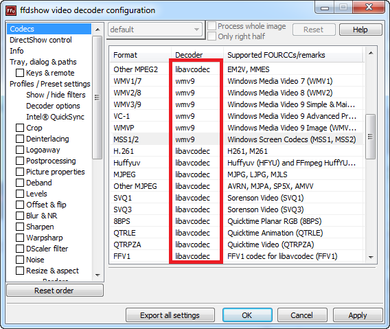

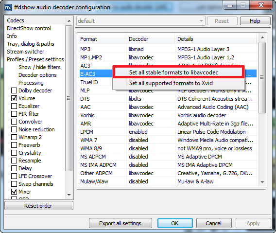

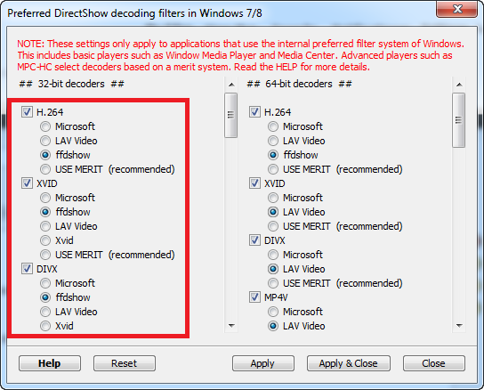

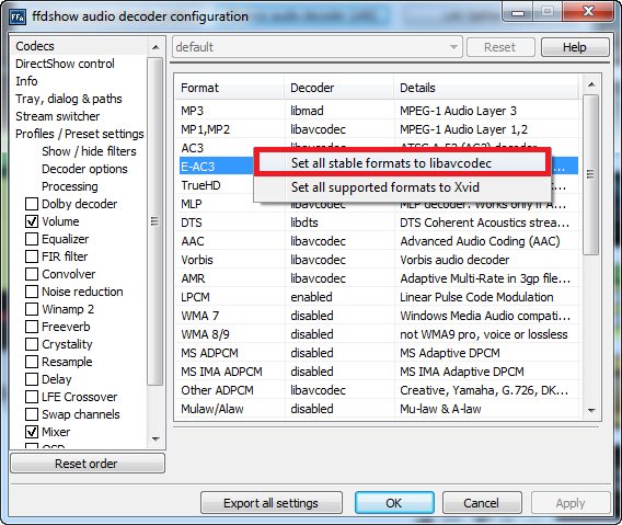

  14. Lone soldier Cauptain's Avatar
    Jan 2006
    Brazil
    Originally Posted by DarkShadowRage View Post
    I will try this! thanks for the detailed response!
    DarkShadowRage if failed dont worrie.

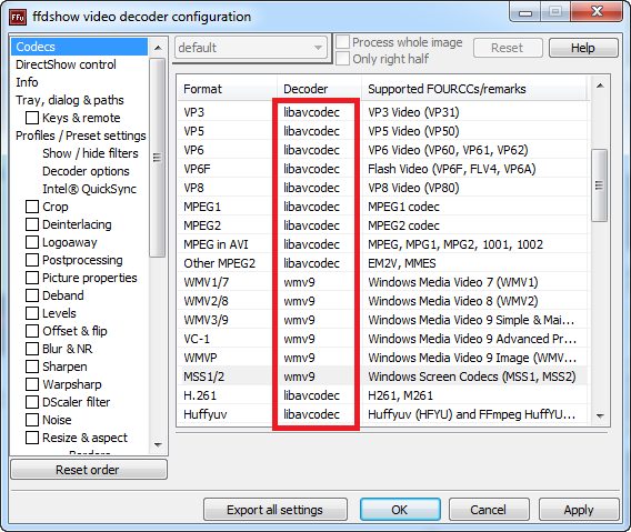

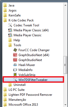

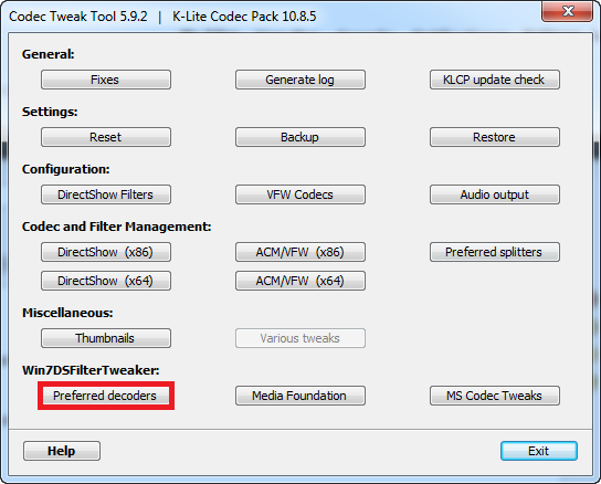

    Go to Start, K-Lite Codec Pack, Tools and clic in Win7DSFilterTweaker
    Go to Preferred Decoders and set all to FFDSHOW, apply and reboot your PC.
  15. And i just now did that and this still happens:
    I ticked LAV for everything and it still wont accept ANY avi file regardless of the codec.
    Edit: just saw the response i will try that.
    edit: just tried that and i still get the same error as above. however i missed the reboot part, i shall do that soon.
    but as of now i still get that same error as above.

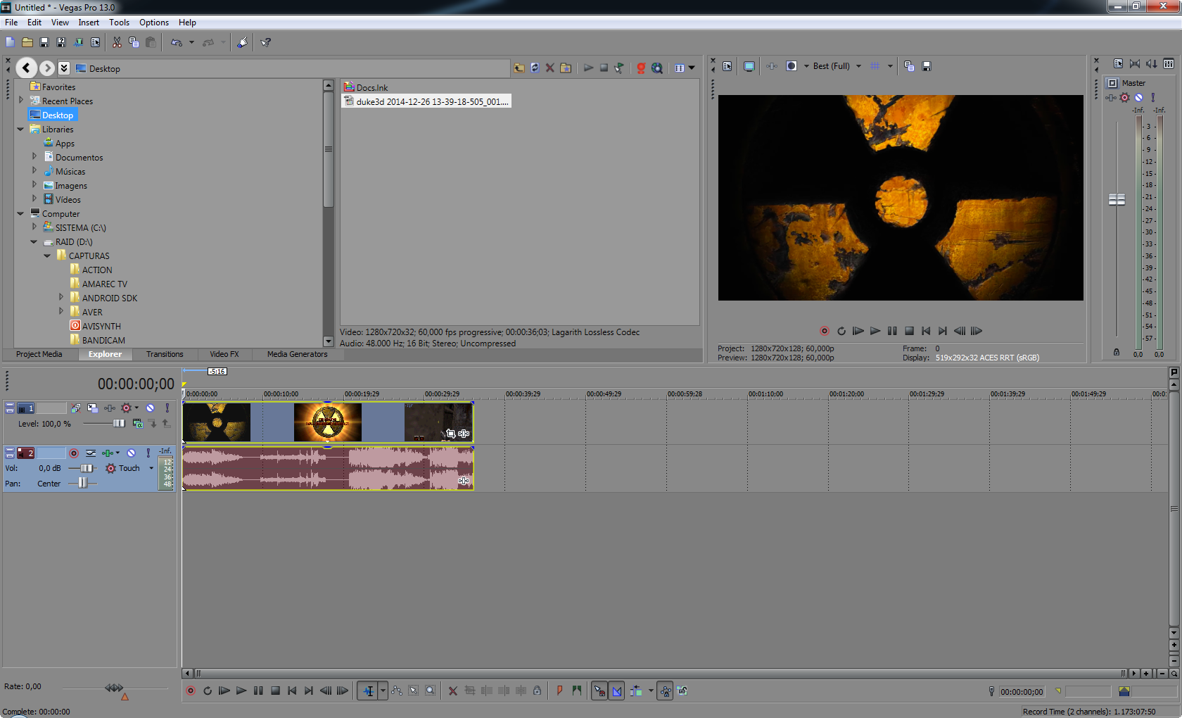

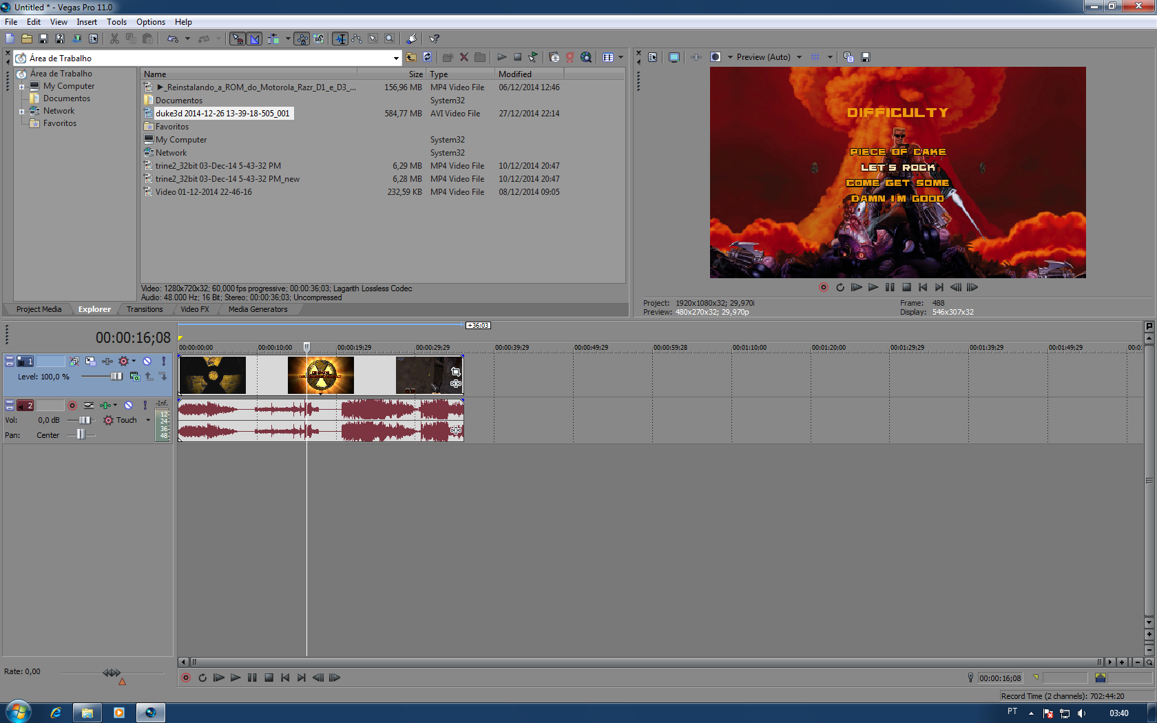

    DarkShadowRage, I opened file in Vegas 11 and Vegas 13.
    Your file is fine.

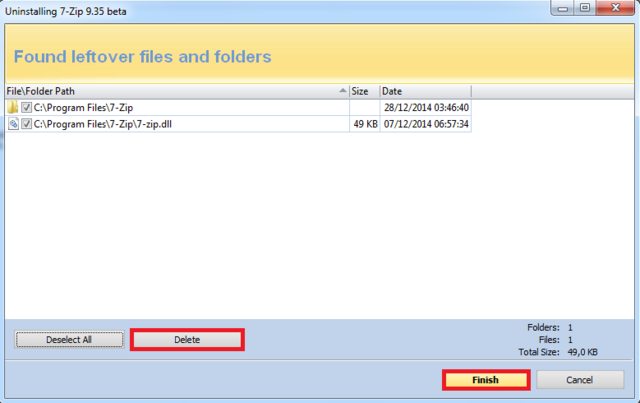

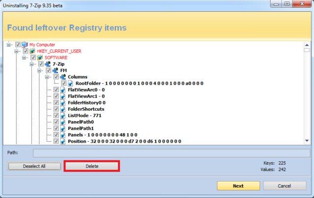

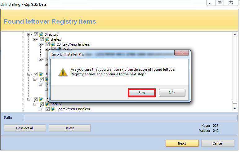

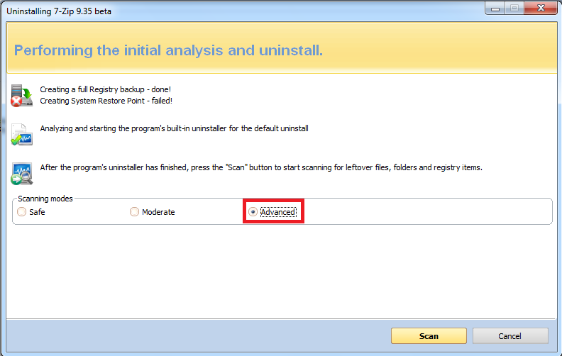

    Probably Sony Vegas 12 installation is corrupted. Get Revo Uninstaller Pro trial and remove it using method below.
    Try and reply.
  20. Just tried that with that program still get the error

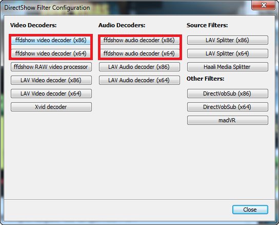

  21. Lone soldier Cauptain's Avatar
    Jan 2006
    Brazil

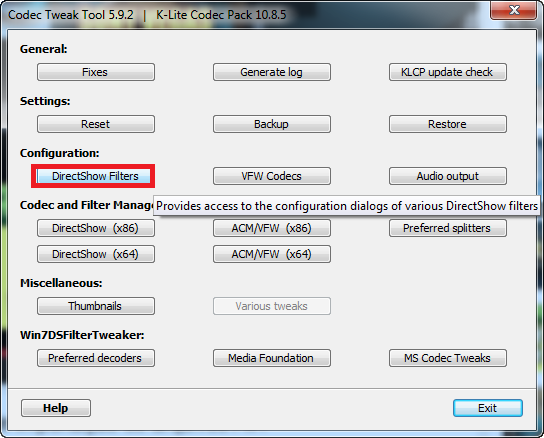

    Last try...
    Go to Preferred Decoders and set all to FFDSHOW, apply and clic in DirectShow Filters and select like shots:
    Reply.
  22. When i do import media i Get this error when I drag it, I get the other error, I tried everyone of your suggestions, what on earth could possibly be stopping this thing from reading the files? there has to be something, is it the aviplug.dll? can you upload your aviplug from your vegas 12 or something? I don't understand, i've uninstalled vegas, i've reinstalled it cleanly what's going on? can you try uploading your avi plug?
    There has to be SOME way to make this work.

  24. So why is it giving me the codec error then? if it opens for everyone else it should for me right? so what gives

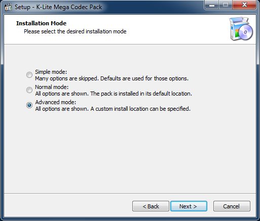

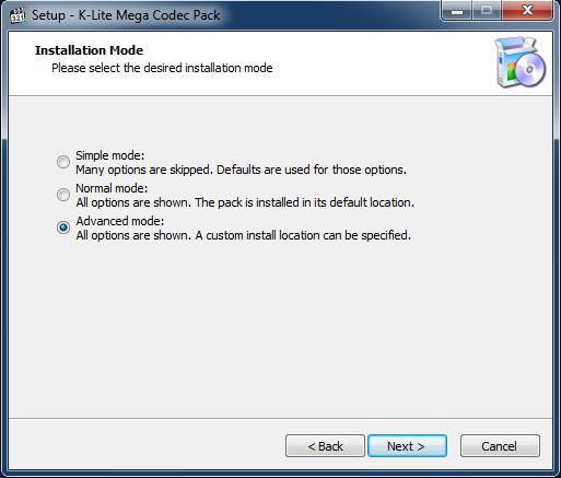

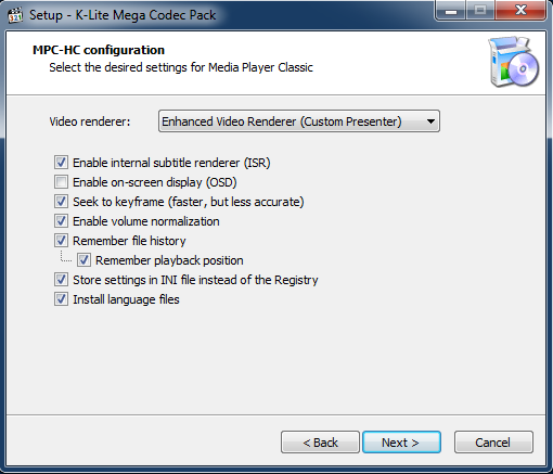

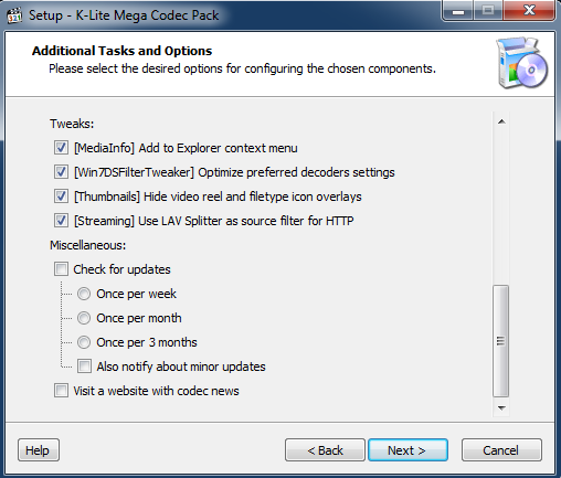

  25. I finally got it to work! I basically just uninstalled EVERYTHING, even the lagirth codec and went back and reinstalled k-lite and installed lagirth with K-lite and set all the codecs like was shown above and now Vegas reads my avi files! hurray! success!
