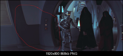

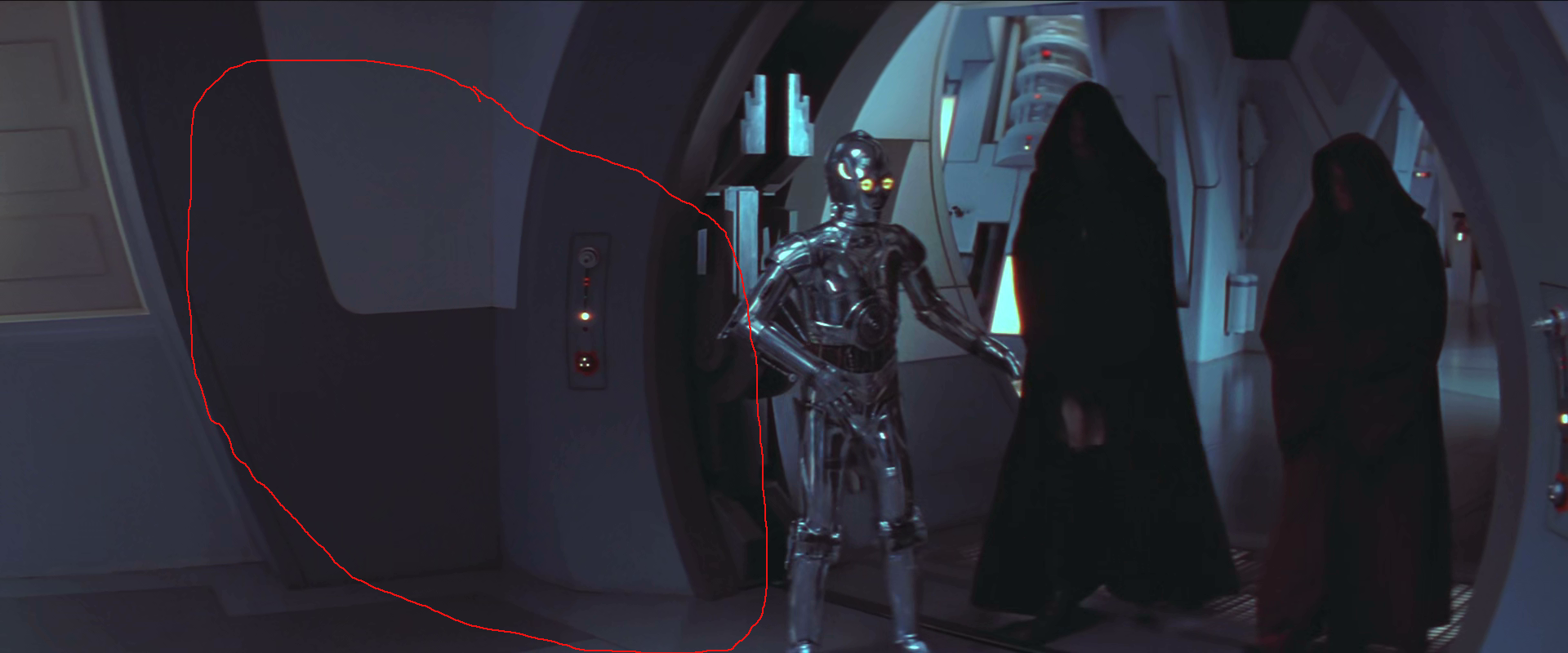

    I just made some test with x265, the result is amazing in 98-99% of the video, but in some scenes i see horrible banding, even if i double/triple the bitrate (1000kbps to 3000kbps, 1080p). There is no banding if i use x264. I tested x265 16bpp as well and not see the banding but the overall quality is much worse than 8bpp (and much slower the encoding of course). Any idea?
    Aug 2013
    Central Germany
    Please help us to help you: Exact x265 version, complete command line options, screenshot with highlighted issue, brief cut scene if possible (often the surrounding scene is more important than only one frame alone).
  3. I use latest mediacoder with x265 1.3.240
    x265 --preset faster --no-open-gop --keyint 250 --scenecut 40 --wpp --lft --sao --crf 25 --threads 8 - "$(DestFile)"
    2screenshots: at the first the left side too, i forgt to hightlight

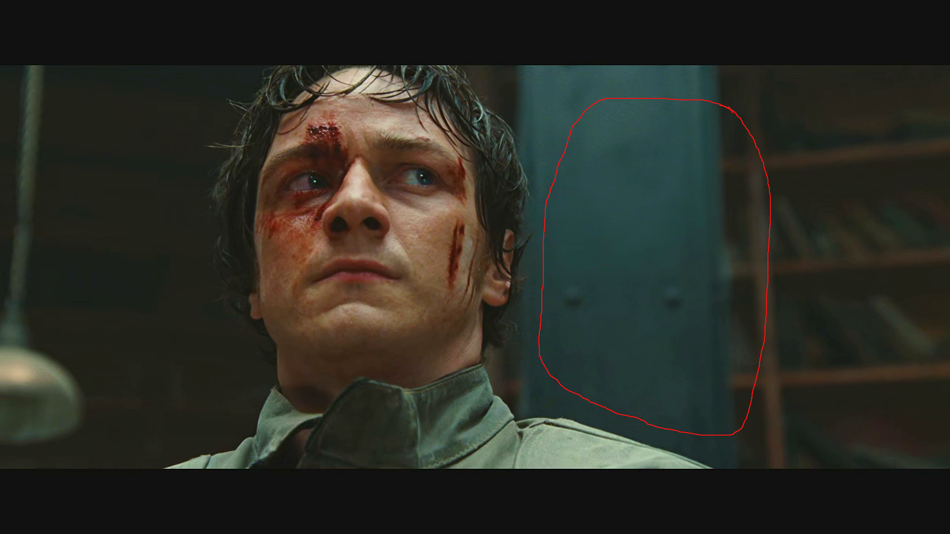

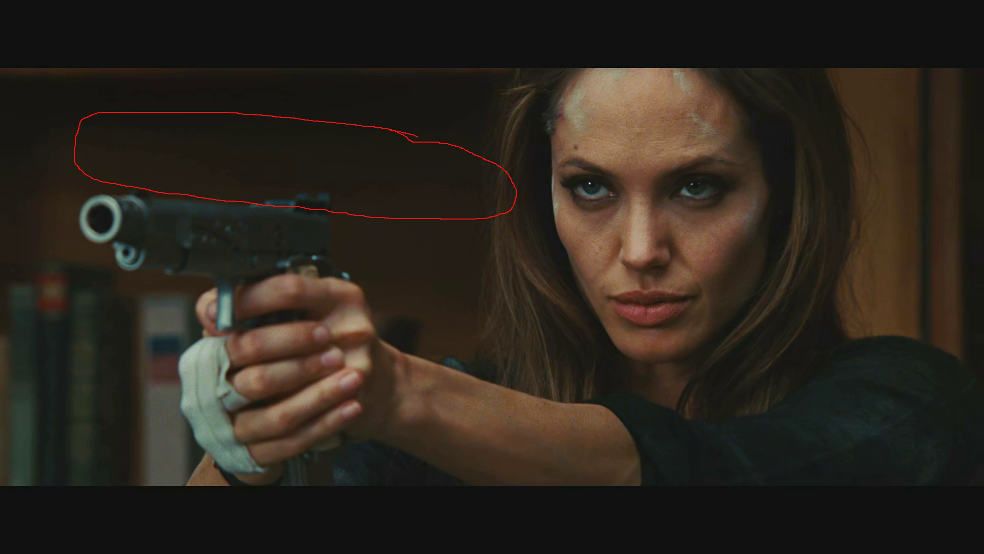

    Edit:another, cfr20, source BD50

    Unfortunately, single screenshots only ... so one can only guess. It may be important to know if a scene cut is close (but they seem to be mostly steady). If not, I would wonder about quantization pumping (different base quantizers between I/P/B frames, rate control fluctuations). A brief video cut would be more useful than screenshots only.
    Plus, I doubt that this is related to MinGW builds specifically. It may have been placed better in the generic x265 thread; can a moderator move this part?
  5. here is the sample including 1st 2 picture above.
    I can try cut the scene from SW1 if necessary
    EDIT: here is the SW scene, i quickly did it because this is a very representative/annoying example. Some of these scene makes the whole movie unwatchable

    OK, as far as I can see, this seems to be simply accumulated quality loss due to coarse quantization in combination with little de-redundancy efforts (fast preset). Too little bitrate to preserve enough quality, artefacts appear to develop after each scene cut. In scenes where a little (Pulfrich type) panning is present, you see the artefacts in the blurry background being dragged along with the sharp foreground edge, quite typical for a lack of better matching motion vectors (due to the brief search in fast presets).
    Disclaimer: The statement above is my personal opinion; other people may know better than me, though.
    __
    Watch the scene around second 28 in this cut. There is something bright and blurry in front of the actor's right shoulder. The first frame after the scene cut (certainly an I frame) is satisfyingly grainy. All following frames turn the grain to a pattern, like leather, and the right outer part which fades to black gets more blocky; but now and then, probably with a P frame, some detail returns.
    __
    Similar observation for the SW scene. Watch the reflection below the door while it closes. And watch the shadow in the lower left corner while the coat approaches. Such are signs of a "desperate" encoder which doesn't find any better reference, due to both a lack of efforts to search for a better match, and a lack of bitrate to intra-code what did not yet match anything good enough.

    SW1 already has a too hard quantization in the reflection below the closing round door.
    The other film is very grainy (hard to compress without Film Grain Modelling), and also quite hard quantized, which is rather obvious in the already mentioned 28th second (right after the "F.U." curse).
    For both, CRF 25 is probably a lot too coarse.
