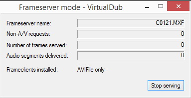

    I open virtualdub and load C00121.mxf (using the ffmpeg plugin)
    alwais in virtualdub, I do: "start frameserver" and save c:\cat.vdr
    frameserving active (I leave open that window)
    in avisynth I do:
    AviSource("c:\cat.vdr")
    all ok, but now I have to batch automate the procedure.
    I wonder: can I create with a batch automatically a .vdr file?
    and Overall: is there a way to don't keep virtualdub alwais in "frameserver" active mode? Or else: is there a way to use the .vdr files so that virtualdub
    is invoked only if necessary, by avisynth? because if I close the "frameserver mode" windows (after saved the cat.vdr file) ---> avisynth cannot load nothing
