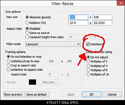

    I wonder: meanwhile virtualdub have a checkbox that you specify your is a interlaced source
    I cannot find this "option" in avisynth
    for example I do:
    Yadif(1,1)
    LanczosResize(720,576)
    AssumeTFF().SeparateFields().SelectEvery(4, 0, 3).Weave()
    but in wich way I can tell to avisynth that my source in interlaced so that it have to considering it when resize? thanks
    [Attachment 27629 - Click to enlarge]
    for example I do:
    Yadif(1,1)
    You don't. Avisynth doesn't recognize interlace flags, and neither does VirtualDub. You have to specify with both.

  3. I don't know why I'm use Lanczos: I notice that in virtualdub, using the lanczos and the checked "interlaced" box--> quality of resize is "good", but if I uncheck the "interlaced" option I see some artifacts in details of image
    Now I'm wondering if also avisynth have a similar option ... e.g. lanczosresize(720,576, interlaced=true) or something of that.
    However in avisynth I use the IResize function and is similar to the use of Lanczos+Interlaced (as shown above) of virtualdub.
    Is it a better way? thanks
