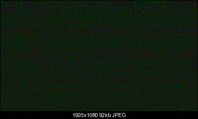

  3. I think that's normal CCD noise. Crank up the gain (in software) and you'll see flickering white spots all over the frame.
    Same here.
    Originally Posted by Stears555 View Post
    Important Notice, the video is a so called progressive segmented frame video (progressive material in interlaced format)
    MediaInfo says it's interlaced.
    Either way, same conclusion. White dots are everywhere.
    [Attachment 27622 - Click to enlarge]
    But my problem is the following: The white points appear and disappear always exactly on the same place. (after three frames later. ) Do you think that, If they are real dead pixel, they would appear constantly instead of flashing rhythmically some frames later?
  7. Originally Posted by Stears555 View Post
    Some do, some don't. Some pixels are noisier than others. The ones that are especially noisy flicker more.
