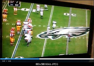

    Notice the scrolling ticker tape text is hard to read. This is how videos look when there's a quick movement. An example for a quick movement would be when a quarterback or soccer player makes a deep pass, this causes the video to be jittery and becomes a pain to watch.
    I tried to shoot the video when it becomes jittery but the ticker tape text sums up my problem. That same text looks perfectly fine on a Dell Inspiron 15R laptop. If that text is perfectly readable, my videos would be fine as well.

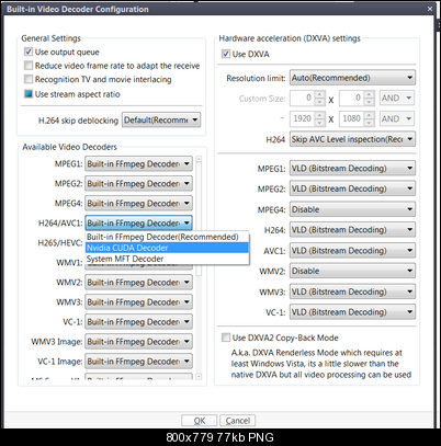

    Installed 1.6.49876 Beta

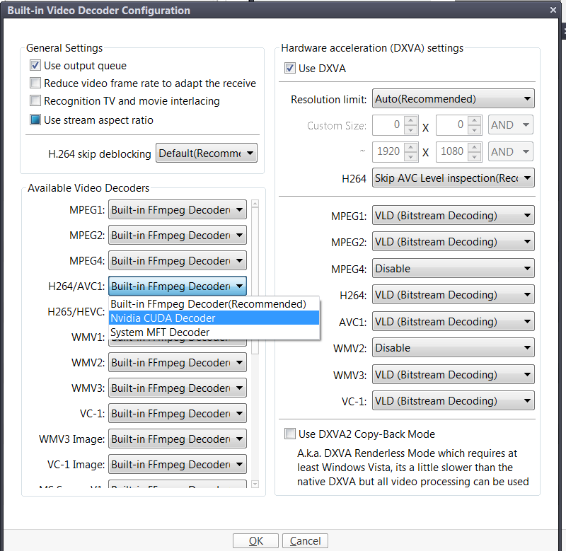

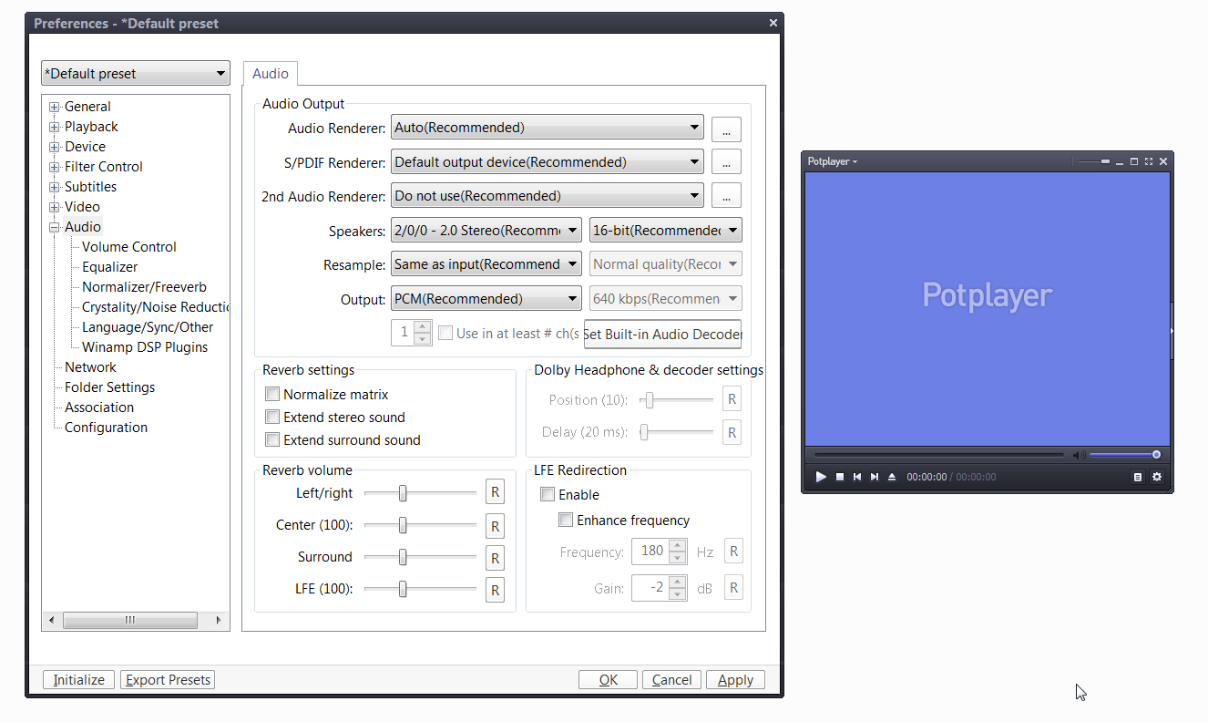

    I'm so sorry but I'm unable to find "Audio Processing" tab in the settings:
    [Attachment 27611 - Click to enlarge]
  5. Just press "initialize" button in your screenshot.
    I've just tried your video source. I guess it is your video hardware/driver problem.
    You can try updating video driver and reinstall directx runtime.

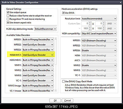

    Ah, do you have i7? then I recommend to use quicksync.

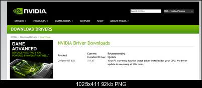

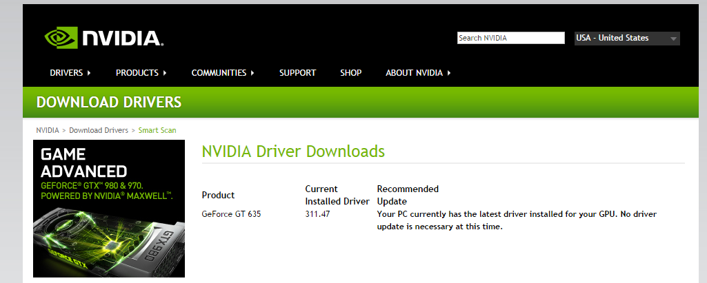

    Initialized and this is how it looks now:
    https://www.dropbox.com/s/zsw6npm7wbq1kh5/Sample%20on%20PP%201.6.49876%20Beta.mp4

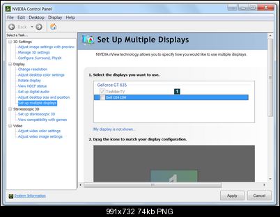

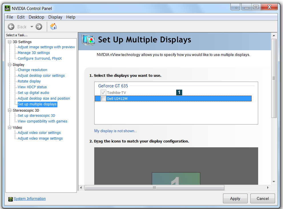

    Should I uninstall and reinstall Nvidia?:
Name:	ScreenHunter_78 Sep. 21 20.29.png

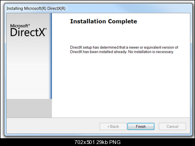

    And, I tried to install DirectX from http://www.microsoft.com/en-us/download/details.aspx?id=35
    but got this message instead when installing:
Name:	ScreenHunter_79 Sep. 21 20.32.png
    Could you please advise? Thanks again for your time..

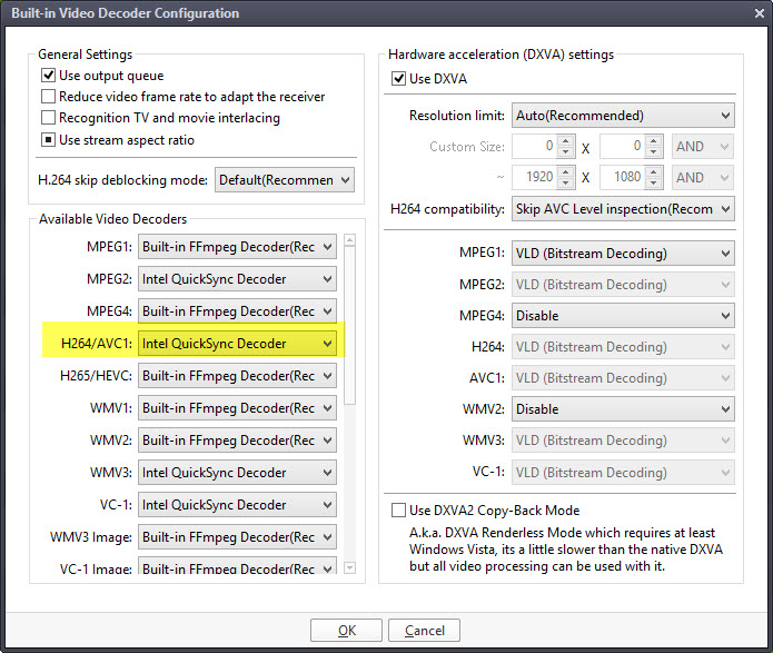

  7. Hmmm, I think your sysem just looks fine. What about enabling DxVA in the screenshot above?
    If you still have a problem with DxVA or quicksync enabled, the rest thing to consider is your display.
    If you have other display to connect, try it.

    I'm able to enable only DXVA.. No quicksync in the options. I wonder why!
Name:	ScreenHunter_80 Sep. 21 21.13.png
    This happens on both Dell UltraSharp U2412M monitor and Toshiba 46G300U 46-Inch 1080p 120 Hz LCD HDTV that are connected to the desktop. I tried enabling each of them separately but that doesn't help either
Name:	Dual Displays.png

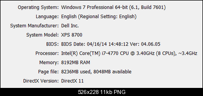

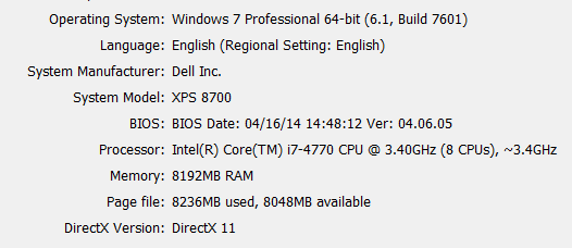

    CPU Info:

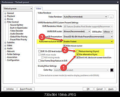

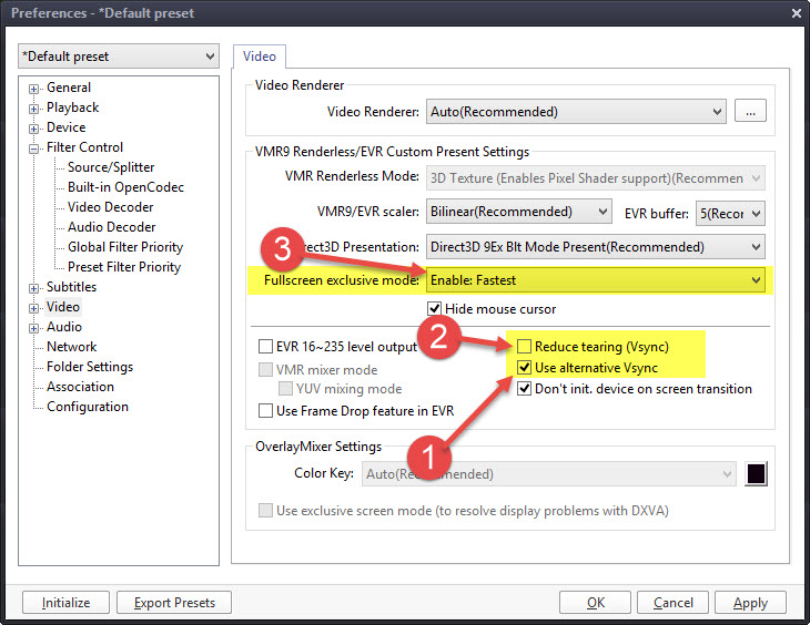

  11. That is what we called as tearing.
    Try the following steps.
    1. Confirm your tv is not 120hz mode. Generally, it should be 60Hz when connected to computer.
    2. Refer to the screenshot below: one of them can be helpful.
    - I've heard disabling "Use alternative Vsync" could solve the tearing.- Or you can try "Reduce tearing"
    - If both options do not work, try exclusive mode.

    Thanks again sheppaul.
    I looked thru' the manual and disabled the following feature: Clearframe (Please refer to attachment if it's indeed the one that's responsible for 120Hz). I had disabled "Stabilization" already.
    I went with "Fullscreen Exclusive Mode" not knowing that's the third option you recommended. It worked.. I'll play around with the other two shortly.
    Here's a sample video of the file that I watched after I made this setting.. I'd love to know how it looks on your computer during a kick-off, field goal etc. The crowd in the background kind of becomes fuzzy, right? I assume you watch NFL. I'm sorry if you don't.
    https://www.dropbox.com/s/2eyqi8zfu3bj8u2/Sample%20Video%20720p%20NYG%20vs%20HOU.mkv
    Thanks again for your assistance.. I greatly, greatly appreciate it.
    EDIT: I just disabled "Use alternative Vsync" and there's no tearing so far. And, disabled "Fullscreen exclusive mode".

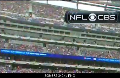

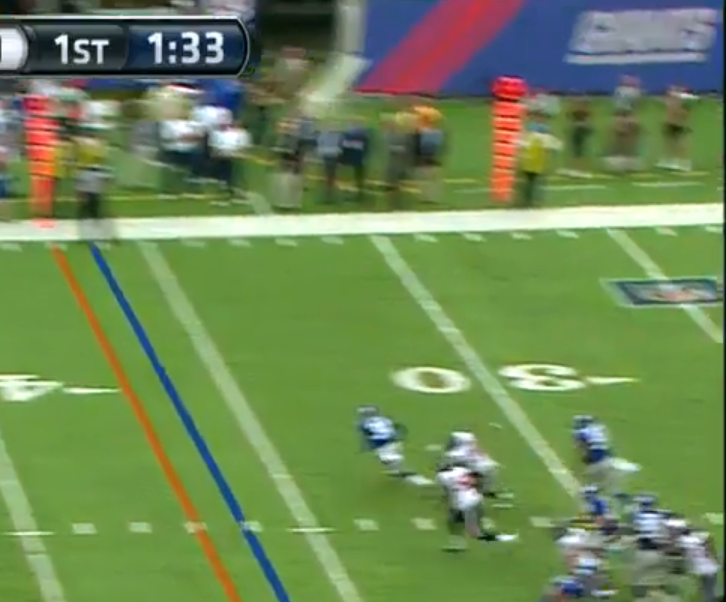

  13. Glad to hear that the tearing is gone.

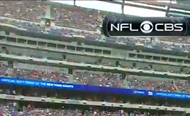

    Does your sample come from PVR recording? The crowd in the background is somewhat crushed here too.
    The overall bitrate of the sample is too low for watching sports in big screen.
    Increase it in PVR setting, if possible.

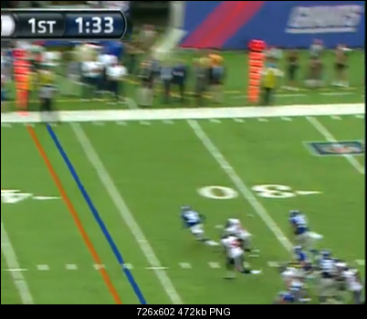

    How does the motion look on your computer:

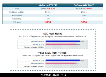

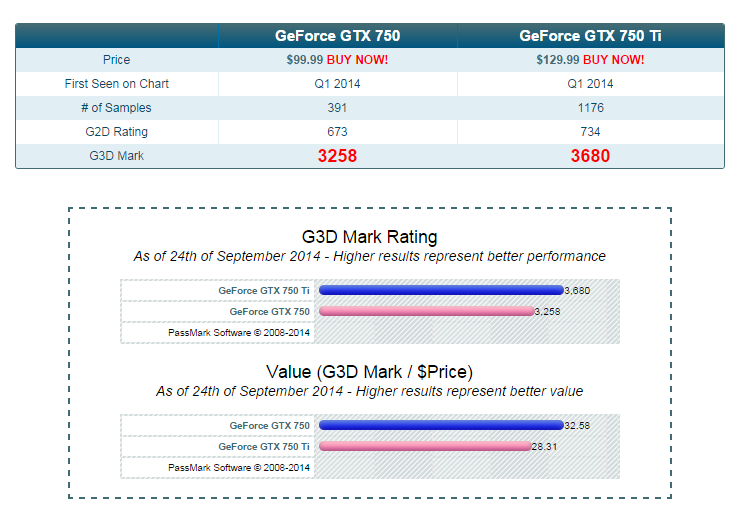

    I wish I was in control of the recording I downloaded this file.. The quality isn't that good indeed..
    I'm thinking of upgrading to either GTX 750 or GTX 750 Ti for the sole purpose of proper video playback.
    Compared to GTX 750, I take it that GTX 750 Ti isn't worth the extra $30 for my limited needs, right? Which one would you pick if it were you and you just need smooth playback, whenever possible:
    http://www.amazon.com/EVGA-GeForce-Dual-Link-Graphics-02G-P4-3751-KR/dp/B00IDG3PRI
    http://www.amazon.com/EVGA-Superclock-Dual-Link-Graphics-02G-P4-3753-KR/dp/B00IDG3IDO
    http://www.amazon.com/EVGA-GeForce-Dual-Link-Graphics-01G-P4-2751-KR/dp/B00IDG3NDY

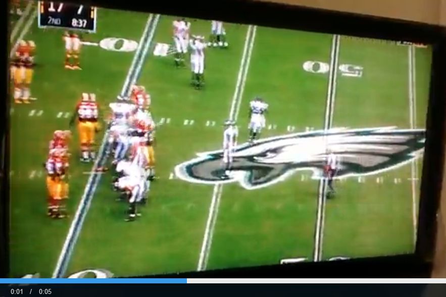

  15. HD4600 is more than enough for the purpose of proper video playback.
    BTW, this is not ok if you see multiple lines while the screen is panning. It's really weird.
    Connect your laptop to TV/monitor and try the sample.
    If you do not figure out the reason, buying another graphic card may not solve the problem as your system is powerful enough to play smoothly anything up to 4k video.
    ps. I'll try it in my HTPC environment tomorrow and let you know how it looks in my TV.

  16. I've just tried and no problem at all. I just wonder if you are really seeing the screen like the recorded video.
    Sep 2014
    Hmm, so you don't see the drag when the camera goes from the players to the referee? I just tried the source video on my monitor and it looks exactly like this video I recorded from the TV.. It drags
    https://www.dropbox.com/s/vvb797bimfxfz90/Is%20this%20ok.mp4
    From source:
    https://www.dropbox.com/s/9hrbkloyaf6etc8/Video%20from%20Source.mkv
  18. I can see such a drag too and the drag seems to be the problem of source video, not in your system.
    Didn't you say that the video is ok in your laptop? There is no drag in your laptop?
