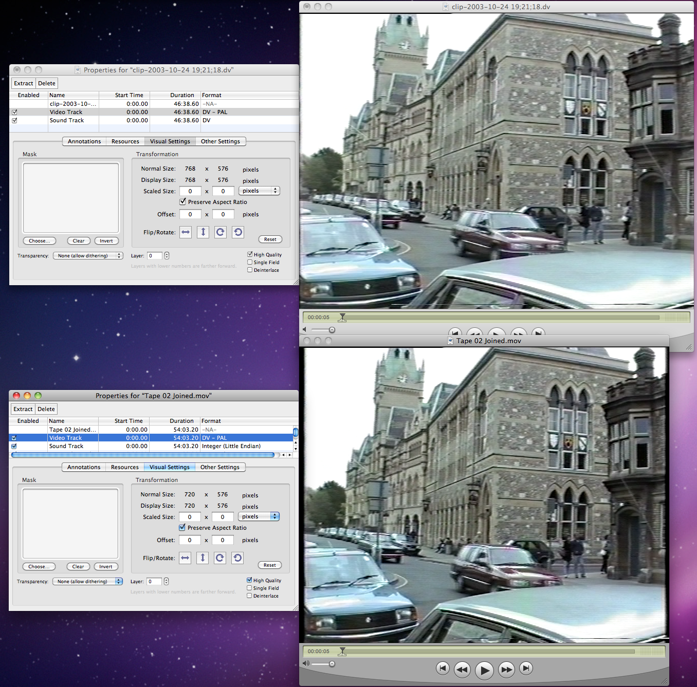

  1. I have captured my mini dv tape footage using iMovie11 and then joined the files in PremiereProCS5 and exported to .mov . I have attached a screenshot of the video settings of the original captured clip and the joined one and it seems that they have different scale sizes. Original is 768x576 and joined is 720x576. Can someone tell me what did go wrong and what should be the correct size so the ratio is ok and not squashed?
Name:	Joined Clips Issue.png
  2. Is the problem that i selected in Premiere the wrong aspect ratio? I should've selected one being 768x576px?

  4. I don't get much of what you say Scott, im sorry, its my ignorance!
    All i want to do, is to capture my mini dv tapes with an easy way. I found that iMovie11 is easy, no dropping frames or any other "glitches" (capture stopping randomly) i've encountered with Premiere.
    I connect the camera, open iMovie, capture, finishes, it just works. Dv files are produced and then i need to join them. I know a little of Premiere, i enter all the video parts, i join them placing them in the timeline, i export them to .mov and voila i get one big joined video. No FW800 problems what so ever!
    The only problem is that its a little different size from the captured DV video! This seemed strange, thats why i asked. Other than that i don't know much, i just don't want to have a cropped video. Is there a way to prevent this and how?
  5. 768x576 is the capture format size. Is there a way to retain this after joining the captured clips?

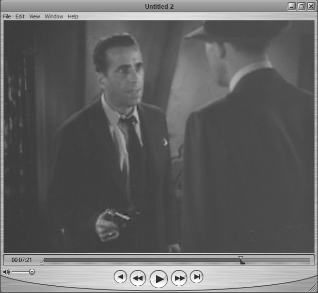

  6. Member Cornucopia's Avatar
    No, 768x576 is NOT the capture format size. Don't believe what it is telling you, because it is fudging the truth by "dumbing it down" for you.

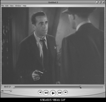

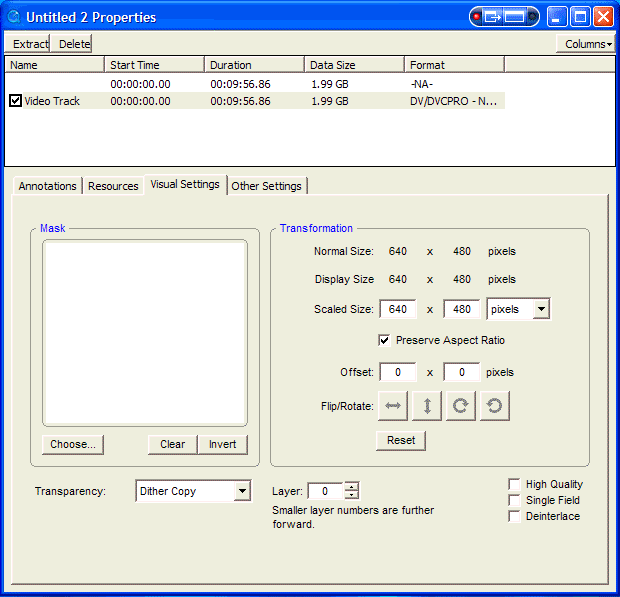

    Here is an example of a DV cap in Quicktime. Without previous editing/saves, it DEFAULTS to "clean aperture". That means, it presents itself AS IF it were the equivalent in square pixels - it's honoring the PAR & DAR (That's good). But it's NOT really encoded in square pixels...
    [CLEAN APERTURE]
    [CLEAN APERTURE VIDEO PROPERTIES]
    The file reports itself to you, and to all apps that rely on it, as 640x480. That's bad, because it isn't. Would have been so much more informative to just add a note saying "encoded pixels=...".

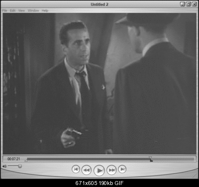

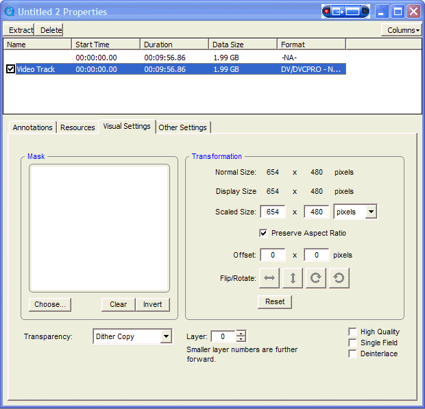

    Here's the Production Aperture. It is SUPPOSED to give you a slightly more accurate (less cropped) version, but it still tries to give you an equivalent 1:1 PAR without really telling you what magic it already performed to get there, so it only really goes half way to helping.
    [PRODUCTION APERTURE]
    [PRODUCTION APERTURE VIDEO PROPERTIES]

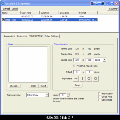

    The file reports itself as 654x480 - a size that almost NOBODY uses. The reasoning behind this was supposed to be that 640 was equivalent to 704 with a PAR of 10/11, and using the same ratio 720 would map to 654. What they forgot was that doing the mapping correctly (DV uses ITU/601, not MPEG sizing) means to crop 720->704 first, and then use the 10/11 to map to 640 instead of 654.

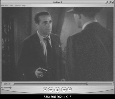

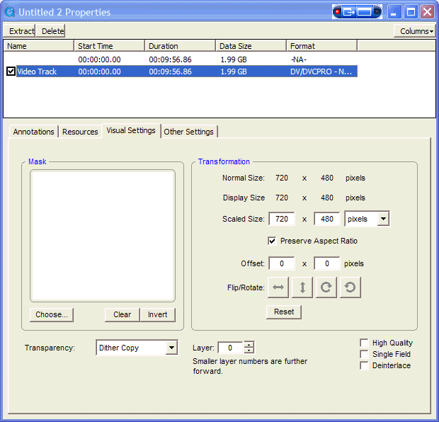

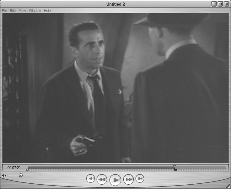

    Here's the "Encoded Pixels" aperture. It shows the actual pixels' size, BUT it doesn't honor the PAR, but show the pixels with an ASSUMED 1:1 PAR (wrong). In fact, there is NO function in Quicktime where it both honors the AR AND gives you the correct pixel size.
    [ENCODED PIXELS APERTURE]
    [ENCODED PIXELS APERTURE VIDEO PROPERTIES]
    The file reports itself as 720x480. This is the true resolution of the file. Funny that it says, " Preserve Aspect Ratio", but it isn't doing that here.
    Note: These 3 versions are all THE SAME FILE. It actually is 720x480, regardless of what Quicktime tells you. BTW, these are all NTSC versions, where the horizontal is squeezed to show the correct DAR. PAL stretches the horizontal when showing correct DAR.
    Note also that this points out another flaw of Quicktime: it defaults to NOT showing DV in "HighQuality"!
    You DON'T want to mess with the 720x480 size until the very end AND you intend to show it with a player that doesn't support non-square pixels. Then (if you must use square pixels), you encode to 768x576.
    Your assumptions are flawed because QT was giving you fudged/incomplete info.

    2) Are you aiming to join a 4:3 clip with a 16:9 clip, or will you be keeping the different aspect ratios separate?
    Well if im not mistaken, when i played the footage on my 42" LCD Philips TV i noticed that the 4:3 footage wouldn't cover the whole screen but there were black bars left and right. So i take it that the 16:9 footage would fill the whole screen perfectly.
    Not necessarily. The easiest thing to do is start a new Premiere project with the PAL 16:9 preset, capture a few random seconds of your 16:9 video, and see if it handles it correctly. You'll soon know if something's amiss.
  30. Originally Posted by zoranb View Post
    Not a chance. It's not 16:9. It's 4:3, widescreen 4:3. On your TV set you'll have black bars on all four sides.
