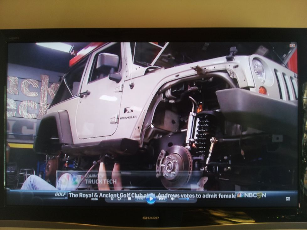

    This for all the people that want a definite answer on how to do it: I wanted to capture/record HD content off my HD Dish box at work onto my laptop. I was using a Diamond VC500 USB device but that limits the recording to NTSC and although there are quality and playback limitations I was able to record a full HD size screen and play it back to Zoom mode on my big screen TV but the quality wasn't very good and it hurt my eyes. FF to the Avermedia LGP Lite plugged into a Dish 211 HD receiver through a Sewell HDMI splitter. I've been reading that those splitters don't work anymore however search "HDMI 1x2 3D splitter v1.3 HDCP 2 ports swither 3 4 5 8 PS3 XBOX360 DVD Blu-ray" on Amazon and I hope you get lucky like myself and receive one that indeed strips the HDCP from the feed. 15 bucks Prime as of this date. For me it was success on the first try and I'm all set. Until this post I simply was not able to come up with a good answer and simple instructions. The info on Youtube is all over the place. Bottomline: YES IT WORKS.
    Avermedia LGP Lite using driver dated 2014-04-30 downloaded from Avermedia RECentral:v1.3.0.84 Driver:v3.7.x.22 and Stream Engine driver dated 2014-03-31 V1.3.0.3. I never messed with the Avermedia installation CD, I first installed these drivers and then plugged the unit in.
    Asus T100 - Avermedia LGP Lite- Sewell Splitter v1.3
    and for the nay-sayers: a picture of my big screen playing back the recorded HDCP content with Media Player
    *** update: the Sewell splitter power supply went out after only 1 night. The splitter is getting mixed reviews because "it stops working". It's the power supply, not the splitter. I found a comparable power supply and the splitter works fine again and HDCP gets stripped.
