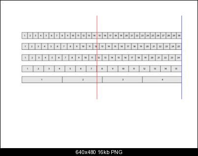

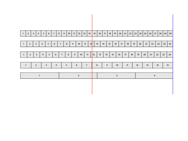

    First, however, I want to show you what I was referring to WRT VFR & multicam editing:
Name:	VFR edit problems.png
    This is an example of editing with multiple framerates. Note that these are all CFR (constant framerate), but all that means is that they are less complicated than VFR (variable framerate), which your originally-intended cellphone cameras (regularly) use.
    This is an edit timeline with 5 streams: 30fps, 25fps, 24fps, 15fps and 4fps. And cut lines in Red and Blue. The Blue shows a point at which you can cut to where all the frames' durations line up at the same point in time so you can cleanly cut/add and maintain sync. With these CFR frames (and when starting at the same instant), you will likely only get a good (blue) edit point once every second or so (depends greatly on the framerates chosen). Most other points in time will be of the Red (bad) variety. See how there is no common place that allows cutting at the exact frames' durations? What will happen with a red cut?
    Well, either
    1. Nothing can happen because the editor doesn't understand this and won't allow it. - BAD!
    2. You lose sync because the editor picks the nearest frame boundary point (earlier or later?). - BAD!
    3. You end up with funky high or low momentary instantaneous frame durations because the editor is creating new resulting/remaining frame durations. - Weird and probably BAD!
    4. The editor decides to pick a CFR rate that it will stick to and resamples/converts all the non-conforming frames to its rate so that it can do the task more straightforwardly. - quality-losing & bad (but maybe not as bad as the others)
    Those are the options. Not very good ones, any of them.
    Note also that even with CFR, and with Blue cuts, there will STILL be resulting framerate changes (so your edited clip is VFR itself), and the motion will have obvious moments of stuttering due to timebase jitter. Much like 24/30 pulldown but worse.
    With VFR recordings, the number of blue moment possibilities is reduced and red moments increased. Bet that would be fun.
    ...oh yeah, and this doesn't even take into account GOP-based editing with its own problems!
