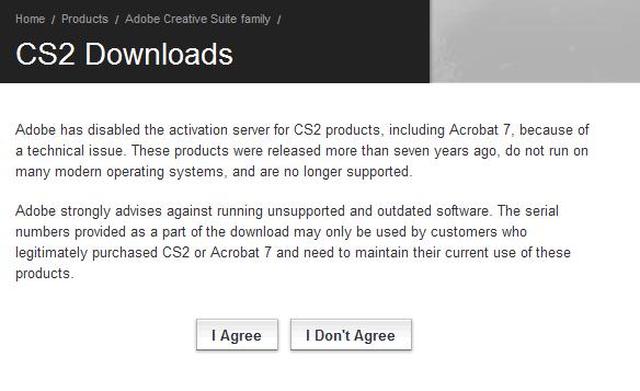

    Mar 2008
    The whole of CS2 is available from Adobe. They turned off the activation server, and provided a download link and serial number.
    They made the whole thing public (once you logon) but warn they didn't really intend for non-licensed users to acquire the software.
    The whole thing is a little weird.
    https://www.adobe.com/cfusion/entitlement/index.cfm?e=cs2_downloads#
