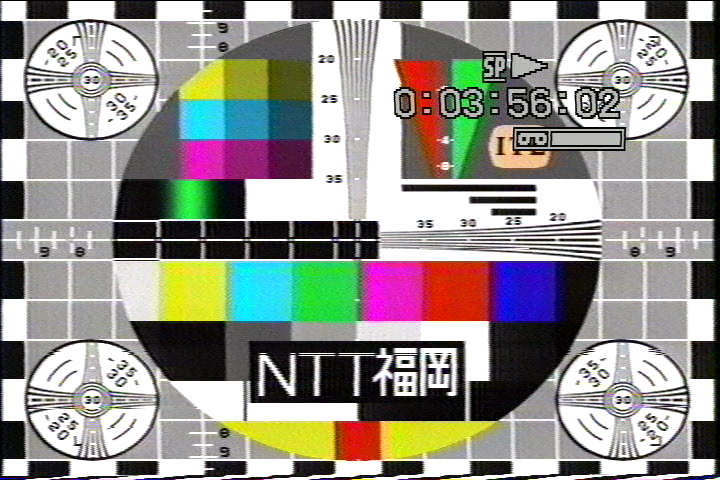

    Here you go. While searching for something else I found an old thread which links to a Japanese site that amazingly still has all its test images and video samples up. In case it does go down in the future, I've attached the three video samples showing 8mm tape playback.
    Canopus ADVC-300 (supposed TBC always on)

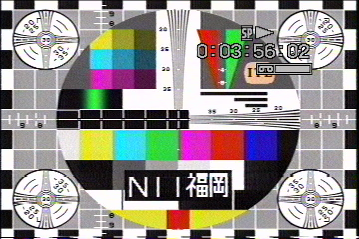

    Roland VMC-1 (TBC on)

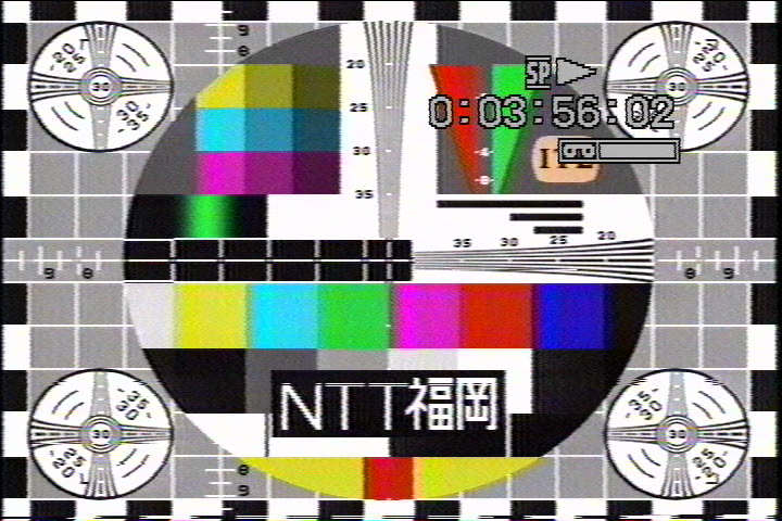

    Roland VMC-1 (TBC off)
    As you can see, lines are straightened in the middle image. But the dropouts are always in the same place (through the "NTT" text and bottom circles, most clearly).
    Both units contain the MN673744 chip, so I guess Canopus failed to use it appropriately. I don't buy the German reviewer's explanation that the chip was secretly found to be faulty and possibly fixed, unless there are complaints about their DVD recorders from the same time period. [EDIT: Reading further into his review, I see he actually mentions the VMC-1 and says it suffers from "similar symptoms." Confusing.]
