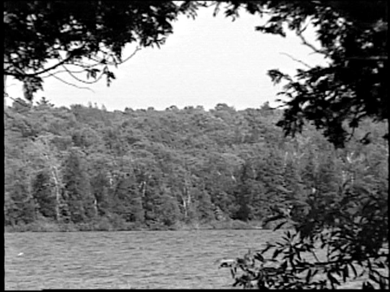

    I don't see horizontal time base errors, but I am shocked by how visible the DCT artifacts are.
    Aren't these just good old RF dropouts affecting whole lines?

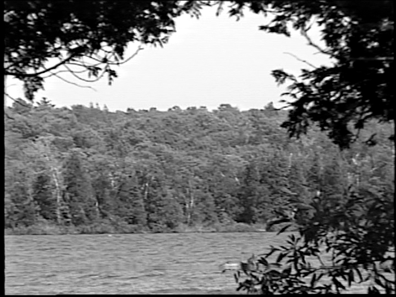

  20. Formerly 'vaporeon800' Brad's Avatar
    Apr 2001
    Vancouver, Canada
    And VHS is so noisy that a little DCT ringing noise won't be noticed.
    Buuuut look at the transition between the trees and sky! Does DV always have problems with a high-contrast change like that, is it the fault of Canopus?
    There are also horizontal lines in the sky that are basically stationary.
    Greyscale().LanczosResize(1280,960) to show it's not a color issue.
    Greyscale().Bob().LanczosResize(1280,960) on a later frame.
