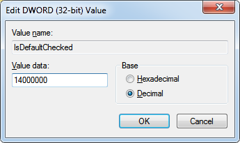

  16. Originally Posted by kkiller23 View Post
    I thought i would post it in here in case someone else was having issues. It would only allow me to put a hex number in, doing 14000000 wouldn't work
    You should be able to select the Decimal option in the dialog. Then you can enter decimal numbers.
