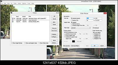

    I use virtualdub to downconvert a .mxf video file from 1440x1080 4:2:0 to an avi of 720x576 4:2:2
    al is ok but I see chroma ghost in the output avi file.
    Using virtualdub, the line
    ConvertToYUY2(interlaced=true)
    avoid the chroma ghost.
    But I don't know if is there a way to avoid the problem using virtualdub. Ca you help me cat?

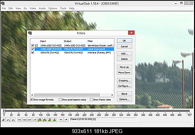

    By the way, you should enable "show image formats" in the filter dialog so you can see what colorspace each filter is using.

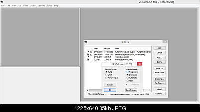

  5. in virtualdub I use the ffmpeg plugin 0.8.1.4 to open the .mxf 4:2:0 files (this is not my main camera [pdwf800], is the pdwf335 4:2:0 xdcam version)

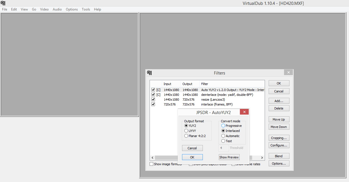

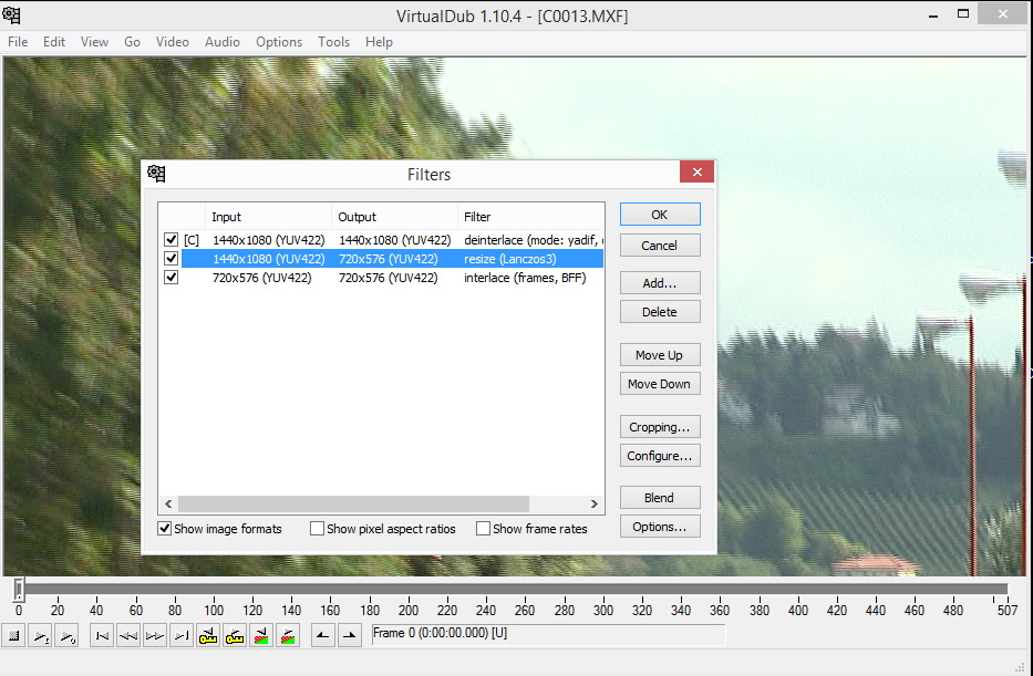

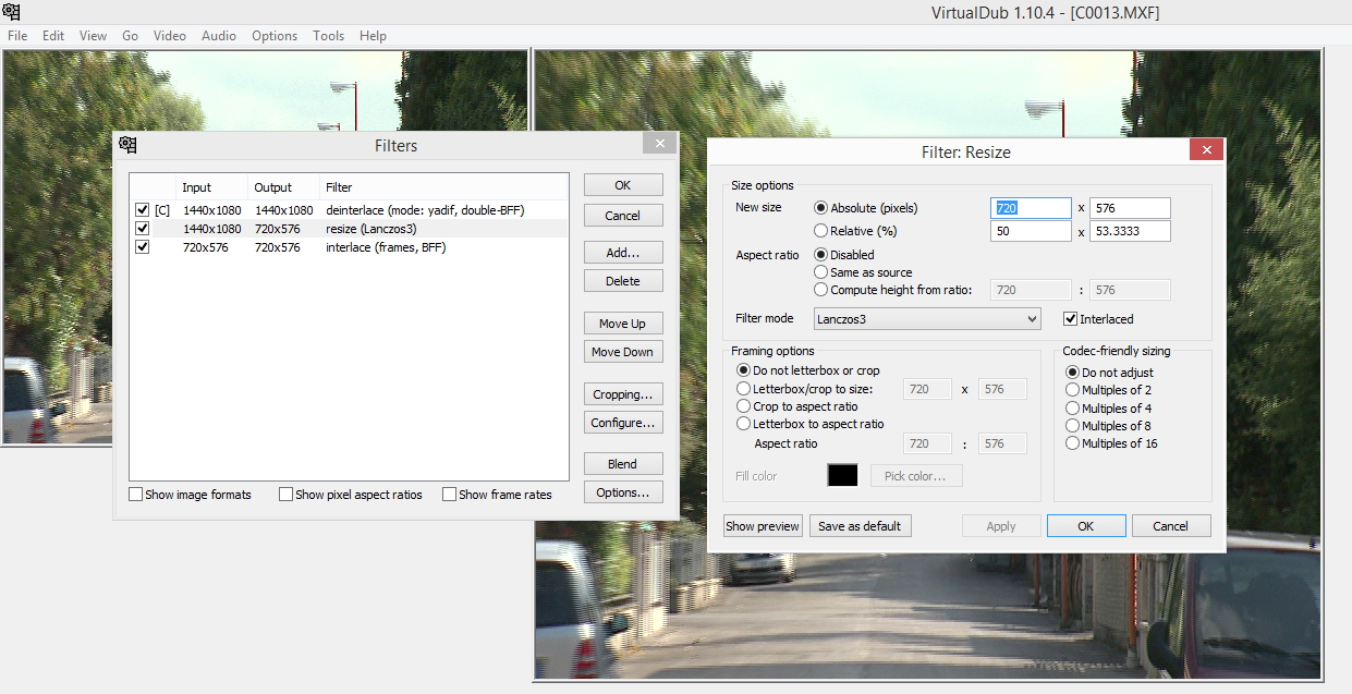

  16. solution found:
