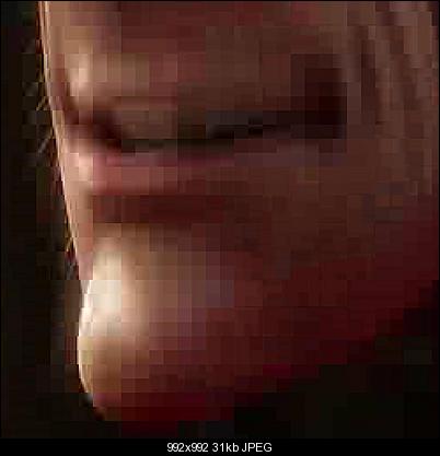

  5. Blocks from over compression (4x nearest neighbor resize):

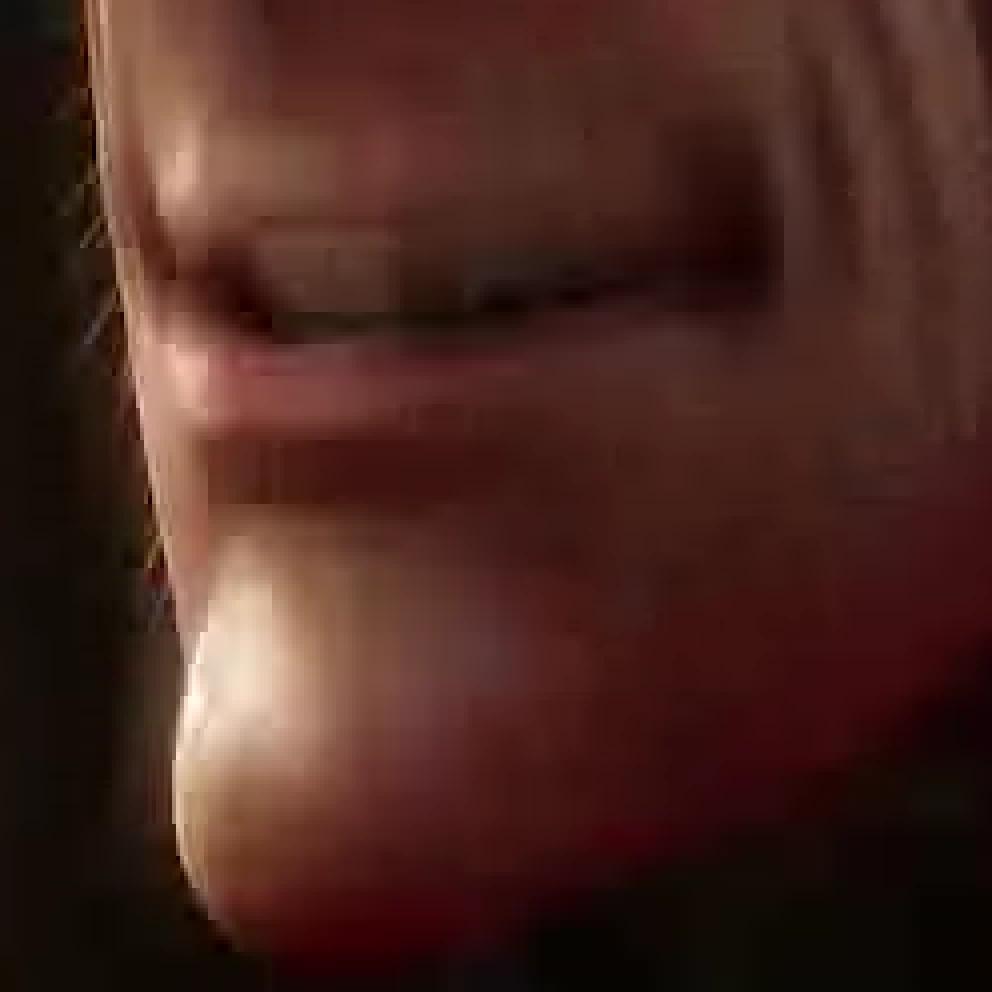

    Deblocked (4x nearest neighbor resize):
    Originally Posted by PrinceSwaraj View Post
    what value should I add in () ?
    It depends on your source, how much you compress, and what you want to see.
