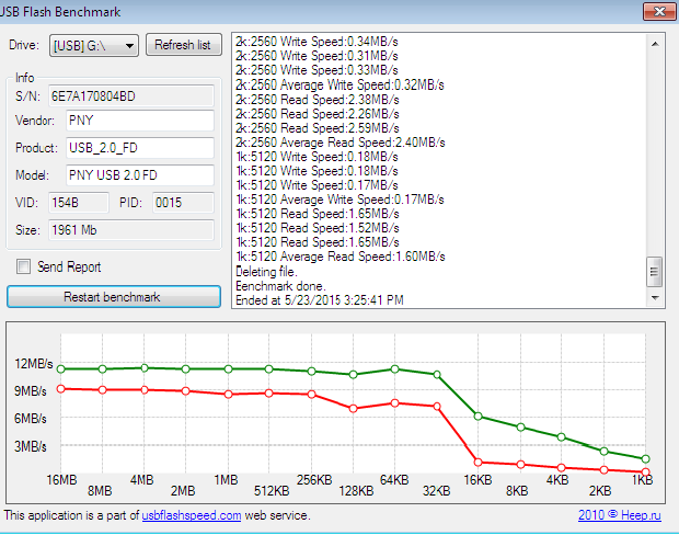

  8. i have a 2gb pny thats old & may not even power up anymore, but ill still try the pvr rocket with it. Thank you again SHS for your helpful information.

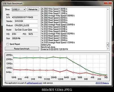

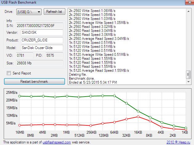

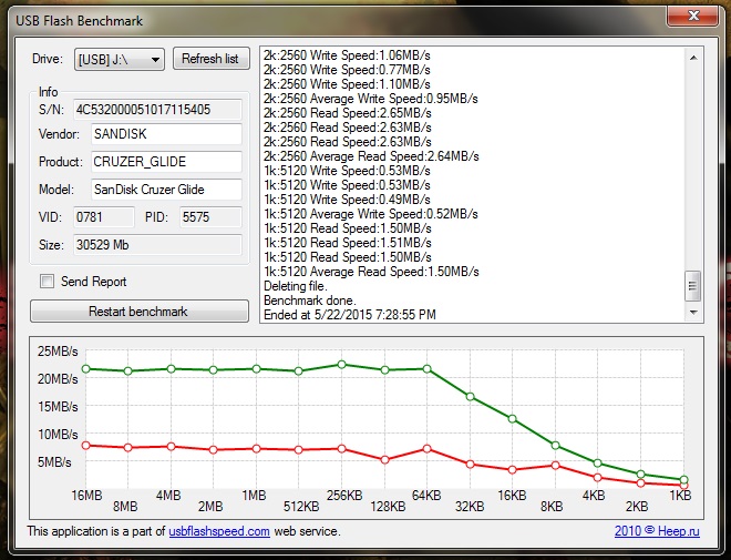

  9. to SHS : i got the same cruzers 32gb that you said you got but write speed is under 2 with the usbflash tool. i thought this tool would benchmark to speed it up to normal. How can i speed it up because any time it records it gets choppy and glitchy for a couple seconds throughout the whole recording. I tried my old 2gb pny and it doesnt get choppy at all & my third old flash drive was working fine & just after a couple weeks it records a non playable file & wont work even when formatting the drive.

    You see this anything above 64k it fine as write bigger cluster any way Click image for larger version

    Pleases post a screenshot of usb flash speed benchmark from both the 2GB and 32GB you have

Name:	flash bench.png
Name:	flash bench 2.png

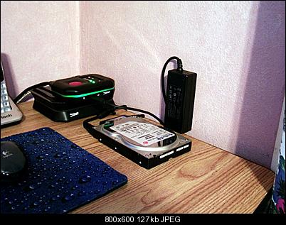

    The only thing I can think off is it your USB Stick as only other option is going with self power harddrive Click image for larger version
    Like this one.
    It may even be possible to use a External SSDs but I don't have nor own one so I have no idea if it will work.
