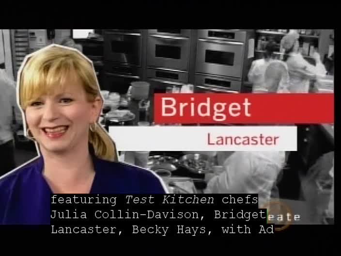

    Here's a snapshot from a video with rolling captions which I edited with MPEG-VCR.

    [Attachment 27441 - Click to enlarge]
    Awesome! Thanks very much, Usually_quiet!
    If indeed MPEG-VCR got that rip for you, then it might be exactly what I'm looking for now.

    Use VLC to play the file. Subtitle-> Sub track -> Closed captions 1.
  13. Once again, you're absolutely right, Usually_quiet!
    I see the rolling closed captioning. Excellent, exactly what I wanted.
