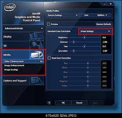

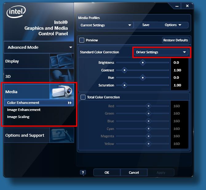

  8. Originally Posted by LouieChuckyMerry View Post
    By "graphic cards setup applet" do you mean the Intel Graphics and Media Control Panel (not the NVIDIA Control Panel)?
    Whichever one controls the graphics device you are using. You kept talking about Nvidia control panel so I gave you Nvidia's nomenclature. With Intel's applet all the controls are on the Media tab.
    In the Intel Graphics and Media Control Panel I killed all the enhancements I could find and set everything to "Application Settings" where possible, and now the brightness control works in MPC-HC . As I poked through these settings I realized that I'd been there months ago when first trying to solve the screen tearing on my then new laptop, but I hadn't been back since. It' great (thanks for that) that I can now use MPC-HC with EVR and brightness control. Of course, between the GUI's of MPC-HC, VLC, and SMP, MPC-HC would be my last choice
    That's why I told you to turn off application control and use the applet's setting. Then the settings will work for most players (depending on how they're set up). Unfortunately, VLC isn't one of them.

    That's the GUI I have, but I don't understand your statement "That's why I told you to turn off application control and use the applet's setting. Then the settings will work for most players (depending on how they're set up)." I found that enabling "Application Settings", at least for MPC-HC, was more functional (I wish that this was true for VLC).

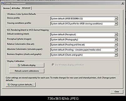

    Now I'm confused again. Both clips (.avi & .mpg) playback looking pretty much the same (no black-blacks, no white-whites), so why would I adjust my desktop processing amp to see the full range of RGB? Apologies for my ignorance, and is this where I'd head:

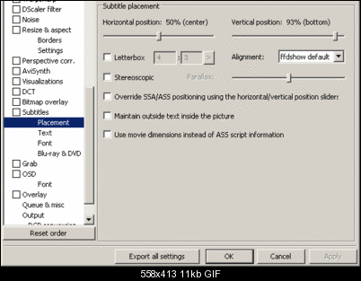

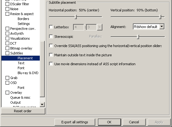

    My only real laments with MPC-HC's are the inability to customize the size-location of the toolbar and its limited hotkey functionality with regards to subtitle resizing and positioning (a very convenient option for foreign films of various resolutions).
    I rarely use subtitles so I can't help much there, but both ffdshow's video decoder and ffdshow's DXVA video decoder have quite configurable subtitle filters. You could even add ffdshow as an external filter in MPC-HC's options rather than rely on the DirectShow system. Both ffdshow decoders allow you to save their configurations (including the various filter settings) as a preset. You can switch between presets with a click or two of the mouse.

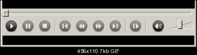

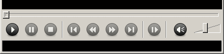

    MPC-HC's toolbar buttons can be customised with "skins". I find using the toolbar to navigate with a mouse from the other side of the room not to be quite ideal, but you can at least make it a bit bigger. Customising it in respect to adding removing items isn't something I've ever worried about too much as you can access most things via a right click and there's lots of options for setting keyboard shortcuts.
    I went from this
    to this
    which admittedly is probably about as exciting as it gets, but there's skins with different buttons.

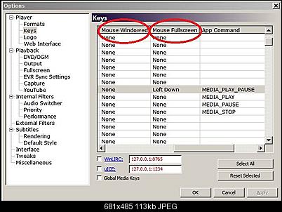

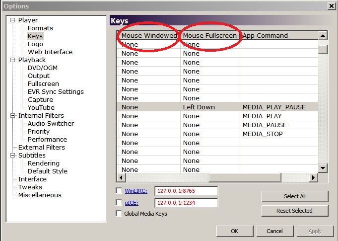

  22. Originally Posted by hello_hello View Post
    I tried MPC-BE a few times and it seems quite good. The dealbreaker for me has always been the behaviour when you left click on the video to pause it. Every player should allow you to pause and resume playback by simply clicking on the video, and when I'm ruler of the world it'll be compulsary, but anyway.... MPC-BE has that functionality but it's not reliable. Sometimes it just sits there ignoring click after click, sometimes it's fine, I'm not sure why..... I think it relates to the ability to also click on the video and drag the player to a different position on the monitor and MPC-BE doesn't know whether you're clicking to pause or clicking to drag..... or something..... but it really frustrates me.
    When I'm Ruler Of The Known Universe I'll appoint you Ruler Of The World and you can have at it . I'm not sure how long it's been since last you checked out MPC-BE, but the shortcuts are now highly customizable and perhaps more stable.
  23. Yeah..... the key shortcut options are pretty much the same as for MPC-HC. I conversed a little in the MPC-HC thread at doom9 and it turns out the mouse clicking behaviour was changed for the latest version even though it wasn't mentioned in the changelog.
    It turns out the "left down" click setting for pause/resume works as it always has, but "left up" also allows you to click on the video and drag the player around the display etc. That's the "don't always know what you're doing" mode where some left clicks to pause/resume are ignored because MPC-HC thinks you're dragging. Switching to "left down" solved the problem.
    If you never left click on a video to pause/resume playback it won't bother you, but I do it all the time and find MPC-BE quite frustrating because it ignores mouse click after mouse click. I reported the problem in the MPC-BE thread at doom9 a long time ago and I'm pretty sure others have complained but the developer doesn't seem bothered about it. I don't particularly want to change the pause/resume option to something else so I don't use MPC-BE.
    Potplayer lets you set a left click to pause/resume playback and it works fine when you do, although I've always liked the way Potplayer displays the default mouse settings in it's options as "default operation", which doesn't offer the slightest clue as to what a particular mouse action does, but maybe that'd take the fun out of it.....
