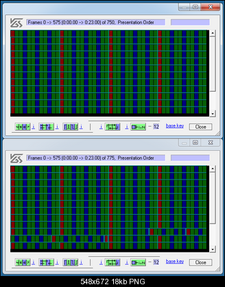

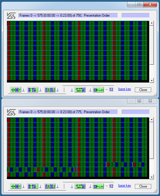

    I agree. They're miscalculating the bitrate to use for the cut GOPs (maybe because it ends up with two I frames in a row?). Here is a GSPot map of the GOP structure. You can see the regular pattern of the source file on top, the reencoded sections on the bottom.

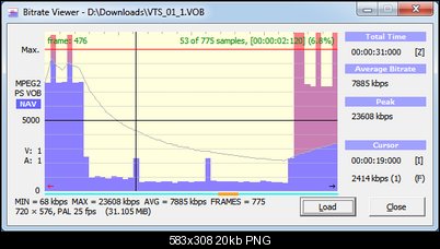

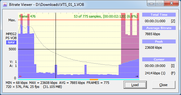

    If you zoom in to the bitrate map with Bitrate Viewer in frame mode you can see that even the I frames of the reencoded GOPs are tiny:
