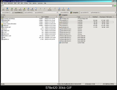

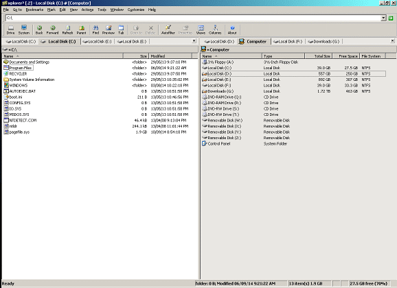

  13. If I read a thread where someone's commented on a Windows Explorer annoyance, I try to recommend using xplorer2 instead. Once you have, you'll never go back......
    Imagine two instances of Windows Explorer running side by side (for easy copying and pasting etc). Then give each instance of Windows Explorer tabs like a browser. That's how I run xplorer2. But you can run it like the traditional Windows Explorer view if you want to. Once you set it up you can save the configuration so it opens the same way each time.
    Even the free version is fairly configurable. Each tab can be configured individually. Different columns, details view for one tab, thumbnail view for another. I'm so used to navigating with xplorer2, I find going back to Windows Explorer quite frustrating. Just the little things, like being able to double click on an empty space in one of the panes to navigate up one folder level.
    Xplorer2 does display file sizes differently to Windows Explorer. You can choose to display them as bytes, or it'll use kB, Mb or GB as appropriate. It doesn't always round as much. Xplorer2 might display 426.1kB as a file size. Windows Explorer would display 427kB.
