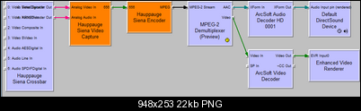

    Hopefully an easy one, but one I just can't work out! When I'm using Graph Studio in conjunction with my HD PVR2, I need to use the MPEG 2 Demultiplexer to go into my video and audio decoders. This is a typical graph I would want for displaying the output from the HD PVR2

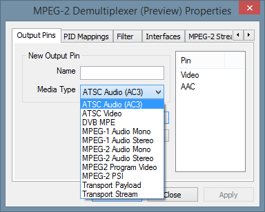

    The problem is, my Media Type box on the demultiplexer is very limited, and doesn't allow me to choose h264 as a media type for my Video pin:
    The result is I can't get any usable video out of it

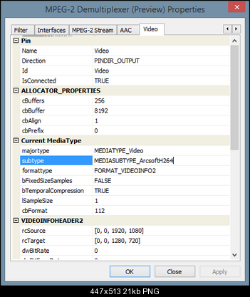

    Now I can work around this by capturing the graph from the Hauppauge software and 'stealing' the demultiplexer, which then has the correct media type settings, as shown below:
    My question is - how can I get to this stage myself using just Graphstudio? How can I change the media type of the pin to the correct media type and make things work?
