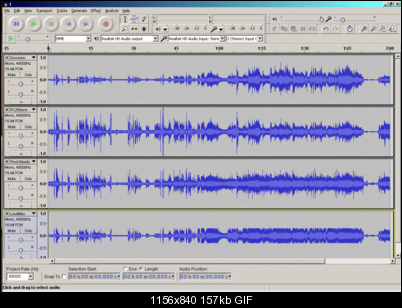

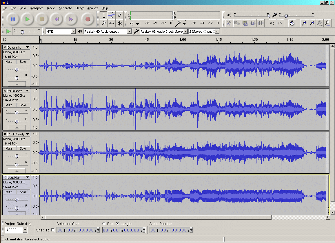

  4. I agree. The R128Norm version is definitely louder during the first part, but that's using my settings for the RockSteady version. There's no reason why you couldn't crank it's amplification up a bit. Looking at the waveform, it's seems the first gunshot is definitely louder in the R128Norm version (compared to the original).
    A lot of the difference may come down to the size of the window used to determine the volume. If the two DSPs use different size windows then I assume during sections where the volume changes very quickly and continuously, each DSP will interpret the average volume differently. Visually, it appears RockSteady is compressing more. The R128Norm waveform looks closer to the original. Whether that's good or bad depends on the result you prefer, I guess.....
    I didn't even know there was a VST wrapper for foobar2000, but your previous post encouraged me to look. I found this one which appears to work well. Is that what you use? And while I'm asking...... now I know you can run VST plugins with foobar2000, do you have any recommendations?
    Anyway.... I'm not sure about the LoudMax DSP yet. I tried the VST version. It definitely works, and it definitely sounds okay.... I'll need to play around some more to decide if it's compression works well for video/soundtrack audio. For the moment, there's a sample attached. The LoudMax threshold was set to -15dB, the output to -1dB, then I ran ReplayGain on the output file and converted it to AAC. As you can see from the waveform, it definitely compresses (I split each sample to mono and removed the right channel for the the screenshot). The first section sounds quieter than RockSteady, while the second sounds pretty similar.
    These are the original waveforms, not a null-test.
