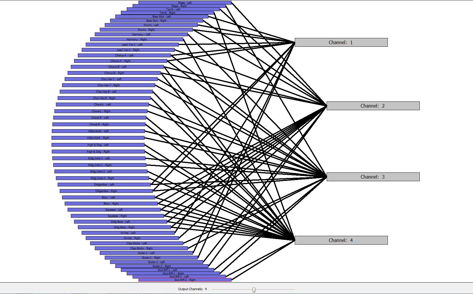

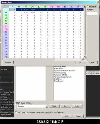

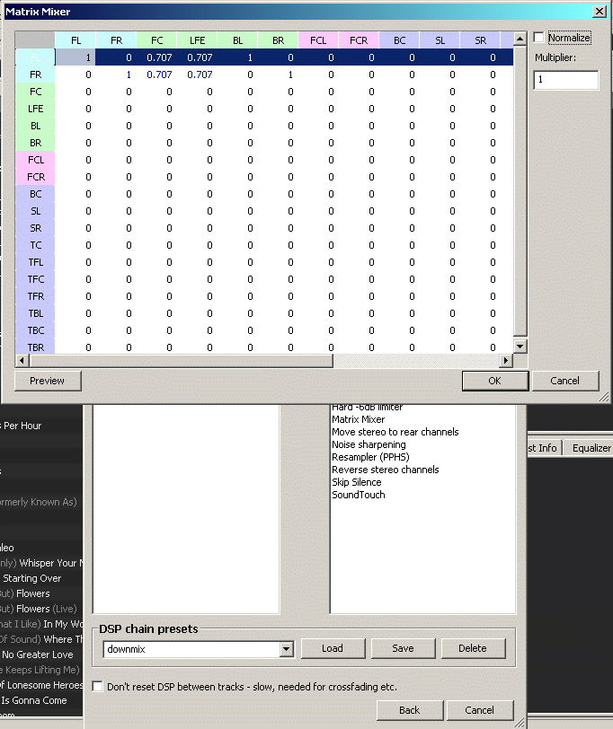

    I don't suppose you use foobar2000 do you? Because I discovered this today, which actually annoyed me a little as I had no idea it existed. Foobar2000 contains a downmix DSP but it's set. You can't see or change what it's doing. This third party DSP is fully configurable. In the past I've being doing non-standard downmixing (re-mapping channels, changing their volumes etc) by decoding via directshow and using ffdshow's mixer filter. It works fine, but I could have achieved the same thing without as much messing around. Anyway.....
    The foobar2000 Matrix Mixer DSP can be found here: http://skipyrich.com/wiki/Foobar2000:Matrix_Mixer
    If you're not familiar with foobar2000, you can add DSPs to the playback chain, configure the configurable ones, and save your DSP setup as a preset. Foobar2000's converter can also load the same DSPs and the same DSP presets. It's converter can also save conversion setups as converter presets.
    The upshot of all that is.... currently you're importing 5.1ch audio into Audacity, doing whatever you're doing to the channels levels, exporting that as a stereo file, then maybe, converting that to anther format.
    Alternatively you could load an AC3 audio file into foobar2000, right click, select an appropriate conversion preset, and the 5.1ch audio will be downmixed to stereo using your pre-configured mixer matrix as it's being converted. Much, much faster. Here's what the foobar2000 Matrix Mixer looks like when you configure it. I just applied a quick "standard downmix" configuration for testing. It works as advertised.
    The "normalise" checkbox seems to reduce the downmixed audio by a preset amount. I guess to prevent the clipping I've been harping on about. I haven't worked out exactly how much it reduces yet. Or you can set your own multiplier which I assume also adjusts the volume of the downmixed audio by a preset amount.
    Edit: And after a little more playing around and Googling, I came across this. Another DSP I might have used on occasion had I know it existed: Winamp DSP Bridge
    So it turns out the Winamp DSP plugin allows foobar2000 to use Winamp DSPs, and the RockSteady plugin I use for compression on playback happens to be a WinAmp DSP. It didn't take me long to configure another foobar2000 conversion preset to include the Matrix Mixer, followed by the Winamp DSP Bridge running RockSteady, and to save that as a new conversion preset.
    Now I can load 5.1ch audio into foobar2000, right click, select convert, choose the appropriate preset, and the 5.1ch audio is downmixed to stereo using the Matrix I specified, compressed by RockSteady, and re-encoded in a single step.
    It's pretty fast, even using this old PC. A one hour, 5.1ch AC3 file can be downmixed to stereo, compressed and converted to FLAC in about a minute and a half.

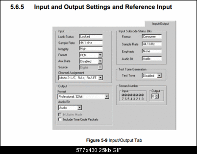

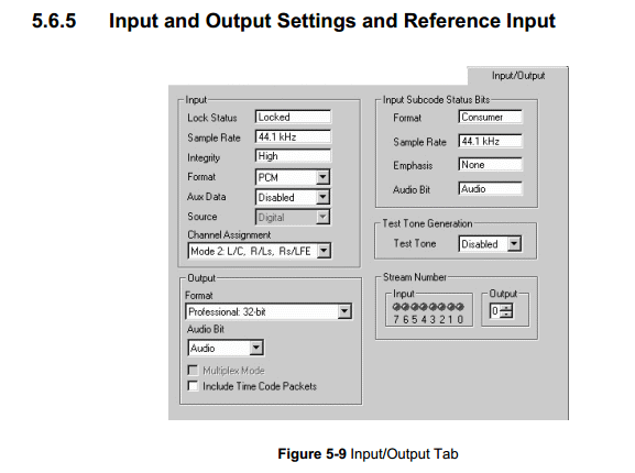

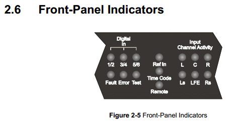

    Anyway, the "Dolby DP-569 Multichannel Dolby Digital Encoder" was mentioned, so I found a copy of the manual for it. There's inclusionary channel assignments everywhere. Even on the front panel it seems.
    And I'm not quite getting my head around why you'd set inclusionary channel assignments in the input/output configuration, but maybe I'm not understand the channel assignment function.
    It appears the channel assignments can be changed, and it'd appear the ABC requires SMPTE 320M assignments, unless track assignments are specified, when they still do, or they don't, or however that works, but I'm still not seeing anything which shows the channel mapping in the AC3 audio I extracted from the vob files on my DVD is going to be the same.

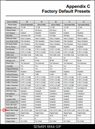

  4. Is the default input track assignment listed here the default order, or is it just inclusionary?

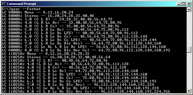

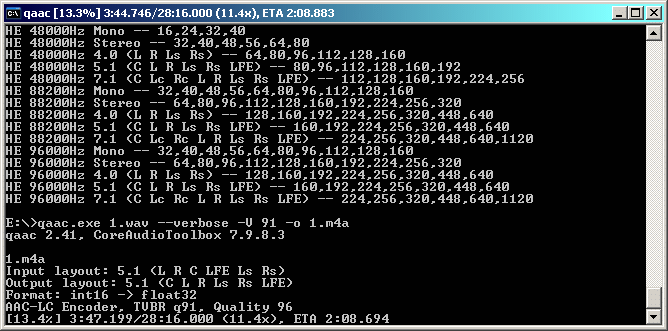

  7. I did some conversing with QAAC via the commandline. Here's QAAC's opinion on the AAC channel layout.
    Then I took a standard 5.1ch AC3 file and re-encoded it as a multi channel wave file using foobar2000, and when it was done I asked QAAC to convert the wave file to AAC for me.
    QAAC shows the input channel layout as being the standard 5.1ch WAV layout as expected. It also shows the output layout as being the same as the AAC 5.1ch layout I linked to originally. http://avisynth.nl/index.php/GetChannel
    It seems the AAC output channel layout is not the standard WAV 5.1ch layout, it's the mpeg channel layout mentioned previously. The same layout used by DTS, apparently.

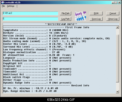

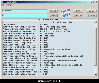

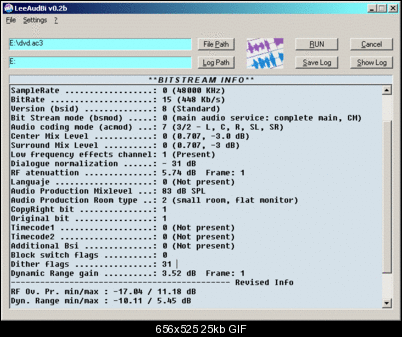

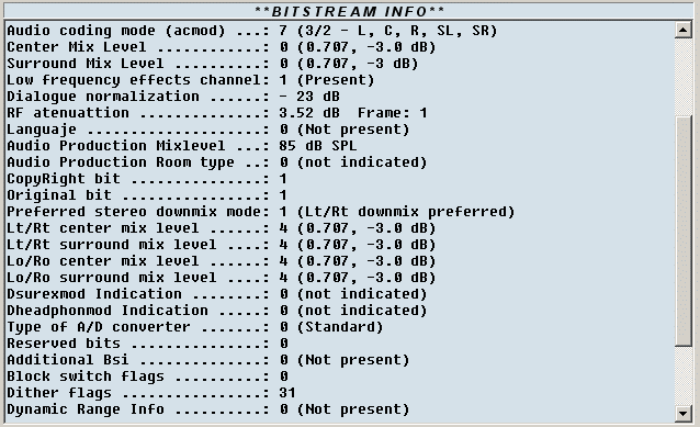

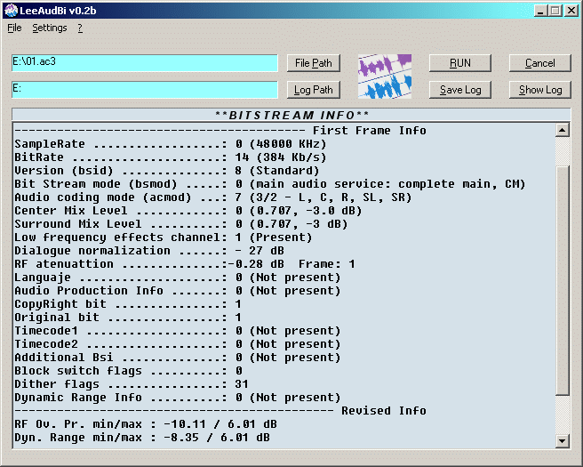

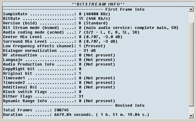

    How's this for a co-incidence? I was looking for something fairly unrelated today and stumbled across this program.
Name:	ac3 info 1.gif
    As you can imagine my eyes initially did a Terminator-like scan looking for the channel assignment order (guess I need to research audio encode mode 7), but the dialogue normalisation stuff is there. This could be completely wrong, so take it with a grain of salt, but I think the standard dialogue normalisation level is -31dB, which means a player should decrease the volume of the AC3 audio above by 4dB, but as I said, that could be a load of crap. It's just the way I remember it. In an earlier post, Cornucopia linked to a pdf for Dolby encoding guidelines which probably explains how it works.
    Here's some DVD AC3 audio:
Name:	ac3 info 2.gif
    The RF atenuattion value, I don't quite understand. Pandy mentioned it earlier. Maybe he'll pop back to explain. Likewise I don't really understand the "RF Ov. Pr. min/max" or "Dyn. Range min/max" it displays. If you go through the Dolby pdf and work it out.....

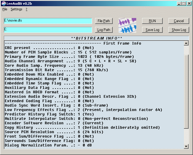

    When you put the program into "tell me lots of stuff" mode, it offers lots of info for each frame I don't understand..... yet..... I'll probably end up researching it more myself now.

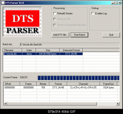

    Unfortunately it isn't all that informative when it comes to AAC. It does however provide more information for DTS, I discovered after extracting some from a movie and then performing a Terminator-like scan of the results for the DTS channel assignments, which appear to be the same channel assignments listed on the Avisynth page I linked to originally. I'll have to research "audio channel arrangement 9" just to be sure. I don't want to practice my "I was right" dance for Cornucopia prematurely as there's an "I told you so" move in the middle with a fair degree of difficulty.

  11. I assumed the centre and surround mix levels for the AC3 audio shown in my previous post were for stereo downmixing. It appears though, they're the levels for decoding the audio as 5.1ch surround. The stereo downmix levels are something else, assuming they're included. In this case they happen to be the same as the 5.1ch levels, which I don't quite understand, but anyway.....
    [Attachment 27432 - Click to enlarge]
    After converting some DTS to AC3 with AFTEN, the centre and surround levels are still set to -3dB. That must be the default for AC3. It must be to do with the way the surround system is expected to be calibrated, or something.....
    I assume I remembered correctly when I said -31dB is the target dialogue normalisation level, so AFTEN would have set the level to -31dB and therefore the player won't adjust the level any further. I'm pretty sure that's how it works.
    [Attachment 27433 - Click to enlarge]

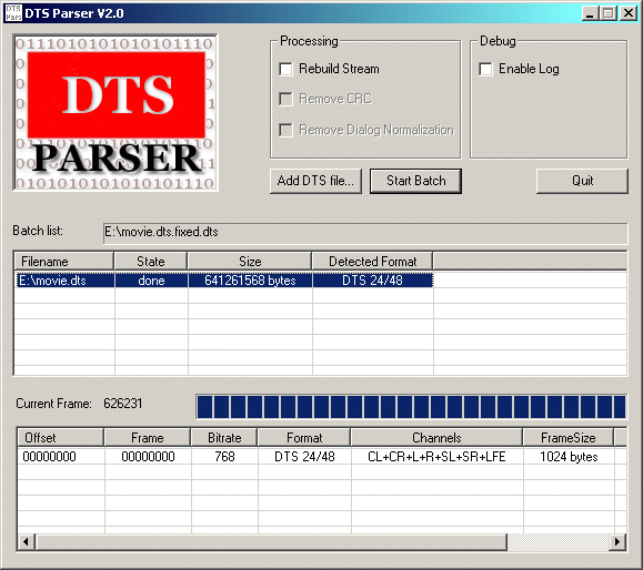

  12. DTSParser displays my DTS file as having two centre channels. I'm not sure why. That aside, it seems fairly keen on using the DTS channel order mentioned here.
    Me thinks DTSParser is incredibly outdated (though still somewhat useful, granted),
    its author wrote it and left it behind before the rise of the Blu-Ray era
    I mean, the program was not designed to deal correctly with DCA streams that are not compliant with the DVD-Video specification.
    Originally Posted by forum.doom9.org/showthread.php?p=1693586#post1693586
    File ........: D:\tmp\test 4\321.dts
    Size ........: 1886250 bytes
    ----------------------------------------- First Frame Info
    CRC present .................: 0 (Not)
    Number of PCM Sample Blocks .: 15 ( 512 samples/frame)
    Primary Frame Byte Size .....: 1005 ( 1006 bytes/frame)
    Audio Channel Arrangement ...: 9 (5 C + L + R + SL + SR)
    Core Audio Samp. Frequency ..: 13 (48 kHz)
    Transmission Bit Rate .......: 15 (768 Kb/s)
    Embedded Down Mix Enabled ...: 0 (Not)
    Embedded Dynamic Range Flag .: 0 (Not)
    Embedded Time Stamp Flag ....: 0 (Not)
    Auxiliary Data Flag .........: 0 (Not)
    Mastered in HDCD format .....: 0 (Not)
    Extension Audio Descr. Flag .: 0 (Channel Extension XCh)
    Extended Coding Flag ........: 0 (Not)
    Audio Sync Word Insert. Flag : 1 (Sub-sub-frame)
    Low Frequency Effects Flag ..: 2 (Present, interpolation factor 64)
    Predictor History Flag Switch: 1 (Yes)
    Multirate Interpolator Switch: 0 (Non-perfect Reconstruction)
    Encoder Software Revision ...: 7 (Current)
    Copy History ................: 1 (Definition deliberately omitted)
    Source PCM Resolution .......: 6 (24 bits)
    Front Sum/Difference Flag ...: 0 (Not)
    Surrounds Sum/Difference Flag: 0 (Not)
    Dialog Normalization Param. .: - 0 dB
    ------------------------------------------- Estimated Info
    Total Frames ......: 1875
    Duration ..........: 20 seconds. ( 0 h. 0 m. 20 s.)
    ------------------------------------------------- End Info
    P.S.: Also,
    http://forum.doom9.org/showthread.php?t=170061
    Last edited by El Heggunte; 14th Sep 2014 at 13:56. Reason: clarity; add usefull P.S. :-)

    LeeAudiBi... yum! It offers info not inclided in another app I use often, called MediaInfo.

  17. I've been using Audacity since version 1.2.6, and don't recall it ever being limited to stereo downmix. I'm sure folks at the Audacity forum will be able to answer that question.
    I duplicated the posted audio sample six times in Audacity then downmixed it to stereo. Yep, the distortion is unacceptable. Thank you sooooo much for pointing this out to me.
    Now I'm wondering why I didn't get any distortion when downmixing 52 tracks to a 4 channel mix, though I set the gain to 0dB on only a couple of tracks (see attached map). Maybe the wave amplitude is augmented only when identical frequencies are multiplied. No?
Name:	Audacity101_Map Surround Sound.jpg

    The Matrix Mixer DSP downmixes to stereo, normalising the way ffdshow does it when downmixing so you don't need to worry about clipping, the Winamp DSP Bridge loads the Winamp RockSteady plugin which compresses the stereo audio and then it's re-encoded. I use these settings, although you could always increase the "compression".
    The whole lot is saved as a conversion preset, so it's just a matter of opening the 5.1ch audio, right clicking, and selecting convert......
    Foobar2000 can open AVIs, MP4s and MKVs directly and play/convert the audio within. No need to even extract it first. It might take a bit to get your head around setting up foobar2000, but once you do the process should be quite fast. Well.... 1 minute, 50 seconds to downmix and compress an hours worth of 5.1ch AC3 and convert it to AAC using this old PC.

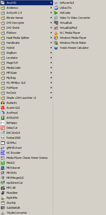

    You certainly use a large number of programs. Me...... MeGUI, foobar2000 are mainly what I use, along with MKVMergeGUI and MP3Gain, but if it's any consolation, I have a "multimedia" folder in my start menu, and the contents of it look like this:
