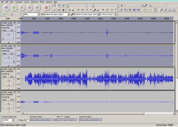

  1. I demuxed a movie that has too much audio dynamic range for my liking (my surround sound system does not have a "Night Mode") and would like some advice about channel assignment when mixing the channels down to stereo. Correct me if I'm mistaken, but would the following be a logical map? I'm guessing SS Ch-1 is front left, SS CH-2 is front right, etc.
    SS CH.3 is the loudest track, with the highest amplitude visible in Audacity that I'm using for the mix down. I don't want the stereo to sound monoaural.
    SS CH.....SPEAKER.........DESCRIPTION..............ST EREO MIX
    ...1.........Front L............EQ of main audio-----> Left
    ...2.........Front R............EQ of main audio-----> Right
    ...3.........Center.............Main audio------------> Split to L & R
    ...4.........Sub-Woofer......Rumble/Ambience----> Right
    ...5.........Rear L.............EQ of main audio-----> Left
    ...6.........Rear R.............EQ of main audio-----> Right

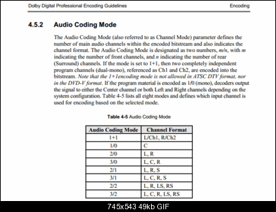

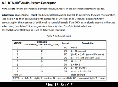

  8. Different formats use different channel mappings. There is no "usual channel layout" as such, although programs often display the channels in the same order. When you convert from one format to another, the channels should be remapped as required. There's a list of common channel mappings at the bottom of this page: http://avisynth.nl/index.php/GetChannel

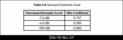

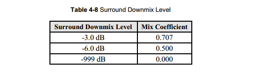

    For the record, I think the standard downmixing formula is to reduce the centre channel by 3dB, then add it equally to the left and right channels (it works out it's volume remains the same relative to everything else that way). In Audacity, if you make the centre channel mono and reduce it's volume by 3dB, the result should be the same. Anything louder than -3dB would be making it louder than it was originally. I could only guess as to what duplicating the centre channel and panning each copy by 30% would do (if that's what you're doing).
    If you add the LFE channel, the same 3dB gain reduction would apply. Panning it 100% right doesn't make sense to me.
    Adding left and right rear channels is often done without adjusting their volumes. It's probably personal taste there. Some people say you should leave them the same as when the rear channels are in the rear, they're closer to the listener than the front channels. Some prefer to reduce their volume a little anyway. I'm not sure why you wouldn't pan them 100% left and right though (Downmixing to Dolby ProLogic aside).
    You also need to be careful of clipping, especially if you boost any channels. It might pay to reduce everything by at least a further 6dB when downmixing. That way, combining the channels shouldn't result in clipped peaks. I'm pretty sure the AC3 spec says it should be an overall 7.5dB reduction, but that's a "worst case" scenario. If the resulting stereo file is a bit low in volume you can always import it into Audacity, normalise it, then export it again.

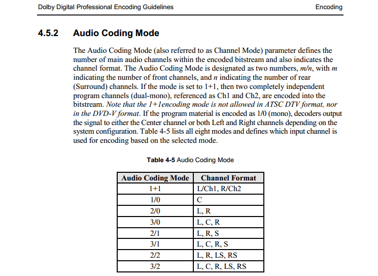

  11. Member Cornucopia's Avatar
    Different formats MAY have used different channel assignments (particularly in the past), but as per Dolby, AES and SMPTE, the STANDARD 5.1 channel assignment is as I mentioned. Broadcasters are required to do it that way, and so expect it that way from producers. Others may be putting out different configurations, but in the eyes of professionals, it would now be considered unprofessional and frowned upon.

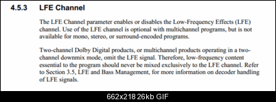

    Also, you have some misinformation (rather: incomplete info) on the workings of LFE (when it is professionally produced).
    It was intended and designed to be used for "low frequency effects" - items which SHOULD NOT appear in standard channels (emphasis on the effects). It is NOT there "for extra bass", and ought to contain mainly items which are not derived from the other channels. You've got to remember the history of surround is tied to theatrical presentation. (decent current) Speakers used in theatres have NO LACK of bass, and the LCRLsRs discreet channels are all supposed to be FULL RANGE (down to 0Hz in theory, ~20Hz in practice). However, in the early days of theatre surround, the main channels would have been overloaded had the bass effects been included in them, so a separate channel was dedicated in order to efficiently utilize its extra power requirements. This is no longer necessary with digital channels (which are able to go evenly from 0-24k+ Hz) and with intelligent bass management (where duplication of bass in both LCR & LFE could easily lead to TOO MUCH bass), and so the LFE is now focused on value-added, specialty sounds - those which may add to the visceral impact but aren't necessary to the overall program. Which is why, in Dolby's bass management downmix algorithms, it is expected to completely drop the LFE channel. Again, LFE does NOT (normally) equate to subwoofer, at least not on a 1:1 mapping.

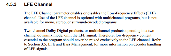

  13. Member Cornucopia's Avatar
    Center to -3 is for constant power, -6 is for constant gain (particularly when mixed to mono). -4.5 is a mid-way compromise between the 2. There are a number of options with these "pan laws", as they are called. These are all a matter of taste, but -3 is probably the most commonly used (and is historically what Dolby used in their original 4-ch. Surround method).
    Since low frequencies are non-directional, it may not matter acoustically where you place the material, but from a mixing/datamanagement/overhead viewpoint, biasing a single channel with the "power" of the bass samples will skew the L/R balance and my result in distortion in the "weighted" channel. So I agree, it's just wrong.

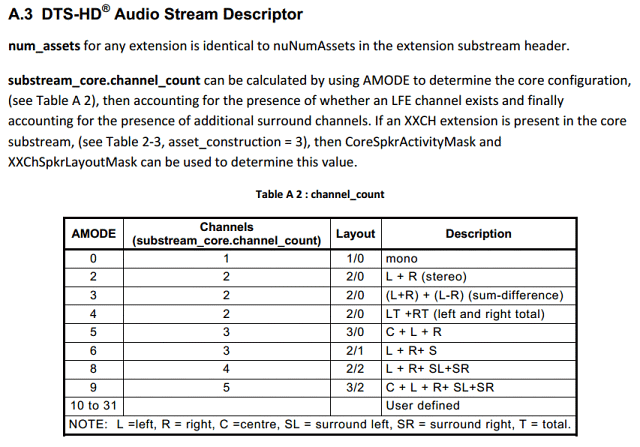

  15. Originally Posted by Cornucopia View Post
    Different formats use different channel assignments. AC3 and DTS use different channel assignments. Which one of them is unprofessional and frowned upon? AAC uses different channel assignments to both wave and the standard 5.1ch assignment you mentioned. Or was the AAC spec for multichannel assignments changed at some stage to be different to what it was in the past? When did that happen?
    Couple of links:
    http://www.dolby.com/uploadedFiles/Assets/US/Doc/Professional/38_LFE.pdf
    http://www.genelec.com/faq/multichannel/101-what-is-the-lfe-1-channel/
    Wish I could share with you some more exhaustive info on it, but it's all in physical textbook form.
    I wish you could too, because there's nothing I'm reading in either of those links which explicitly states the LFE channel contains info not found in the other channels.
    I'm reading this:
    "Its purpose is to supplement the overall bass content of the program or to ease the burden on the other channels."
    and this:
    "The .1 channel was originally designed for use in theatres where the main channels could not reproduce the lower frequencies and additional headroom was required at these low frequencies to reproduce high SPL."
    Which requires some serious extrapolation, to give you this:
    "It was intended and designed to be used for "low frequency effects" - items which SHOULD NOT appear in standard channels (emphasis on the effects). It is NOT there "for extra bass", and ought to contain mainly items which are not derived from the other channels."
    Either way though, the principle is probably still the same. If you're worried about too much dynamic range, don't include the LFE channel when downmixing.

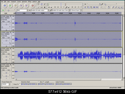

    Here's the LFE channel taken from "professionally produced" AC3 audio (from a TV series). The sample is just the first few minutes.
    Here's the left and right channels after applying a low pass filter at 80Hz. So I could hear just the low frequencies. Same few minutes in time.
    What's in the LFE channel that's not in the stereo channels (aside maybe some additional higher frequencies due to the low pass frequency I chose)?
    After applying a low pass filter to the stereo channels, they even look the same as the LFE channel.
    Towards the end of the sample you'll notice the LFE channel contains no audio, while the left and right channels do contain low frequencies, but I've not found a spot where the LFE channel contains low frequencies which aren't in the left and right channels too.

    @pandy, by that same link, 50% amplitude is -6dB, 50% POWER is -3dB. I have been referring to power (which is why I used the term). And you're wrong, downmixing equations, as hello_hello has just demonstrated, use a number of different algorithms, some based on amplitude/gain, some on power.

    BTW, one of those recs did explicitly state "LFE to be used only for special effects not put into the standard channels". Not sure now which one (EBU or ITU, I think)...
    Nope - Dolby always referring to 0dBFS and level not power. - there is no power in digital domain and usually there is no power in audio world.

  28. Well I confess I weakened and checked out your Dolby pdf. You'll need to explain what I'm missing here. The channel layout looks like the AC3 layout specified on the page I linked to.
    Looks like Dolby use the same formula as the rest of us. 70.7% = -3dB.
    "Therefore, low-frequency content essential to the program should never be mixed exclusively to the LFE channel".
    Seems a bit different to "It is NOT there "for extra bass", and ought to contain mainly items which are not derived from the other channels"
    I'll concede it certainly implies the LFE channel can contain low frequencies not found in the other channels. I'm still not seeing a likelihood of that happening much though.

    From the Dolby pdf:
    Channel Levels
    The following text is in accordance with the ITU-R recommendation and SMPTE standard referred to in the above section.
    For consumer and DVD production studios, relative channel levels assume each speaker delivers identical acoustic sound pressure levels to the listener. This excludes the LFE channel, which is intended for reproduction at +10 dB SPL (with respect to the main channels within the same 3 Hz to 120 Hz passband). Assuming that a Surround (S) signal is delivered to a single speaker and two Surround signals (LS, RS) are each delivered to individual speakers, Surround levels should be identical to those for the front channels.
    The way I read that, it seems the LFE channel is intended to be amplified far more then the rest. That'd explain why, in the sample I posted above, the bass frequencies in the LFE channel were lower in volume than the same frequencies in the left and right channels. I assume then, if you decide to include the LFE channel in the downmix, there'd be no need to reduce it's volume by too much. -3dB or -6dB. Any more than that, and maybe there's not much point including it at all.

  30. I have a vague recollection of linking to a page earlier which stated the channel order for DTS is C, L, R, SL, SR.
    I should go back and re-read my previous posts to check.
    Implementation of DTS Audio in MPEG-2
    Page 22:
    The beginning of the "DTS Audio in MPEG-2" pdf contains the following:
    "Do Not Duplicate. Copyright © 2013 DTS, Inc. All Rights Reserved. Unauthorized duplication is a violation of State, Federal, and International laws.
    This publication is copyrighted and all rights are reserved by DTS, Inc. Without the express prior written permission of DTS, no part of this publication may be reproduced, photocopied, stored on a retrieval system, translated, or transmitted in any form or by any means, electronic or otherwise."
    I guess I should leave it up to a mod to decide if I've violated the world police copyright laws by copying the above copyright warning and pasting it into my post. If I have, I guess a mod can remove it.
    Oh..... and the screenshot I posted, taken from the same pdf..... that might upset the world copyright police too...... although I'll vote for "fair use" on that one.
