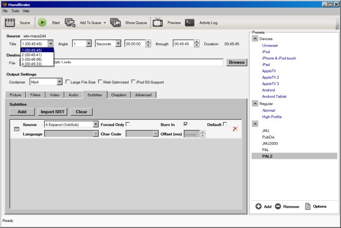

  6. Did you make a "rip" as described by jman98?
    At the top of the HandBrake screen (under Source) you can select the Title to convert. What have you chosen and which duration is shown at the right?
