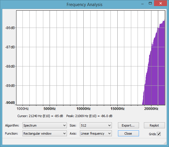

  10. OK, advanced resampling is not my strongest side as I don't really know how to use SoX but I just tried to reduce bitdepth of 24 bit silent track to 16bit. I used this command:
    @sox %1 -b 16 %1new.wav dither -s -f improved-e-weighted
    Here how plot spectrum looks in Audacity. First image is plot spectrum for SoX file and second is for foobar's dithered file.
    P.S. I don't have anything against command line tools but if I have a nice GUI that does a good job, why not to use it?

  11. Originally Posted by Detmek View Post
