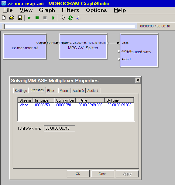

    Just build the graph manually, and then click on the "Play" button.
    I hope one image can paint some hundreds of words:

  9. OK, I didn't know about having to hit the play button. I was looking for some way to save and all I got was to save as xml or graph files so it was throwing me off. So what's the point of this graph tool? I don't see where the graph or xml output is being called in the vidtoasf or ffmpeg commands. Maybe I'm just not clear on what the tool does if the video container is just being changed

  11. Member Cornucopia's Avatar
    Also, GraphStudio/GraphEdit shows you graphically what is going on behind the scenes in code, so it doesn't work like other apps. What it shows is the workflow/program structure. When you save, you are saving the layout/connections for that structure's project (in xml or grf format). That way, you can reproduce that structure again if you need to.
    But most people don't use Gs/Ge to just create and look at a program-chain's structure - they actually want the structure to DO something. That's what the PLAY button is for: it "runs" your custom-built app chain. The output of what you've run (depending upon how you've set it up in the GUIs) and the kind of structure you have (file-based vs. stream-based vs. direct to display/card, etc) will determine what you get.

  13. I got it. I kept thinking it was just a simple open and save as and not a funky visual connect the dots kind of GUI. You were right though. This is kind of a pain in the ass format. I'll see if I can just write a bat file and registry entry where I can right click on an MKV and do all the command line stuff to get an ASF to take the hassle out of it and automate it where possible. If not, then it looks like these VC1s just aren't worth messing with. Might be easier just to find an already converted x264 and not worry about trying to get 1:1 on these. I tried doing that myself earlier and I was getting something stupid like 4 frames a second on my laptop. That would take way more time to convert than I'd want to let it run
