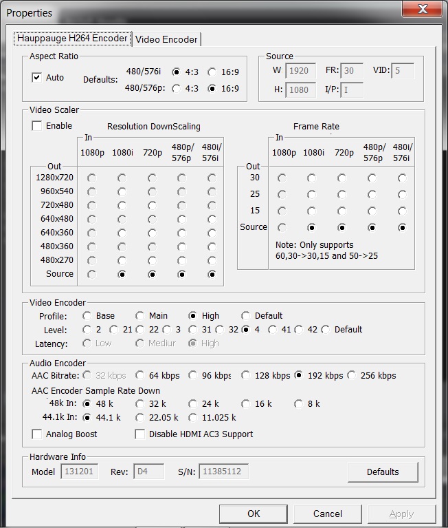

    I took usually_quiet's advice and finally picked up a Hauppage Colossus card, and a HDMI splitter, and after a very small amount of trial and error, (I first split from the output of my A/V Reciever, so that whatever I had coming out of it, DVR, Wii, PS3, etc., would be ready for capture. That didn't work as the feed to the computer was very choppy. I switched the splitters location to immediately behind the DVR (which is where I would be getting most, if not all of my content I want to capture) and it works like a champ.

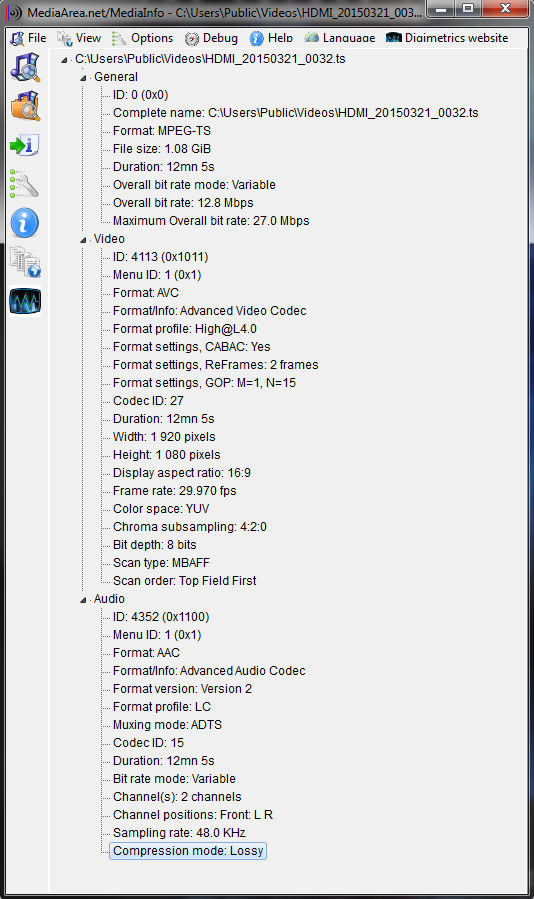

    So I did a test run of a few minutes of a game, and hit record. Recorded beautifully. Output was a file with a .ts extension. Played no problem in Media Player.
    My next step was to see if I coud use my Vegas (13) to edit the files I just made. It won't accept them. I did some googling and saw other threads about Vegas not taking a .ts file.
    How do I get this to work, if there is a way? I saw references to videoredo and other programs. I would of course prefer something that is available at no cost, although that might not be an option.
    I am attaching a screencap of the mediainfo for the test file I created. Is there some setting in the capture program I need to make, (I'm including a screen cap of the advanced settings available that came with the capture software) or is this some processing that I would need to do after the fact?

Name:	Advanced Settings.png

    I would use the version of Arcsoft Showbiz included on the installation disk to capture pre-recorded output from a DVR instead of WinTV v8. ShowBiz provides access to the Colossus encoder settings, and will allow you to capture AC3 audio, if the DVR can be set up to output AC3 Audio.
    This is a screenshot of the settings I used for the Colossus encoder page, accessable via ShowBiz's "Format" button on the capture Window.
    https://forum.videohelp.com/attachment.php?attachmentid=30445&d=1424878478
    TS is the Colossus's native format, and I always capture to a TS file with the Colossus. I was warned that MP4 files from ShowBiz are problematic, and that MP4 can't be used for AC3 audio capture, so I never used it. I never used M2TS for capture, but you could try capturing to M2TS with ShowBiz to see if that works better with Vegas Pro.

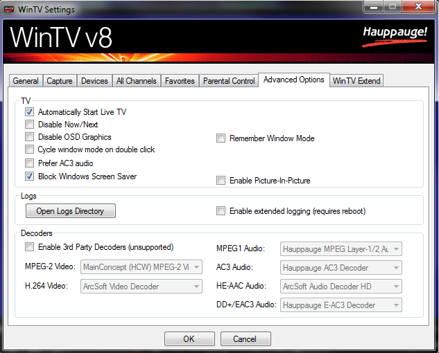

    I am having an issue finding the "arcsoft showbiz" software. My card came with 2 CD's, the winTV 7 (which sends you to the hauppage website for the latest, winTV8) and another disc labeled "HD PVR 2 - Gaming Edition". I opened both in explorer, and didn't let them autorun, and looked at the various folders and files and didn't see anything. Was something left out, or am I not doing something correctly?
    Edit: Just ooked at my screen cap, down at the bottom, under "decoders, enable 3rd party decoders, Arcsoft is listed. Is it as simple as checking those boxes to get the software to appear for me?
    No, it isn't as easy as checking the boxes.
    There was just one installation disc in the box I received. It contains WinTV v7, ArcSoft ShowBiz and an early version of the Colossus drivers. "ArcSoft ShowBiz" is printed on the disc in small letters. I had to do a full auto install in order to install ArcSoft ShowBiz.
    Maybe Hauppauge changed the software they bundle with the Colossus or maybe you bought the new Colossus II. If you don't have Hauppauge's customized version of ArcSoft ShowBiz available, Hauppauge Capture also allows access to the encoder settings.
