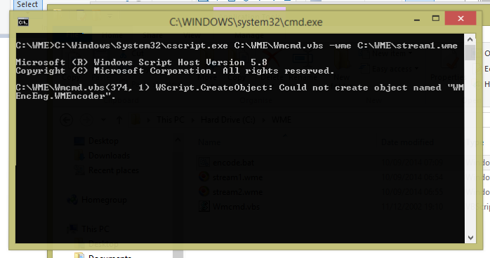

  5. Thanks for the continued advice, Cornucopia.
    I followed instructions found here:
    http://www.euphoriaaudio.com/tutorials/wmestart.php
    I can get to "Setup Step 7" but when I run the BAT file I get the error in the image attached. Googling around suggests that maybe there is a combination of 32- and 64-bit software in the chain which is preventing it running properly. I am on Windows 8 (64-bit) and have the latest versions of WME Series 9 and WME SDK, which I assume are both 64-bit as they run perfectly as standalone programmes.
    Are you able to shed any light?
    Stuart
