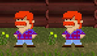

    There are slight differences in the point sampling algorithms and how you cropped. In some frames it might be better, others might be worse. For example, in the first frame, your version (on the left), has 2 pixels in the guy's right eye, whereas the ffmpeg version is even. This might reverse in other frames

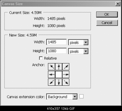

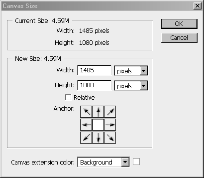

    Your original recording did not have a 1.333:1 aspect ratio, it was slightly wider 704x512 so 1.375:1 AR. It looks like you cropped the left & right then scaled to 1440x1080 for 1.333:1 AR
    I changed the aspect ratio when I decreased the canvas size. Is that what you mean?
Size:  11.2 KBClick image for larger version
    [Attachment 27502 - Click to enlarge]
    I noticed this too. If I knew how to fix it, I would.
    That's what I mean. You cropped some pixels off and adjusted the AR slightly
    It's alternating (not just buggy eyes, other parts of the picture) because you're not scaling by even multiples, and because of your other cropping adjustments. So you "fix" it by scaling 2x exactly, or 4x exactly. That's how nearest neighbor works best. Not to 1440x1080. 1408x1024 because you started with 704x512. That doesn't help you with your goal of YT unless you have it letter and pillarboxed. Can your game do other display dimensions ?

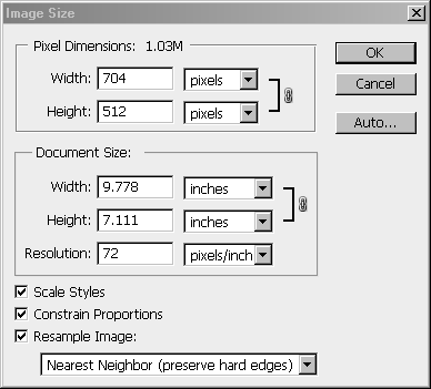

    I'm a little confused. I told Photoshop to constrain the picture proportions. Shouldn't that make a difference? When I magnified the image, it scaled to 1485x1080, not 1440x1080. It was only after I cropped the canvas slightly that became its final 1440x1080. I wouldn't think cropping the canvas would change absolute pixel position at all.
    It's because 704x512 is 1.375 AR, not 1.33 . That's why photoshop gave you 1485x1080 (1485/1080 = 1.375)
    When you crop in RGB, how are you going to crop 0.5 pixels ? You have an odd number. Three of the right, two of the left? vice versa? How do you decide to do it ? Subpixel scaling or non unit pixel scaling with interpolation will give you blurrier edges . That's the point of using "nearest neighbor". (And if you were doing this in YV12 4:2:0, you're not allowed to crop by single pixels , only by 2's, because the planes containing color information are 1/4. 1/2 in each dimension)
    The pixel interpolation is nearest neighbor, so some pixels will get doubled, some won't, unless you do it exactly 2x, 4x, 8x. That's why you get the "double wide eye" phenomenon on some frames. If you have exactly 2x, 4x,... etc... scaling, that means you have 1:1 representation. If you scale by 1/3 or some weird amount or fractional ratio, you don't have 1:1 representation of pixels - does that make sense? So on some frames, some pixels will be doubled, but others they won't be. Other interpolation methods other than "nearest neighbor" use various averaging and math formulas so you don't get that effect with different fractional ratios, but nearest neighbor preserves full pixels. Also, "nearest neighbor" isn't always "exactly" the same, because the scaling center might be "top left" in some programs, or "centered" in others, and the effect of doing it in different color spaces /subsampling has a major effect for different results ( the U, V planes aren't full resolution)

  11. Well, everything is looking good! Thanks, everyone!
    I know some of you might want to see this. . .
Name:	Lesson Learned.png
    And it's not even half of the full load.
    May 2014
    Memphis TN, US
    Originally Posted by TheUninformed View Post
    How long did it take you to waste converting it to png, processing in photoshop, etc...? How much extra HDD space did you need?
    Three days. Sixty gigabytes.
    That's learning the hard way !
    Yep.
    This resizing business is a headache. I keep asking why the original mp4 is 1440x900 and the original image is 1.375:1 aspect ratio. I don't use game consoles, but shouldn't the image be 4:3 to begin with? Don't know the O.P.'s software, though, and no time for gaming.
    In Avisynth I tried both resizing methods from poisondeathray, below:
    #1:
    ffmpeg -i "original video.mp4" -vf crop=w=704:h=512:x=368:y=194 -an -pix_fmt rgb24 -f rawvideo - | ffmpeg -f rawvideo -pix_fmt rgb24 -r 15 -s 704x512 -i - -vf scale=w=2112:h=1536:flags=neighbor,crop=w=2048:h=1536:x=32:y=0,scale=w=1440:h=1080:flags=neighbor -c:v utvideo -an ut_rgb.avi
    #2:
    -vf crop=w=682:h=512:x=11:y=0,scale=w=1440:h=1080:flags=neighbor
    Yep, I got some 2-pixel eyes on some frames, not on others. So I tried it in ffmpeg and got the same thing (only my second time out with ffmpeg, so maybe I did something wrong. No surprise).
    Two 2-pixel eyes show up in the attached video_newAR.mp4, which used #2 above.
    Since I don't care to alter image aspect ratios by chopping off pieces of 'em, I ran a similar Avisynth script but kept the entire original image intact and resized 2x with PointResize. Of course that meant I had to add some borders to get a 4:3 1440x1080 with the original 1.375:1 image inside it (attached video_OriginalAR_LB.mp4). On the other hand, nothing is lost from the original and it looks sharper (IMO). I realize people don't like borders, but you'll get some anyway on displays wider than 4:3. The script avoided YUV-RGB-YUV conversion. Original YV12 all the way, with help from the ColorMatrix plugin.
    Took maybe an hour to make several test versions -- nowhere near 3 days. Thanks to poisondeathray for good and useful notes on this project, and to jagabo for the cool panning demo.
