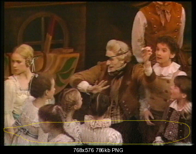

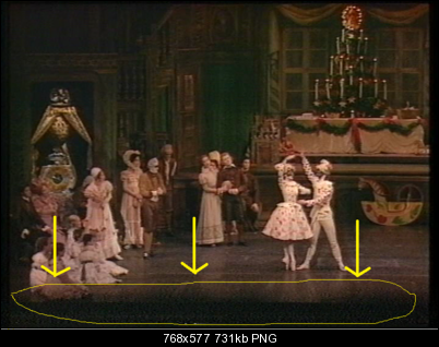

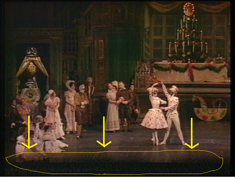

    Equipment:
    Panasonic NV-HS950 S-VHS
    I use the S-video output which clearly gives better resolution and colours.
    My problem is no matter what tape i play in the bottom of frame i get lots of noise. I have cleaned the VCR but still noisy and fuzziness in the bottom of the frame occurs. I have also tried to switch off the internal TBC and tried with built i 3dnr but same thing. The stills from movie shows that only the bottom of the frame has alot of noise. I have also tried to play with the manuel tracking but that still doesn't solve the issue.
ID:	27305Click image for larger version
ID:	27306Click image for larger version
    Any solution?
    thanks
    More details please. What did you clean and how?
    Have you tried playing the tape in another VCR? Sometimes a tape just doesn't play very well in one VCR whereas it plays fine in another, even if both VCRs are in perfect working order and cleaned. Basically you need more than one VCR to play back different tapes. This is normal.

    Aug 2007
    That noise looks like an alignment error - its the same effect on screen as tracking but its caused by the tape head trace not following the helical scan correctly. This is either because something is worn or someone has twiddled the guide post. Guide posts can work away from their preset position after a tape stall and jam too.
    Great machine though - well worth fixing.
    EDIT: Skiller is spot on too - and that's why I have more than 10 VCR's!
