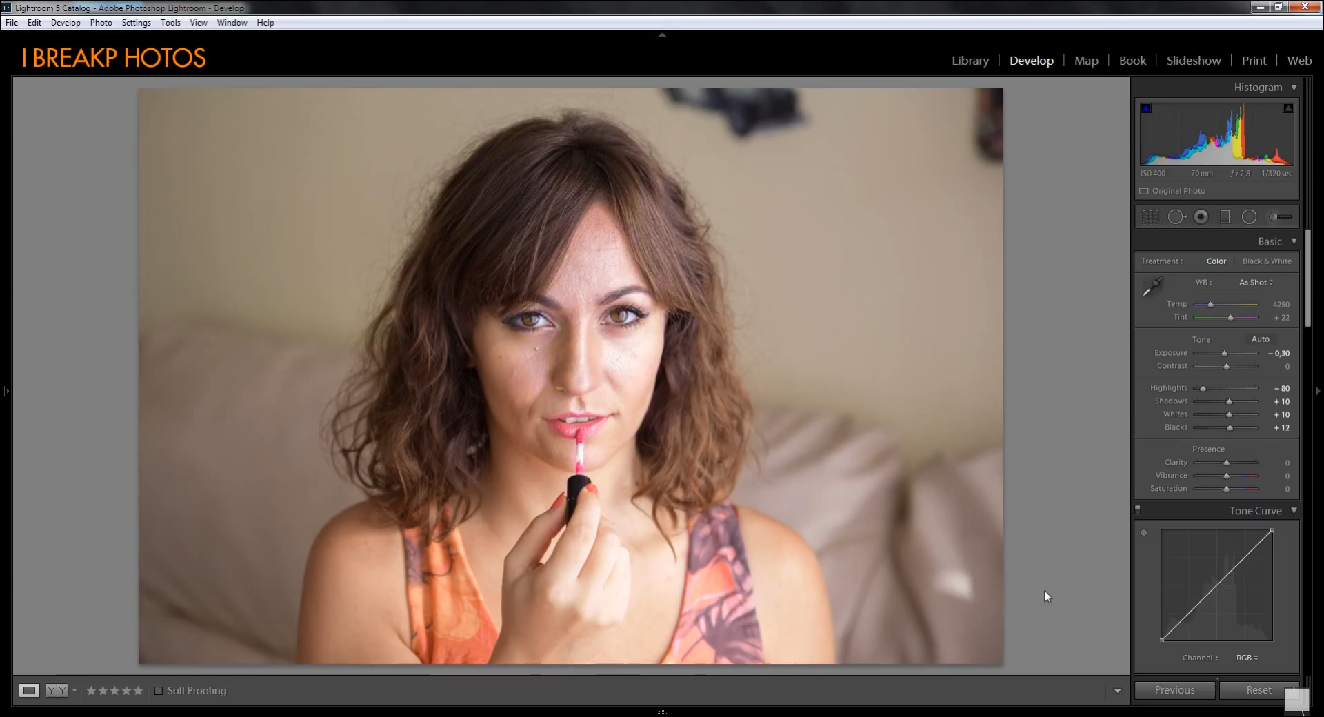

    I started making lightroom and photoshop tutorials on youtube and, while I'm pretty familiar with both of those, I'm quite a noob at video. I record my screen using Camtasia (save as .avi) and then compress this avi to a .mp4 file with handbrake.
    I have noticed that my videos don't look the same after uploading - they lose a lot of contrast. I googled a bit and found out things about color profiles, and the difference between TV and PC profiles, with TV profiles rendering a 16-235 range of brightness values, and PC 0-255... And I think this is what's happening with my videos.

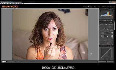

    Check example here: https://forum.videohelp.com/images/imgfiles/HLKnQ2b.jpg
    You can see that the right side is a lot more desaturated and it overall lacks in contrast. (When I do "video enhancements" in the video manager by increasing the contrast to 1, the washing out is kinda fixed, but the color go completely off and are more red, while they should be yellow)
    Since I make photoshop/lightroom tutorials, color accuracy is very important for me and I want to fix this ASAP. However, I haven't been able to fix this. The matter is further complicated by the fact that some other monitors display my video properly, so I thought it's a problem with my graphics card. I have a nVidia GTX 760 and after changing the dynamic range to 0-255, the video looks normal: https://forum.videohelp.com/images/imgfiles/Z4Uj8Rm.png
    However, this is a fix for ME, not for all the people out there who maybe didn't check this option.
    I'm wondering is there a solution to make my video appear as accurate as possible on most monitors and devices people use. If I'm showing a photography technique and my colors are off, that's quite bad, so it's very important.
    I've increased the contrast in the video enhancements of youtube and it does help somewhat, but it still isn't the color accuracy that I want.
    The video in question is here: https://www.youtube.com/watch?v=aInyjiH5TxQ and a screengrab from the original .avi: https://forum.videohelp.com/images/imgfiles/97q0amy.jpg
    So, how do I convert my files to the correct color profile?
    Thanks to anyone who can help, as I actually stopped making videos alltogether until this issue is fixed :/

  4. Your MP4 video has the right levels But it's marked as rec.709 color when the RGB source was converted to YV12 with a rec.601 matrix. That is causing the reds to brighten and greens to darken:
    https://forum.videohelp.com/threads/329866-incorrect-collor-display-in-video-playback?p...=1#post2045830
    You need to convince the software to convert from RGB (in the AVI) to YV12 (in the MP4) with a rec.709 matrix, not the rec.601 matrix it used. Or you can flag the MP4 video as rec.601.
    Since you used x264 in Handbrake you can flag the video as rec.601 by entering:
    colorprim=bt470bg:transfer=bt470bg:colormatrix=bt470bg
    into the x264 Extra Options field. I don't know if Youtube obeys the flag though (many players don't either). It may assume all HD is rec.709. In which case you'll have to find some software that does the RGB to YUV conversion correctly (I didn't see any options for this in Handbrake). In AviSynth it's a simple as

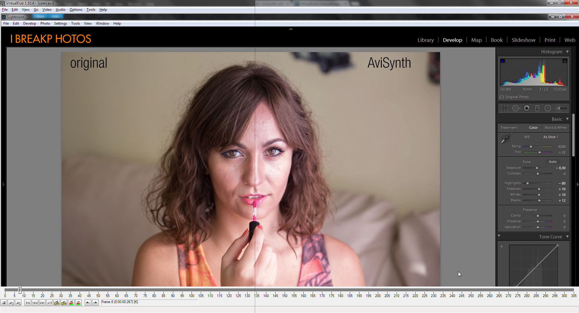

    I can do your sample script (AviSource), but when I open in in VirtualDub, the frames skip and are mostly just black with the picture here and there.
    I tried the one with the conversion step, and this is what I get: https://forum.videohelp.com/images/imgfiles/oxglqzw.jpg
    It's actually the opposite of what I want. The colors are too red after AviSynth. I don't think this is solving anything; the original avi displays colors properly: the problem is when I upload it to youtube or convert to mp4: then the colors get messed up and they also get washed up, which isn't the case in the avi.

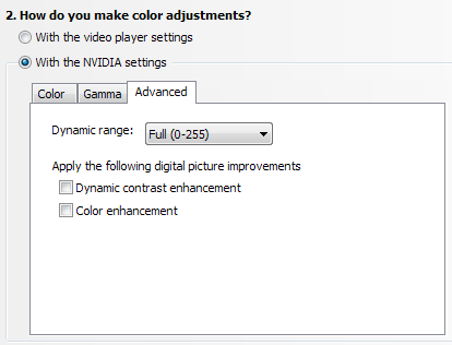

  10. The two files you posted are identical. The problem may be in your Nvidia card settings since video overlay and "regular" monitor video can be adjusted separately.
  11. In short, there is no actual problem with levels with the videos or youtube. That is something with your screenshot taking process, or your configuration with your graphics card, or renderer
    Part of another problem is the techsmith 2 codec. It outputs RGB, but opensource decoders like ffmpeg/libav decode it as YV12. That's why even if you upload it as the original, there could be discrpancies with what you want (YT uses ffmpeg/libav derivative for decoding and encoding)
    And the official windows VFW decoder has problems with black frames (this has been reported before) - that's why you see flashes in vdub
    There are some inconsistencies between what you are reporting. Your splitscreen pic suggests "avi from camtasia " is using 709, or direct RGB, but when I open up with camtasia decoder directly (outputing RGB) , the colors it looks like 601 from ffmpeg/libav would have been used. Note none of those aspects affect the levels.

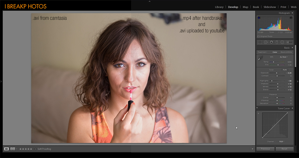

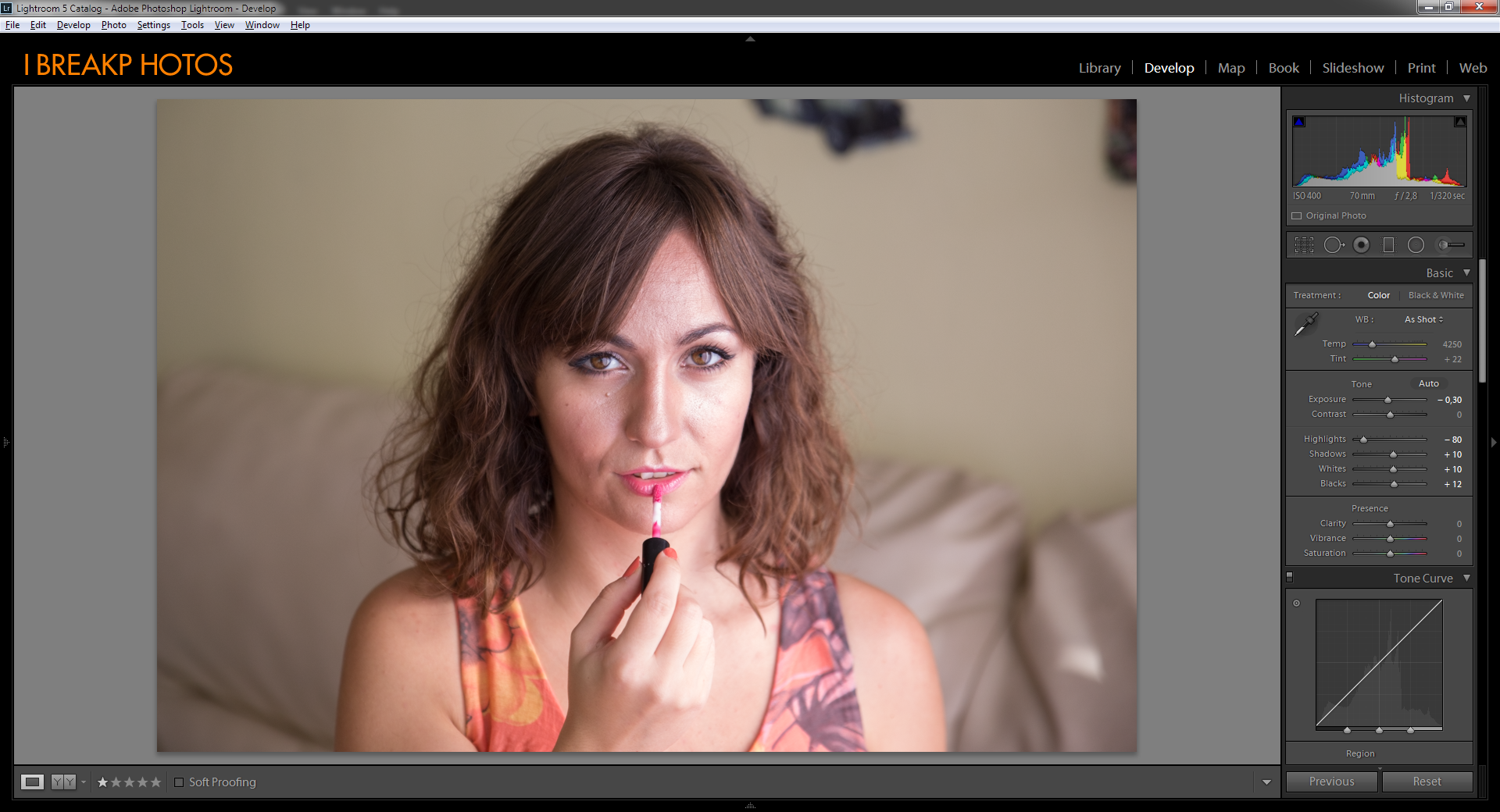

  12. To explain better, look at your split screen photo. I've reposted it here
    In the RGB screenshot, "black" edge around the border of "IBreakPhotos" logo is at RGB 0,0,0 for the "AVI" left hand side, but "black" is RGB 16,16,16 on the right hand or "handbrake" side. Obviously that's wrong
    If you view or take a screenshot properly, black would be at RGB 0,0,0 for the "handbrake" side as well, in fact it is when your sample MP4 or AVI is downloaded
    Just because your computer / gfx card isn't setup properly, doesn't mean everyone else has the same problem . And by the same token, there might be others who have the same setup issue (you have no control over that)
    The other issue is Rec709 vs. 601. Again this doesn't affect levels, only the skin tones and color shift. I've posted resized screenshots of 709 vs. 601 should look like. When I use the Techsmith decoder, it outputs RGB and looks like the 601 screenshot. All videos on youtube will look like the 709 screenshot, when you convert it properly using 709 (YT converts back to RGB using 709), even in SD regardless of flags

  13. Thanks for your replies, guys.
    Which codec would you recommend to avoid this issue? I can choose between these:
    I take a screenshot just by pressing Print Screen. I paste it into Photoshop and save as web (with sRGB color space). So I actually see 16, 16, 16 on my monitor.
    I get it that I can force my graphics card to use the 0-255 range instead of the 16-235 - I have said that I tried it and it worked in the first post! BUT - I don't want to do it. I can see OTHER videos on youtube with normal 0,0,0 black levels, and although it might be a problem with my configuration, it can be circumvented so even though there is an issue, colors are displayed as they should be. My question is - how do I do that?

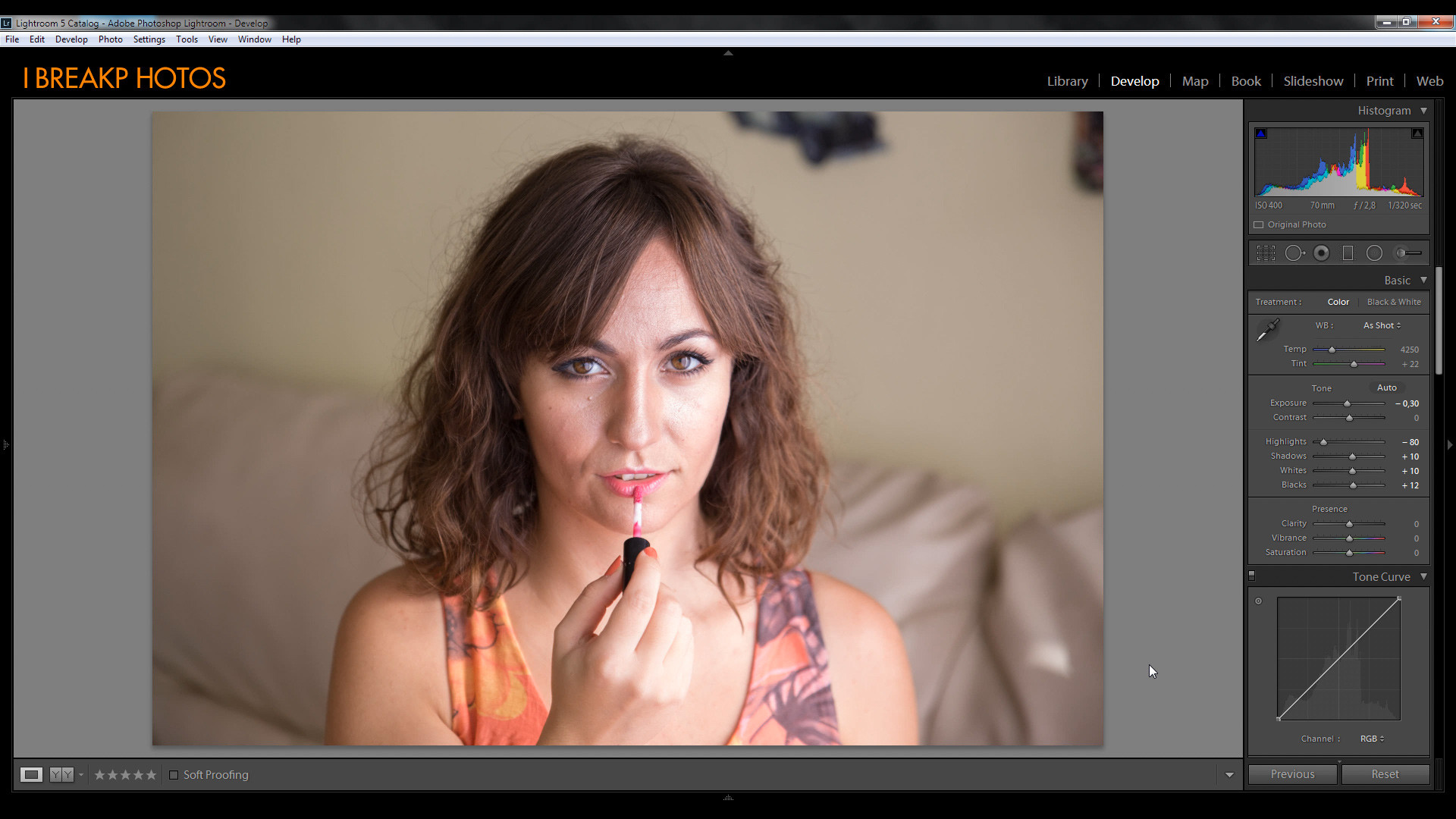

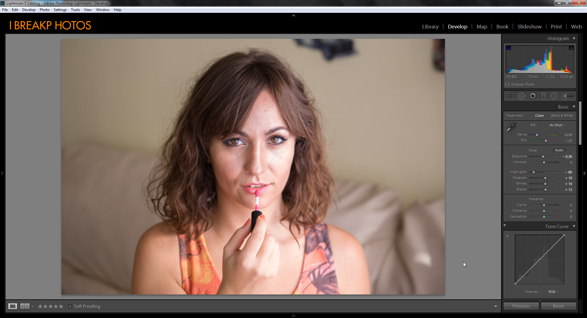

    The problem is that on youtube the video looks like on the first screenshot (601), while it should look like the second (709). This is independent of my graphics card - I had my girlfriend take a screenshot of the youtube video and send it to me. It looks too red, like 601.
    I mean, feel free to check out the video on youtube, it's not like I'm trying to further complicate things.
    So the issues are:
    1) I need to force everyone with a configuration similar to mine to display the 0,0,0 black levels (it's possible, obviously, as if it wasn't possible, ALL youtube videos would have 16,16,16 for black, which they don't)
    2) Colors must render as in the second screenshout (709), while on youtube they render as 601

    For me, your YT video looks like the 709 screenshot. But again, that's going to change depending on how you have things configured, HW on or off, browser, os, etc....
    *Best practice is to use 709 to convert to YV12, and flag it as 709 as well. You cover the most bases, platforms , os's , configurations, and are the most accurate (If you download the actual video, it will be technically "correct")
    The ONLY way you can be color accurate (and even then 99% people dont have properly calibrated displays so the point is moot), is if you use some RGB format. This avoids all the YUV<=>RGB mess. Of course flash , HTML5 and YT doesn't support it.

    (JPEG is a different story. It's actually stored as YUV, but commonly decoded as RGB)
    Another method is to use avspmod with avisynth. You can configure an RGB color picker so when you hover over the preview it will read out values in the info bar. It also tells you in the info bar you what colorspace the video or image has been opened with
    Ok, thank you very much for both your help and patience, I'll try this tomorrow and upload a sample video to youtube to check if everything's according to specs. Hopefully, it will be.
  20. Originally Posted by ibreakphotos View Post
    That's only as far as your computer and screen capture so far...
    YT is a different matter as described above. Even if video is "correct", how it looks on YT depends on your OS, broswer, HW on vs HW off, HTML5 vs. Flash, etc...

    These are the original colors:
    This is what I get:
    IF I export directly from Camtasia as a mp4 file and compress it with handbrake, my colors are good when I play the file back in BSPlayer, but when I upload to youtube, something happens and my colors are wrong again:

  24. Banned
    Oct 2014
    Northern California
    [Attachment 27355 - Click to enlarge]
    This is what I get:
    [Attachment 27356 - Click to enlarge]
    For starters it would help if you could upload both images uncompressed PNG so we can do a mathematical comparison.
  25. Originally Posted by newpball View Post
    This is what I get:
    Sure.
    Here is the PNG from lightroom (so, a desktop screenshot, how the colors "should be"):
    This is how Camtasia captures it:
    I forgot if I uploaded this version or the one after handbrake, which format it was (it was a long time ago, I have both mp4 and avi files), but this is how it looks on youtube now in 1080p:
    In any case, this is how the .avi looks like (the second mp4 is identical to the avi):
