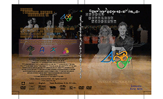

    The "checkerboard" is Photoshop showing you a transparent background (mine's usually purple & white, but it varies). If you go into its preferences (Transparency & Gamut section), it'll even give you ways to adjust this check look.
    Of course it prints white!: <Blank> on white paper looks white (because it didn't print anything there).
    To add a photo you can do one of 2 things:
    1. Use the [File | Place...] menu function, which will open up & place either photos or vector graphics (like pdf, eps, ai, wmf) while also allowing to the adjust their size prior to it's first rasterization render (this will give you the best resolution possible, but doesn't often give you a preview until you've completed sizing).
    2. Do a standard open of another image [File | Open], but then DRAGGING the image (with the black MOVE arrow) from it's box to lay on top of the template. If you'd rather not change the tool, you can also just drag the layer from the layer stack, via its thumbnail, onto the template. Then position, and if necessary resize (using the [Edit | Transform | Scale] menuitem). And if that turns out to be ABOVE the other guide layers in the layer stack, just grab it's thumbnail and drag it down stack until it gets to a border between 2 lower layers (where the border will temporarily highlight bold).
    Do this as many times as you want for as many layers as you want.
    This is an example of the insert I did recently. It has ~>80 layers (including adjustement layers).
    You can do cardstock or do glossy, photo-quality paper, but for DVD case inserts, regular paper works quite well. I use that on my last job and heard nothing but praise about it. I did of course use a Color Laser copier at Kinkos/FedEx ($0.53/color sheet, IIRC), so yes, an inkjet isn't going to look quite as good. And, unless you've got the color profiles perfectly worked out, you'll probably need to waste a few sheets (and ink) while you experiment getting the colors & registration just right. In that case, I'd use plain paper on all but the penultimate test and then use photo-glossy paper.
    Hope that helps,

    omg that is SO awesome!!
    you used photoshop for all of that?
    did you self-teach photoshop starting as a beginner? can you come to ny and give me a class or something?? lol

    Yes, for ALL of it, except certain logos which were supplied to me by the client, or some stock icons which I modified separately anyway (you kind of have to do that often to make it all look consistent).
    On-disc printing requires printable discs and a printer which has been designed to allow running discs through it. Don't get any that aren't either dedicated for discs or designed to do discs with an (add-on?) attachment (which you would have to also get). Epson makes good ones. I used to work with Primera ones, which did the job but were SLOW!
    For inserts, you'll get a better look if you go with color laser or dye-sublimation vs. inkjet. Usually MUCH better. And it isn't that expensive if you just run down to the local shop and do the self-service copier route. Worth the trip, IMO.
    Once you get to a certain level, and particularly when you have jobs that are >~250, you will be much happier and feel much more professional letting the replicator do both the replication, the silk-screening on disc, and the inserts, and shrink-wrap in packaging. But, it takes a while to get to that level. I'm not at that level for MOST of my jobs (I wish).
    re: teaching, yes I learned 95% of pshop self-taught. Read a number of books, did a few tutes from the web, but mainly by trial-and-error day-in, day-out stuff.
    I could teach a class if it paid enough. Seriously though, you can do the same as I, and there are plenty of classes or tutorials that are well-done, accurate and thorough enough to get you up to speed on a LOT of Photoshop's abilities (it probably takes months if not years to learn all it has available).
