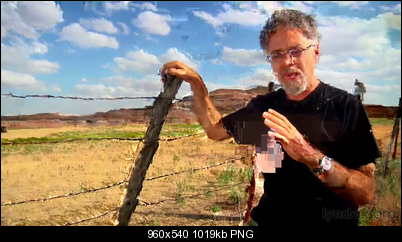

    This is my first time posting in this forums and kind of new to video editing so please bare with me.
    When I play videos (haven't narrowed down to encoding, container, etc..) I many times get trailing pixels around moving objects on the image as well as pixelation. Then after a while of playing the video, it goes away. I've attached a snapshot of a video as an example. Look under the guys left hand, where you see the skin toned blob is where his hand was a fraction of a second ago.
    can anyone help me pin-point the root cause of this problem?
    Thanks,

  2. Edit: also notice pixels around edges. thanks
  3. It's probably a decoding problem. I don't know whether it'd be the decoding when you re-encode, or the decoding of the re-encoded version. Many frames require information from surrounding frames before they can be displayed correctly. The "trailing pixels" looks like missing information. If it only happens immediately after you've navigated to a new location in the video, but goes away and doesn't happen as long as you continue playing, it probably means the player isn't decoding all the required frames in order to display the current frame(s) correctly. If you navigate to a slightly earlier place in the video and play through the section from which you took the screenshot and it still happens, there's probably something wrong with the video.
    Is that picture typical of your encoded/edited video? Because the quality is fairly awful. It looks like the encoding bitrate was way, way, way too low.

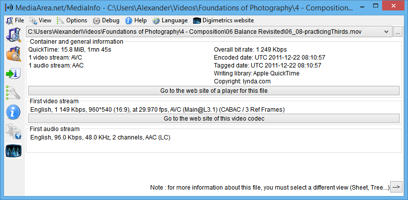

  5. Firsts I want to thank you for your information.
    The video I did not re-encode, I downloaded it to watch. The information of the video is as follows:
