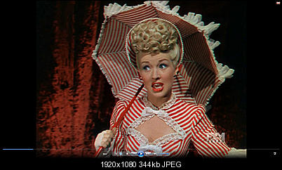

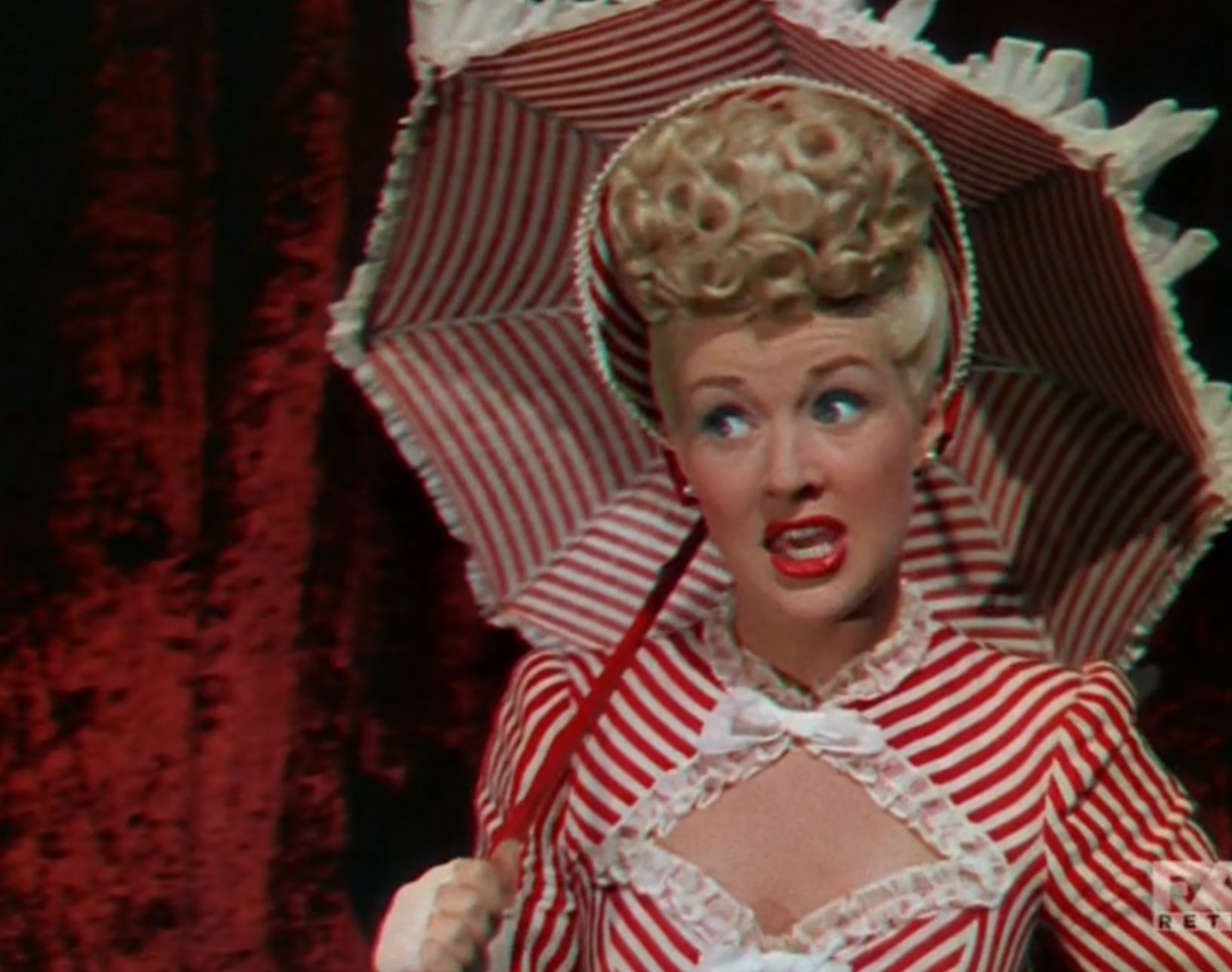

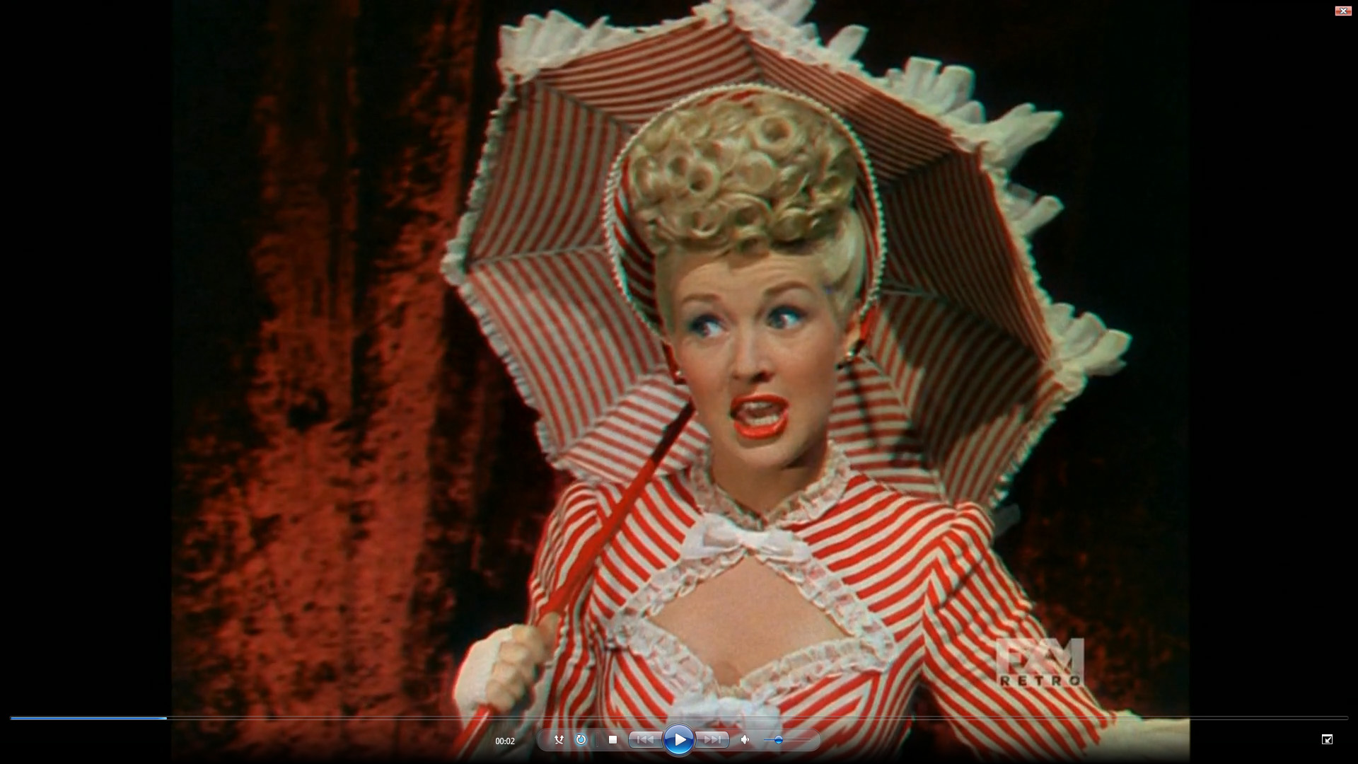

    I have tried viewing in media player classic and windows media player and they look the same. Both are discolored and dark.
    I have attached 2 screenshots to show what it looks like. Number 1 is a jpg exported from avidemux. The other is from windows media player.
ID:	27218Click image for larger version

  2. MJPEG and JPEG usually use the full luma range (0 to 255). Almost all other video formats use a limited luma range (16 to 235). So when converting MJPEG to other video types you need to compress the luma range. Not all players realize that MJPEG has full range luma and play it properly. And if you set up your system to display full range MJPEG properly it may be misconfigured for displaying most other video.
    To advise you further we would need to see a sample of your source. Are these something like Black Magic Intensity Pro captures?
  3. Originally Posted by jagabo View Post
    Thank you for replying!I have the Black Magic Intensity Shuttle and I captured the video with Blackmagic Media Express. I remember reading about the luma range and I have messed with all kinds of settings. This is what I've done so far: Adjusted the LAV video decoder settings for RGB Output levels from TV (16-235), PC (0-255), to untouched (As Input). Neither of those helped. (They could be unrelated I don't know what I'm doing.) I forced 0-255 range in the nvidia graphics drivers settings. (Assuming I did that correctly.) I have attached the video file to this post. (Hopefully I have done it correctly.)
    Last edited by Plz Help B4 I Kill Myself; 1st Sep 2014 at 19:11. Reason: I forgot to thank the wonderful person who replied to my post.
  4. The sample video has darks all the way down to zero. Brights don't get much brighter than 210 or so. I don't know if that's the nature of that scene of if you need to adjust the capture devices proc amp to bring the bright level up.
    So, unless your proc amp it badly maladjusted, you can assume the MJPEG video is full range YUV. Normally when converting to standard video formats like MPEG 2 or h.264 you would convert from full range to video range, 0-255 to 16-235. That would be ColorYUV(levels="PC->TV") in AviSynth.

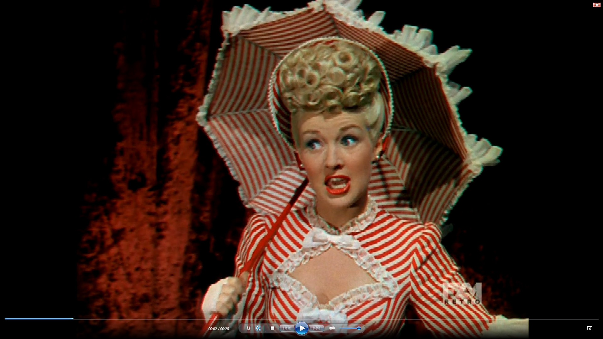

    What I don't understand is that when I view them in Media Player Classic or Windows Media Player it looks more orangey and different. Like here:

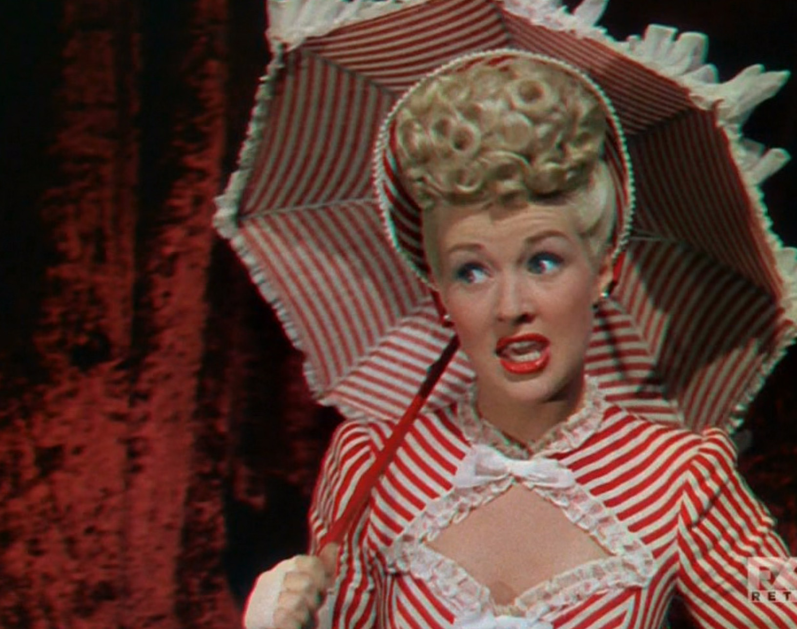

  9. Well, I've been trying a few things with the information of your last post. I used the Blackmagic Media Express capture program to capture a new test video. I tried capturing in "AVI Motion JPEG" and "AVI 8-BIT YUV". (I tried to see if there was some way to change the MJPEG compresser to work in YUY2 but I couldn't see any options for that.) When I put the AVI 8-BIT YUV file in Avidemux it works perfectly! The only thing I have to do is swap the U and V color channel thingies. The yadiff deinterlacing even worked perfectly too! The MJPEG still has the same problem.
    I downloaded VirtualDub and tried to capture with that to see if it made a difference but it crashed my computer with a blue screen twice. I think it's safe to say that VitrualDub and Blackmagic Intensity Shuttle are not the best of friends. I scrapped that idea because blue screens frighten me. I then tried to edit the test video we've been working on here. When I opened it at first I fainted because the colors were perfect and nothing seemed to be wrong. Once I came to, I started by swapping the fields and deinterlacing it. The colors were fine but the deinterlacing looked like it did before. I removed the swap fields and now I get a perfect image. The only problem is if I choose MJPEG compression in the compression settings in VirtualDub, export the video, then open it up with AviDemux, the same problem exists! In Avidemux the fields and YUV color stuffs are all pooped up again! So I tried a different compression method called Microsoft Video 1 and that darkened the video slightly and didn't look absolutely right. I put that file into AviDemux and had the same problem as before. I then tried the Blackmagic HD 8-bit YUV compression method and put that file into Avidemux which gave me a blank green screen. I finally tried the Uncompressed compression method (Which I guess isn't exactly a compression method but I think you know what I mean.) and I put that file into Avidemux and it appeared upside down, so I used the vertical flip filter and encoded it. It came out darker and it was slightly squished as you can see here:

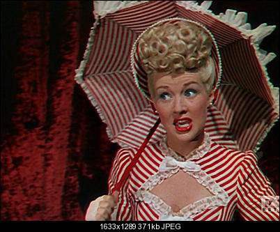

    Original:
    Dark and Squishy:

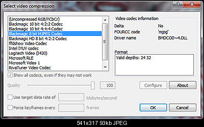

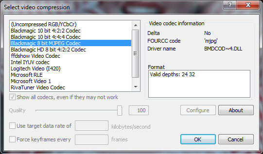

  10. What MJPEG encoder were you using with VirtualDub? Go to it's configuration dialog and see if there is a "swap fields" option. Also look for an "interlaced" option. It often appears as "Assume interlaced if height greater than [___]". 288 is a good value for that.
    I was using "Blackmagic 8 bit MJPEG Codec." I think it's the same codec that I'm using with the Blackmagic Media Express program. I looked at the options in VirtualDub and it looks like I'm unable to configure the codec. When I click the About button it just gives me what looks like a version number.
    I might have information that may help. (Or I may not. I'm really just clicking things untill they work.) I've installed ffdshow and x264vfw for VirtualDub and have noticed something. I encoded a video in x264 format and it came out in the same orangey dark mess as before so I looked at the x264vfw configuration settings. One of the drop down boxes said "Convert YUV 4:2:0", I switched that to "Keep Input Colorspace". That had the same results. I then selected "Keep/Accept only RGB" and that came out perfectly! I then took a look at the Color depth options under the video tab in VirtualDub. The Decompression format is set to "Autoselect" and Output format to compressor/display is set to "24 bit RGB (888)". I don't know what any of this means for I know less about video editing and converting than a peanut butter sandwich. From what I've learned in the thread I have a basic understanding of the differences of RGB and YUV but only in the sense that RGB consists of Red, Green, Blue and that YUV has the Luma Y, Chroma U, and Chroma V. That's all though.

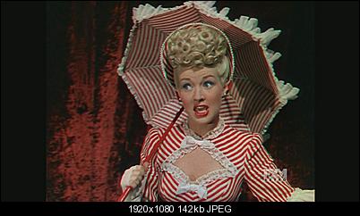

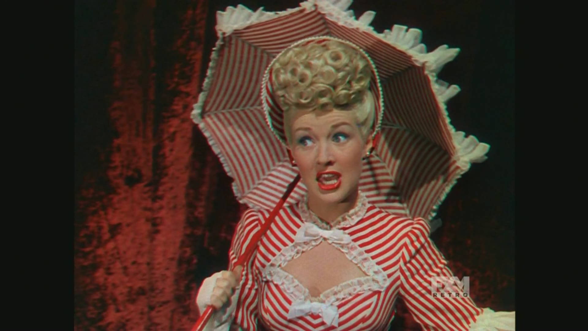

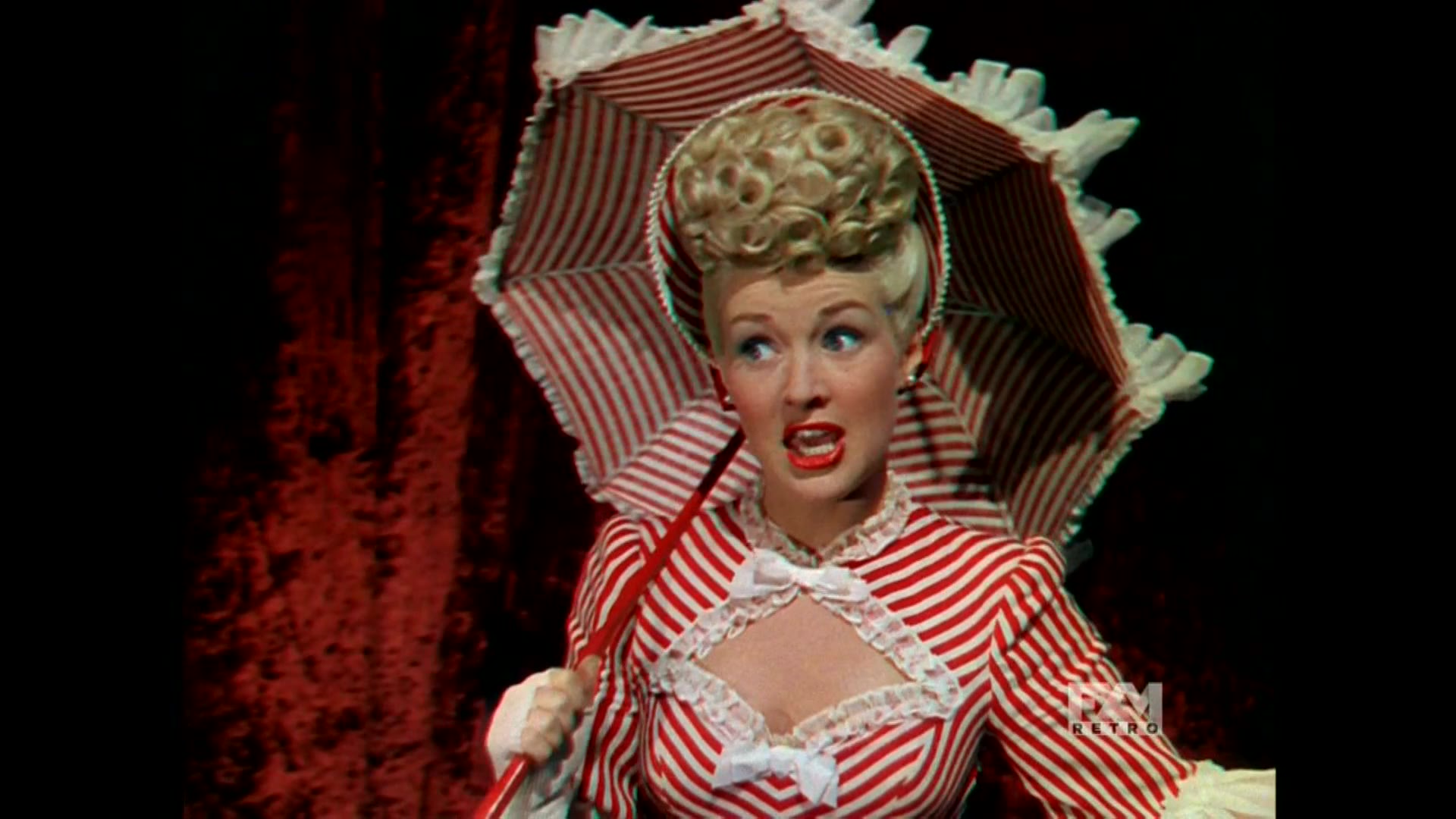

  13. Your video looks slightly orangey on my screen. Atleast, the red colors look more orange than the deeper color red in the original. I am quite certain the color wandering is part of the movie. It's fairly common for movies from that era. I tried to match your video by using the YUY2 settings and it looks just like yours does. (except not as good visually because I don't know how to encode properly.) Does this mean that I need to change a decoder setting?
    Just to make sure we are seeing the same thing, this is what your video looks like on my computer via WMP:
    I've attached a video that I encoded with the RGB setting. I see why this is a bad idea because it was more than twice the size as the YUY2 4:2:2 file. (Actually, this was probably my fault. I don't know how to use the x264 encoder and I'm pretty sure I'm ruining the settings.) But the colors in this video look EXACTLY like the original video on my computer.

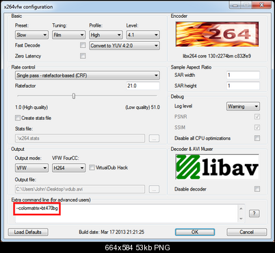

    If you use x264vfw to compress this video you should specify the color matrix in the Extra Options box. For rec.601 enter "--colormatrix=bt470bg", for rec.709 enter "--colormatrix=bt709":

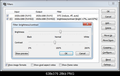

  15. Oh, I forgot to address the PC vs REC brightness issue in the VirtualDub instructions. The Brightness/Contrast filter works in YUV so you can use it to come close with the levels (the Levels filter works in RGB so you can't use that). Add the Brightness/Contrast filter after IVTC. Set the Brightness to about 7 percent -- that's about at first marker to the right of the center marker on that slider. Set the Contrast to 87%, that's about half way between the center maker and the one to its left. That will get you very close to REC levels.

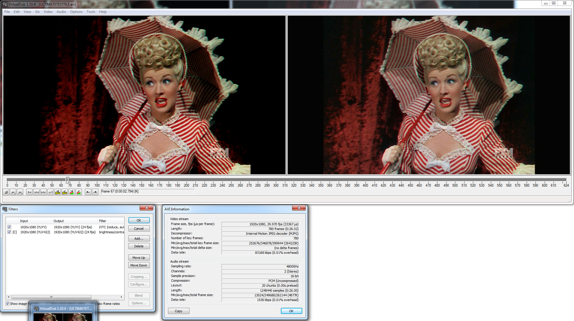

  16. Woohoo! jagabo, it worked. I ran into some problems though. Your video works great and definitely looks like the original. I followed the instructions exactly but I had a problem trying to save it as an AVI. When it started to encode it gave me error -100 or something like that. I kept messing with the encoding settings but it still didn't work. I closed the program and started up the 32 bit version of VirtualDub and followed the instructions step by step again. I noticed that after I added the inverse telecine the preview image became dark again but I ignored it. When I encoded it with the settings you gave me it came out still the same dark way.
    I then went back to the 64 bit version to give it another go and suddenly the preview was dark for that video too. I decided to untick the box you told me to tick in the preferences that says "Prefer internal decoders..." and everything was fixed. I then proceded to follow the steps again without the prefered internal decoders and it worked flawlessly. I didn't even have to use the added step in post 15, although I have saved the information for later in case I have done something wrong.
    An added note: I couldn't get the swap input output preview to work properly. I'm not even sure the output preview was even working at all. It just sticks to the frame I started and stopped at, still looking interlaced.
    Thank you so much for your help jagabo! This problem has been keeping me awake at nights, which I know is ridiculous, but I couldn't help it. I've learned so much so far in this thread about color spaces and deinterlacing as well! In VirtualDub I was using two IVTC filters one to decomb then one to reduce thinking it worked the same as AviDemux. (Doh!) I imagine this is a common mistake since you emphasize in your instructions that I should only have one filter.

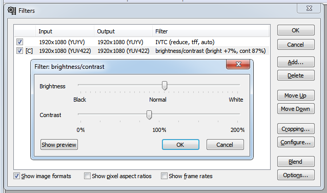

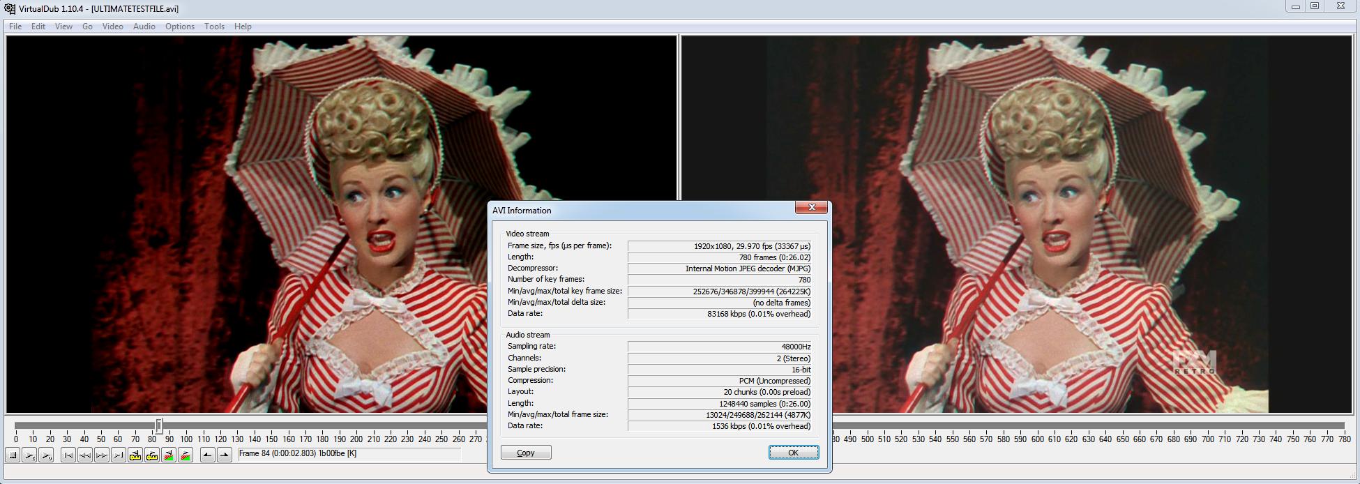

  20. Originally Posted by Plz Help B4 I Kill Myself View Post
    I still can't get the internal MJPEG decoder to work properly, it makes the video darker like it does in avidemux.
    Super darks (and super brights) should be crushed in the view panes because VirtualDub always uses a rec.601 matrix when it converts YUV to RGB for the display panes (again, that is separate from the filter chain). If you apply the Brightness/Contrast filter as specified earlier you should the see input pane with crushed black but the output pane should show dark details. In the following image I've increased Brightness by 15 percent (and Contrast to 87%) to make the change very obvious:

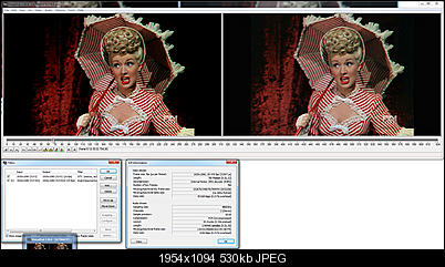

    You can see from the File -> File Information dialog that the internal MJPEG decoder is being used. In the output pane you can clearly see the difference between the black border and the dark background curtain on the left. And there is a little noise and detail in the dark curtain. In the input pane all that dark area is totally black (RGB=0). Try something similar and see if you get the same result. Verify on the Filters dialog that the filter is working in YUV. And make sure the input and output colorspaces (Video -> Color Depth) are set to 4:2:2 YCbCr.

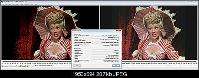

  21. I misunderstood what you were saying before. I think I understand now though. Internal MJPEG decoder does work it's me who doesn't! I did what you said and this was my result:
  22. So it's working now? Can you save as AVI?
  23. Originally Posted by jagabo View Post
    It's working now! I saved this AVI using the internal MJPEG codec and using the brightness and contrast settings you have given me. I am forever in your debt!
  24. Glad it's all working for you now.
    One thing to watch out for, some editors/players ignore the colormatrix flag and will display with whatever their default colormatrix is. Like the aforementioned VirtualDub.
    One other thing if you want to use other filters in VirtualDub, once you have reduced the luma range in you can safely use RGB filters. So I would use Brightness/Contrast first, just to be safe.
