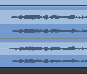

  4. Originally Posted by deadimo View Post
    this way capturing the audio separately it's a double time plus then i have to sync the audio then.
    In case everything fails and you want to save footage
    and sync audio its easy just move audio track until waveform identical to old:
    I remember I have this problem with DV tapes long time ago
    then I capture with Edius to solve the problem
    you can try 30 day trial
    don't know if its help you
