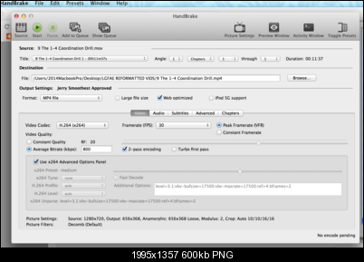

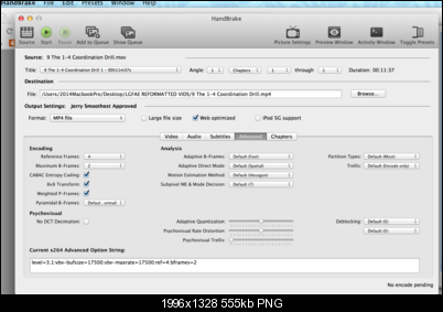

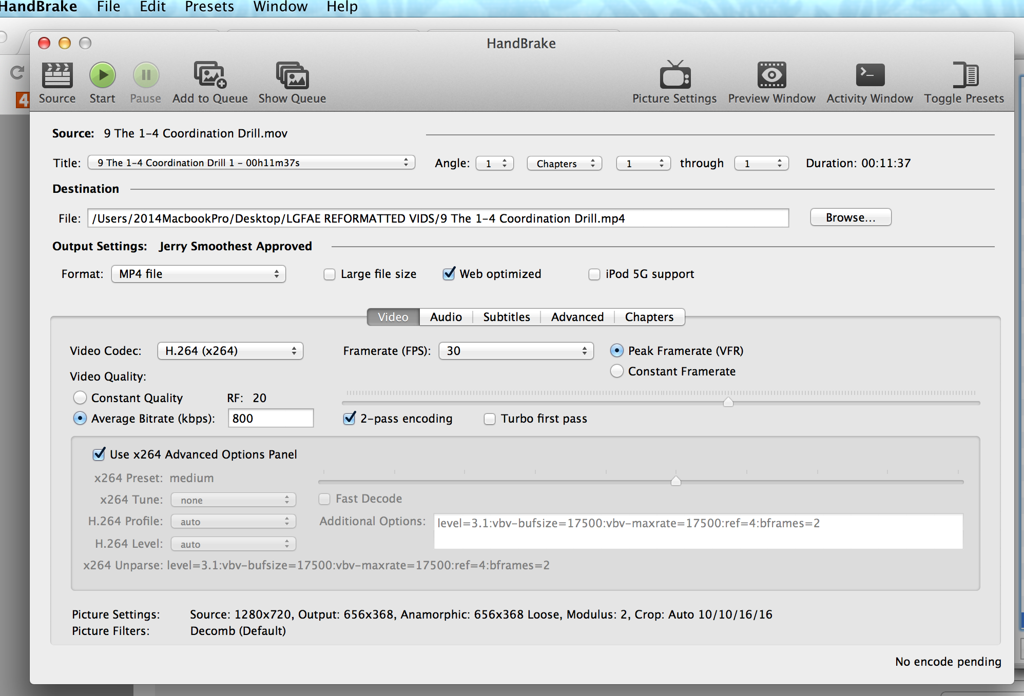

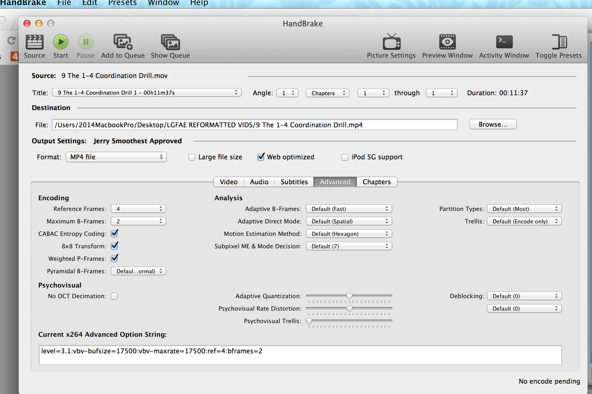

    - I take this h264 file into HANDBRAKE and reduce the actual dimensions (656 x 368) down to the size I need for my website (Handbrake settings currently used that are giving decent results are shown below).
    - After conversion in Handbrake are complete, I upload to my EZS3 account and then post those videos on my site.
    HANDBRAKE SETTINGS
    - Please see the images shown

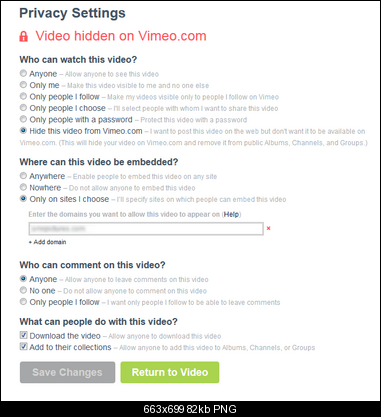

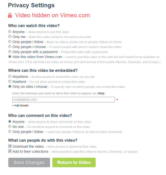

  4. Vimeo+ has an option where a video can only be played through certain domains. So you can embed the video in your website and that's the only access route. No need to have it password protected by vimeo in that situation. I use this frequently.
