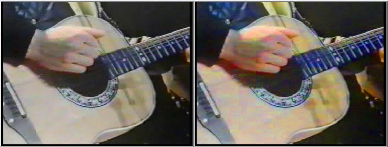

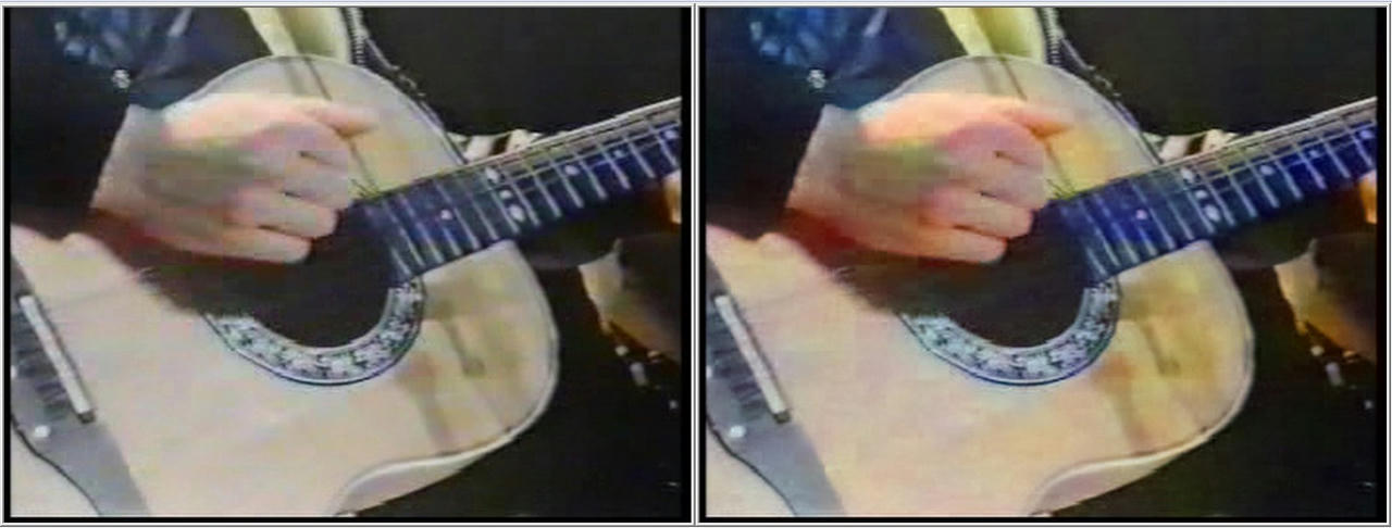

  2. If I understand your issue correctly I'd say you can try to use Camcorder Color Denoise for Virtualdub (it can be imported in Avisynth I think).
    Original -> saturated
    Original -> saturated + CCD

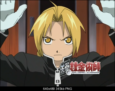

  9. Originally Posted by poisondeathray View Post
    or use smoothadjust if you don't want to work in RGB
    eg.
    smoothadjust(saturation=1.1)
    [Attachment 27167 - Click to enlarge]
    What filter is smoothadjust a function of? I apparently dont have it.
    EDIT: nvm I noticed you gave the dll name in your last post. I thought smoothtweak and smoothadjust were different things.
    If you look at the U and V planes with VideoScope() in AviSynth you'll see that Tweak() causes the U and V planes to decrease by 1 in the near-grey areas, causing a disproportionate change in saturation of those near greys (this appears to be a rounding issue). Use ColorYUV(cont_u=X, cont_v=X) instead. The rough equivalent for X is (sat - 1.0) * 256. So for 1.04 you get (1.04 - 1.0) * 256 ~= 10.
    Stab() has a similar problem. On some frames the U and V planes drop by one over the entire picture.
    While it is doing what you said and not making those show up, its also changing the colors to a slightly different hue/color, making the colors look off from the original shades. Tweak wasn't doing that.

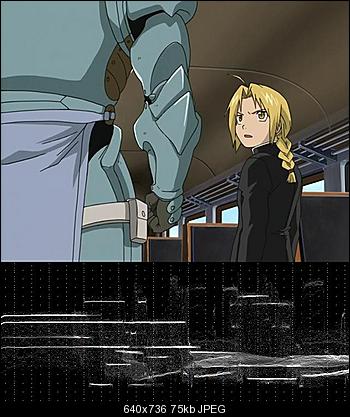

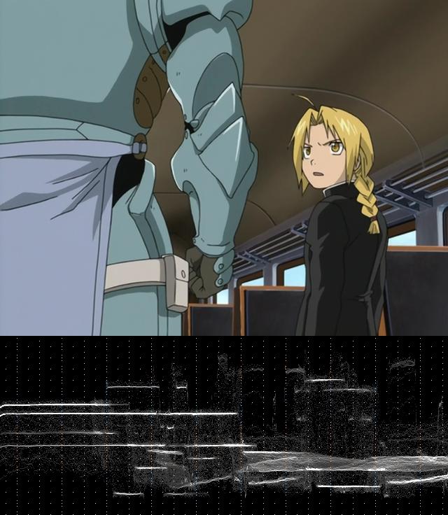

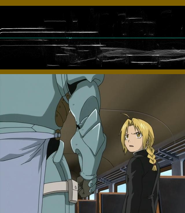

    That is a waveform monitor, not really a historgram. It's basically a graph where the brightness of pixels is plotted as height. The graph of all scan lines are overlaid to produce the final graph. The traditional waveform monitor is horizontal because CRT TVs scanned horizontally. The video signal was fed to an oscilloscope which scanned left to right, deflecting upward with the brightness of the signal.
    https://forum.videohelp.com/threads/340804-colorspace-conversation-elaboration?p=212156...=1#post2121568
    AviSynth's waveform monitor is vertical instead of horizontal. Instead of dark at the bottom and bright at the top, it is dark at the left, bright at the right. If you want a more traditional horizontal waveform monitor with AviSynth rotate the picture before calling Histogram then rotate it back to normal:
    TurnRight().Histogram().TurnLeft()
    That will give you a horizontal histogram at the top of the frame.
    TurnRight().Histogram().TurnLeft():

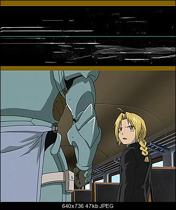

    I prefer VideoScope() because the dimmer dots are a little brighter. Unfortunately, VideoScope() doesn't explicitly mark the superblacks and superbrights like Histogram() does.
    VideoScope("bottom"):

  25. Thanks Jagabo, that explains that waveform to where I actually understand it now. It seems so simple once you explained it.
    Can you tell me whats the deal with that square in the first color one? I notice a darker outline in the square but after brightness change, it seems to go away. Is that bad and means I shouldnt lower the brightness?
    Whats my goal with that color one? do I want to keep that square outline or get rid of it? How should that look when done?

  27. Originally Posted by killerteengohan View Post
    That is a color vectorscope, or UV plot of the image. Much like the waveform monitor is a graph of brightness vs. position, the UV plot is a graph of U vs. V of all pixels. The darker border around the UV plot marks the illegal U and V values, like the brown borders on the waveform monitor marks illegal Y values. U and V must be between 16 and 240 -- the borders are the values outside that range (we're talking rec.601 or rec.709 colors here).
    The reason the dark edges disappeared when you used Tweak() to change the brightness is because you used Tweak() after building the UV plot. The inner part of the box has Y set to 16, the outer part has Y set to 0. By default, Tweak() clamps Y values to the 16-240 range -- so the dark outer portion of the box became the same brightness as the inner portion, 16.
    No, just run Tweak() (or any other YUV alterations) before calling Histogram(). Historgram() won't show you the results of those function if you call them after Histogram().
    The UV plot is of limited usefulness. For sure you want to keep pixels within the inner box. U or V outside the 16-240 range is definitely illegal. But not all combinations of Y, U, and V within their individual legal ranges result in legal colors. If you look at an image of the RGB colorspace inside the YUV colorspace you'll see that most YUV values result in illegal RGB values:
    http://techpubs.sgi.com/library/dynaweb_docs/0650/SGI_Developer/books/DIVO_OG/sgi_html/apd.html
    Only YUV values within the inner RGB cube give legal RGB colors. At Y=16 and Y=235 there is only one legal U and one legal V value -- 128. Around the middle of the Y range (half way up the Y cube) you have the largest number of legal U and V values.
    That also explains the green/purple splotches you are seeing in dark areas. In those dark areas there are only a few legal U and V values and the difference between successive values are big enough that you can't get smooth gradients (actually, this is true over the entire RGB cube but it's most visible at nearly pure greys). Some noise in the original source combined with blockiness from the MPEG compression resulted in those splotches.
