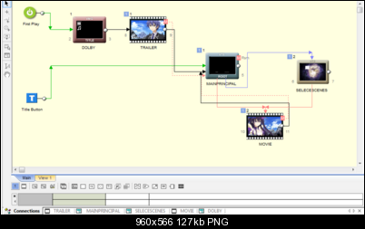

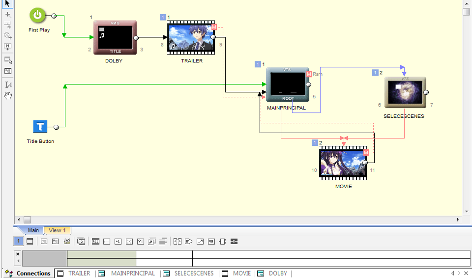

    I'm new to this forum, but if I had basic knowledge of auditing but to create my DVD projects. I'm using the DVD LAB PRO 2.51 and my problem is regarding the Title Button does not go to the menu that (PLAY, SCENE SELECTION, EXTRAS, etc) buttons are displayed ONLY.
    The catch is that I only binding to the "MAINMENUOPCIONAL" to "MainMenu" with the "MENU BUTTON LINK", by which the VMG and Trailer tool to tighten as much as "Title Button" and "Menu Button" go to MAINMENUOPCIONAL (first time), from there everything is normal as do traidicionales DVDs, like if I give a second time (when I'm in "MAINMENUOPCIONAL") only button on the menu control leaves the "MAINMENUOPCIONAL" to "MainMenu "all good from there.
    Now the problem is, since it is in the "MainMenu" by pressing the button "Title Button" this should be in the same "MainMenu", by which does not do that, if not return the "MainMenu" to "MAINMENUOPCIONAL" and when I want to give you back the "Title Button" again stays in the "MAINMENUOPCIONAL" is not going to "MainMenu" as it should be.
    It would be nice to answer me to my problem, I already look for tutorials on this but only found the reference of the "MENU BUTTON LINK" for not making more complex connections.
    The question is how you should do ?, if there is any tool or programming for the "VTS ROOT" and "VTS" Normal in the "Title Button"?

    You will never get to "Main Menu" by pressing Title button on a remount control. It will always go beck to a ROOT menu since this is a principal menu in VTS and your main menu is a secondary one.
    You have two options:
    1) Easy one is to putt all buttons from Main Menu to Root Menu
    2) Not so easy: You can assign an "R" (registry) value to a button in Root which links Main menu and insert a command in Pree Command section of Root Menu that when R is your value than go to Main Menu, than the remount will do what you want, but First play will play only on initial insertion of a DVD into the player.

    Here is a command and connection file. I am using GPRM11 because that is the one which changes when you use a Menu Connection icon.
    Look at the command file. Right click on a Title Button, you will get( Edit VM Command) bar, left click on that and in editing window add command as shown.

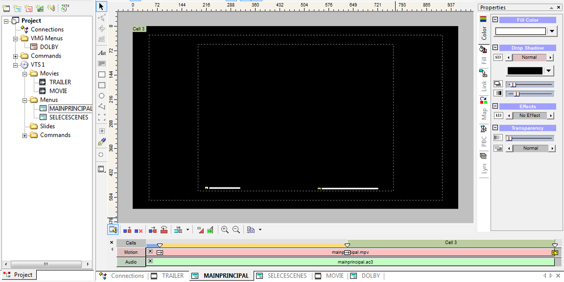

    Hi, thanks for helping. Rather another query. What if I have to cells, bone in the main menu have sub divided into three cells, cell 1 would be the animation is started until the radio buttons appear, then cell 2 would be the longer buttons pending the animation playback so that by passing the cell 3 again is ONLY reset the animation but the radio buttons are already without the need to restart it all over again.
    Now, pressing as much as the TITLE BUTTON and MENU BUTTON buttons for the first time to start the DVD, you must go to the beginning of the animation, and when pressed a second time as much as the TITLE BUTTON and MENU BUTTON this must happen automatically to the cell 3.
    As well when you enter the scene selection, languages or extras, and return to the MAIN MENU, it should call the cell 3.
    How would that?. as serious programming ?. would be good to do it step by step (with pictures). And excuse me to ask another query again, but thanks for the help.
    Here I put some images. The first is the topology of the structure and the second is to be the main menu with the split cells.

    The part with splitting a cell can be done, but DVD Lab editor does not let you change a cell command section. You will have to use some other editor like PGCEdit, it is a free software, but little harder to use.
    The part with the double button click cannot be done, because DVD is not set up that way. By pressing those buttons will always get you to the beginning of Title or Root Menu.
  8. Conditional jumping or linking to better keep DVD navigation terminology (linking within a PGC) to certain cell in menu is better done in PGCEdit as was said. You need to set a flag after going through that menu first time and be checking that flag (a register value) upon entering root menu. It is very easy but very difficult to explain.
