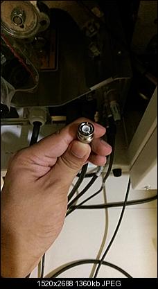

    My dad has an eye surgery machine which came with a Sony RDR AT105 DVD Recorder so we can record eye surgeries to give to patients / educational purposes . There is a cable running from the machine to the DVD Recorder. The connector on the surgery machine end looks like this - Click image for larger version

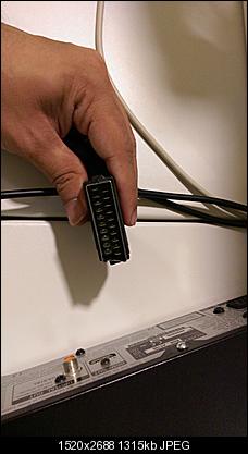

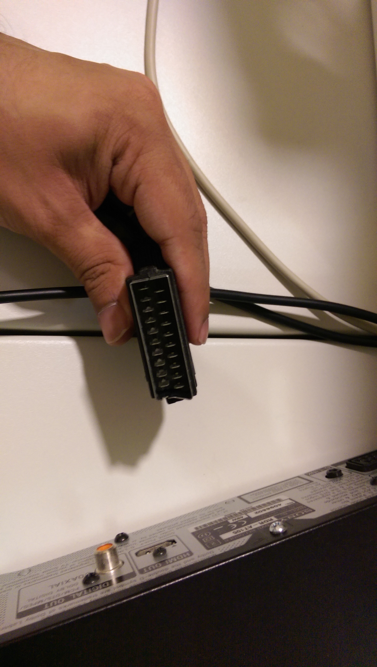

    The connector on the DVD Recorded end looks like this [googling a little bit tells me it is a SCART connector] -

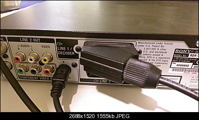

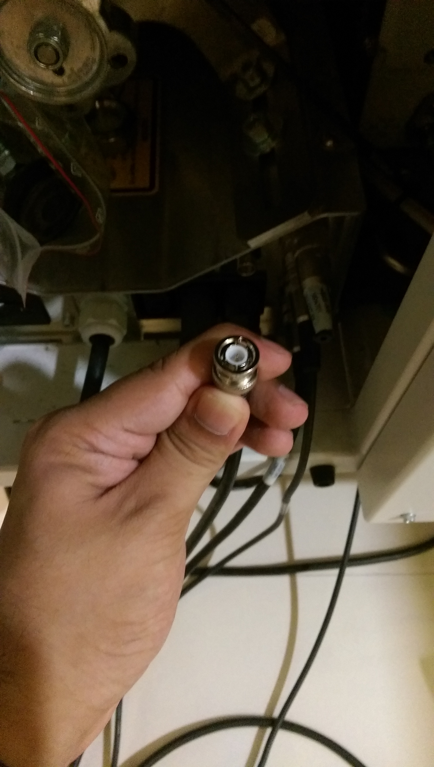

    It goes here -

    It looks like your surgery machine is sending a composite signal, so you can use any device which accepts a composite input. It doesn't have to have a SCART connector. If you already have a computer with USB and DVD burner, just get something like the EasyCAP DC60 and a BNC-to-RCA cable (or adapter).

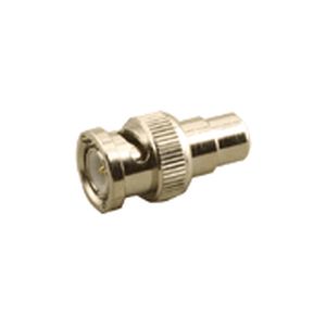

    You need a BNC male to RCA female adapter to plug into the same connection on the surgery machine that you use for its custom BNC to SCART cable.

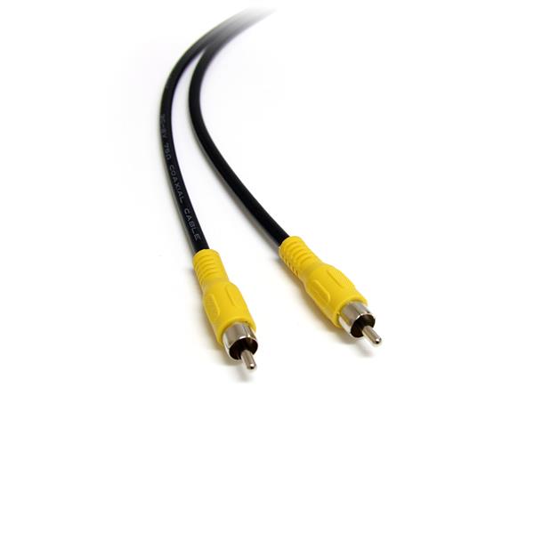

    The adapter would allow you to use a standard RCA composite video cable to connect a DVD recorder with no SCART connection.
