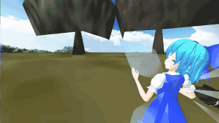

    A practical use of background remover: when the background interfere with tracking.
    With either MK-I or MK-II, the blocks are likely lost when crossing the sky-ground boundary
    [Attachment 28594 - Click to enlarge]
    Apply the kNN background subtraction.
    Track this block-only image with your method-of-choice:
    (I tracked the bottom block with MK-II mode 3, while the left one with MK-II mode 1)
    [Attachment 28595 - Click to enlarge]
    Use EXO Stacker to merge the two EXO, and load into Adv.Editing for final composition.
    [Attachment 28596 - Click to enlarge]
    I have attached the source video AVI so that you can try it yourself.

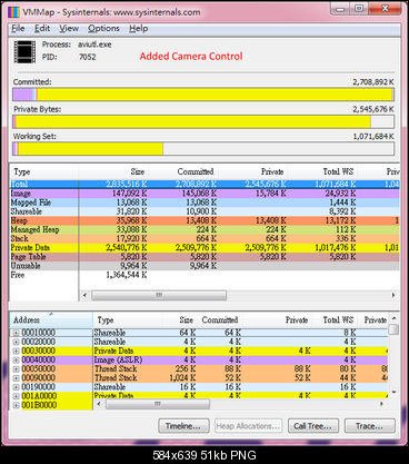

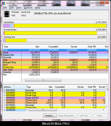

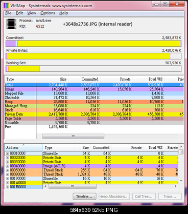

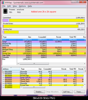

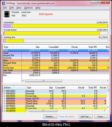

    Originally Posted by MaverickTse View Post
    Originally Posted by PhotoCat View Post
    High resolution jpg file in slideshow. How to zoom to 1:1 in high quality?
    I have imported a jpg file of size 5616x3744 using Maverick's auto shrink plugin. However,
    I have discovered that when I zoomed the image in aviutl to 100%, the quality was significantly
    worse than my image viewer (faststone) in 100% view (ie less detail, less sharp). Is there anyway to preserve
    the original image quality in aviutl when zoomed in?
    I am guessing the auto shrink plugin will just shrink down the image file into a smaller sized image that
    aviutl can handle, and therefore zooming with aviutl of the same image will not bring back the original
    image quality. Not sure if this is the reason...
    Thinking about a workaround... Should I just crop the original image in the face area rather than shrink it... ?
    Anything I am missing? Pls advise! Thanks!

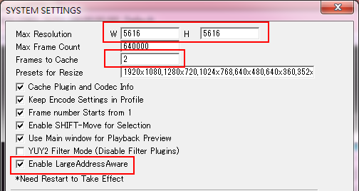

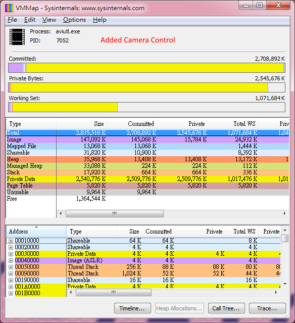

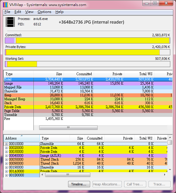

    Yeah, that's right, I just shrink whatever oversized image to what AviUtl can handle at current settings.
    The size that you just loaded the image is ALREADY the MAXIMUM AviUtl can handle properly. If you magnify it, even by 1 pixel, the usual problems occur.
    Ask your self again do you really need such resolution. Are you making an A0 poster instead of making a video?
    5616x3744, when expanded in memory, leads to a 80MB RGBA data block. Considering the intermediate shrunken image, you can take it as 100MB.
    If you need an oversized background while only need to show part of it at a time, try using the SVG Custom object.
    First embed you image in SVG using Adobe Illustrator or InkScape (If using Inkscape, do not apply any deformation);
    Then add "Adv@svg-render-EN", point it to your SVG file.
    ok, finally tried to embed a 21meg 5616x3744 jpg file into .svg using Illustrator. Unfortunately when I import the .svg file into aviutl as
    a SVG custom object (adv@svg-render-EN), aviutl was almost ground to a halt - it became vy slow. The preview screen is black though.
    Tried auto@svg-render-EN & basic@svg-render-EN. Same thing.

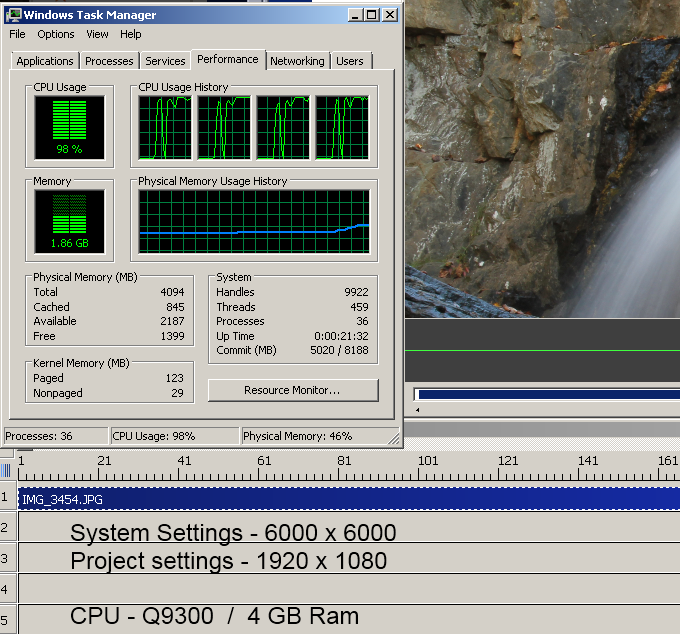

    @ PhotoCat. My camera (t2i) shoots 5184 x 3456. I set system resolution @ 5184 x 5184 and it seems to work fine in my test.....
  22. Member
    Aug 2014
    Canada
    Thanks racer. Mine said insufficient memory & crashed! I only hv 10GB memory... but this is 32bit app anyway...
    I set the max input size to 5616x5616 but created the project at 1080p.

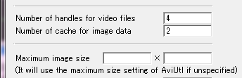

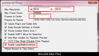

  24. Originally Posted by PhotoCat View Post
    Try right-clicking on the timeline > Preference, then reduce the following values:
    An also:
    SYSTEM SETTINGS > Frames to cache
    --> reduce to 2
    Stopping development until someone save me from poverty or get me out of Hong Kong...
    Twitter @MaverickTse

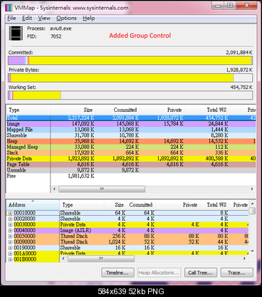

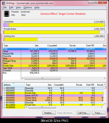

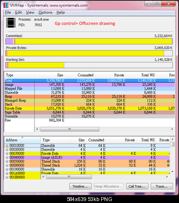

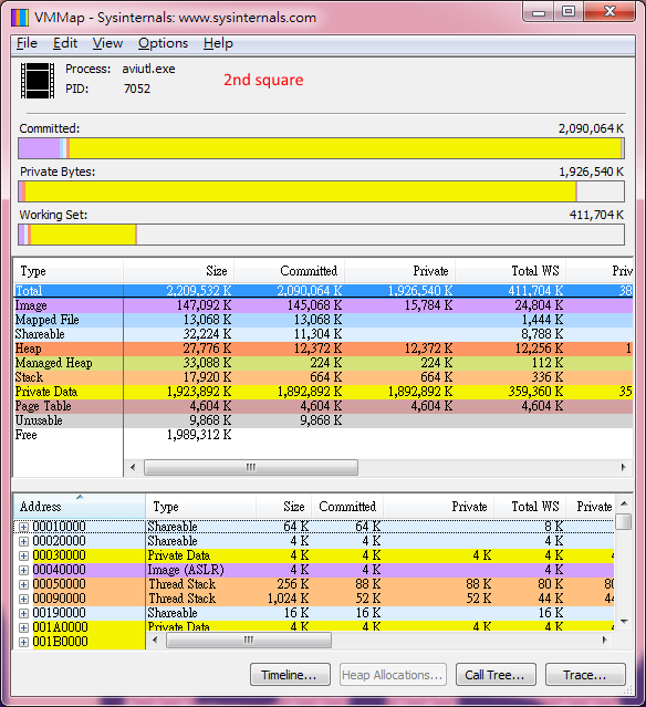

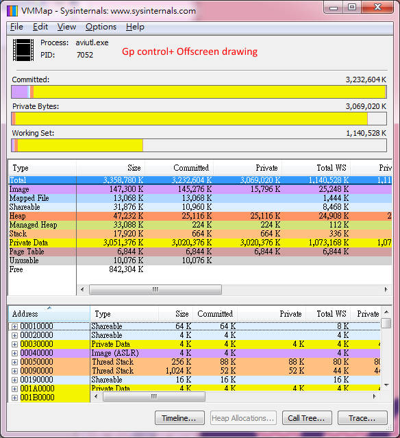

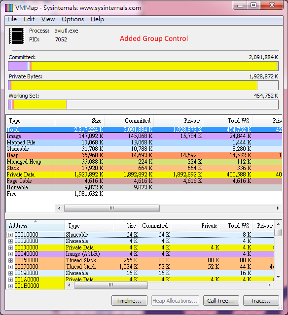

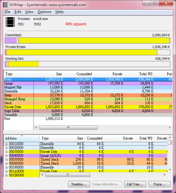

  25. Memory usage analysis on large (internal) image:
    Settings:
    Free memory:
    FullHD empty project→ 2,490,880K
    1x 2000px*2000px square → 1,989,568K
    2x 2000px*2000px square → 1,989,312K
    4x 2000px*2000px square → 1,989,312K
ID:	28992Click image for larger version
ID:	28993Click image for larger version

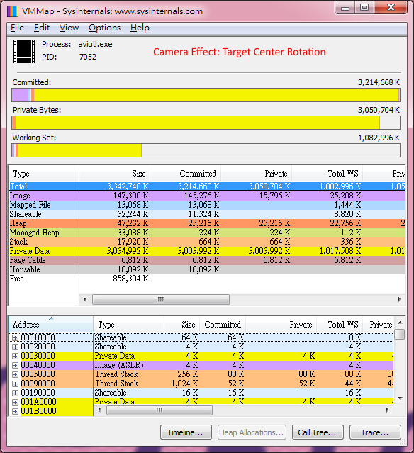

    +Group Control → 1,981,632K
    +Camera Control → 1,364,544K
    +Camera Effect:Target Center rotation → 858,304K
    +Group Control+Offscreen drawing+Gradient → 842,304K
ID:	28995Click image for larger version
ID:	28996Click image for larger version
ID:	28997Click image for larger version

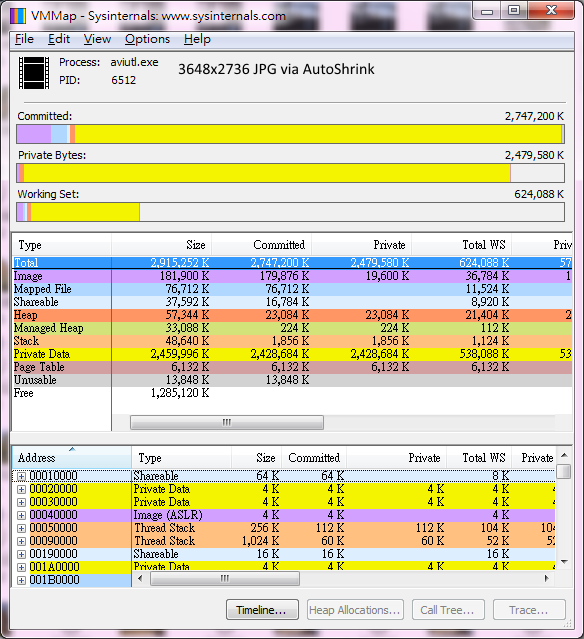

    read a 3648x2736 JPEG via internal reader → 1,495,360K
    read a 3648x2736 JPEG via AutoShrink→ 1,285,120K
ID:	28999Click image for larger version

    I did a test setting system size to 6000 x 6000 and got insufficient memory error, but it worked anyway. I'm running an Intel Q9300 with 4 GB Ram on win7 x64. I'm using the latest Aviutl 1-9.
    You'll probably have to render each large image one at a time to a lossless codec, then re-import. Attached is a screen grab while rendering:
