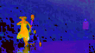

    2> Added "HSV Cvt"
    -- Convert RGB data to HSV representation, then display the HSV image as RGB or grey-scale for individual channel

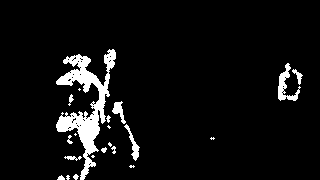

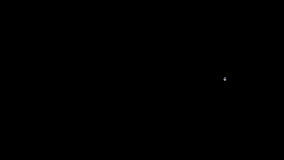

    3> Added "Background Subtraction"
    -- Using MOG2 or kNN method, attempts to isolate the moving object from the background.
    -- can either output the mask alone, or the masked image

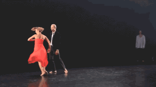

    Original Sample:

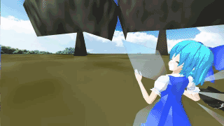

  22. A practical use of background remover: when the background interfere with tracking.
    With either MK-I or MK-II, the blocks are likely lost when crossing the sky-ground boundary
    Apply the kNN background subtraction.
    Track this block-only image with your method-of-choice:
    (I tracked the bottom block with MK-II mode 3, while the left one with MK-II mode 1)
    Use EXO Stacker to merge the two EXO, and load into Adv.Editing for final composition.

    Originally Posted by racer-x View Post
    Great job on the improvements to Motion Tracker MK-II. I noticed that mode-3 will auto resize while tracking, That makes quick work of face blurring etc.....
    Yes I know it's plain wrong to blur such a pretty face, but I had to test it on something. Motion Tracker MK-II > mode-3 + quick blur:
    Can you try the "Easy Privacy" option of MK-II on the same video and see how well/poor it works?
    I did try it out at the same time. "Easy Privacy" was significantly slower. It did look a little cleaner on the face, however there were many strange errors on intermittent frames in various locations. Almost like a mask was appearing and disappearing all around the frame.
  27. Originally Posted by racer-x View Post
    This surprise me... I suppose it would find one face only.
    Can you upload the original clip?
    Stopping development until someone save me from poverty or get me out of Hong Kong...
    Twitter @MaverickTse
  28. Member racer-x's Avatar
    Mar 2003
    3rd Rock from the Sun
    Attached is the source clip trimmed on I-frames, so no re-compression. Just for fun, I gave her a hat to shield her from the sun's rays.
