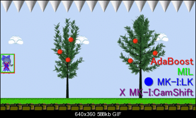

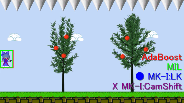

  24. A comparison of Mode 1-3, and two (fastest) tracking modes in MK-I
    Stopping development until someone save me from poverty or get me out of Hong Kong...
    Twitter @MaverickTse
