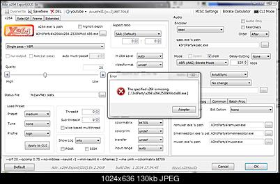

    Hi. Ahm, I'm starting to use AviUtl, but I got an error at exporting. How to fix it? Thanks in advance.Click image for larger version
    Edit: Nevermind. I solved myself hehehe. Thanks n_n"

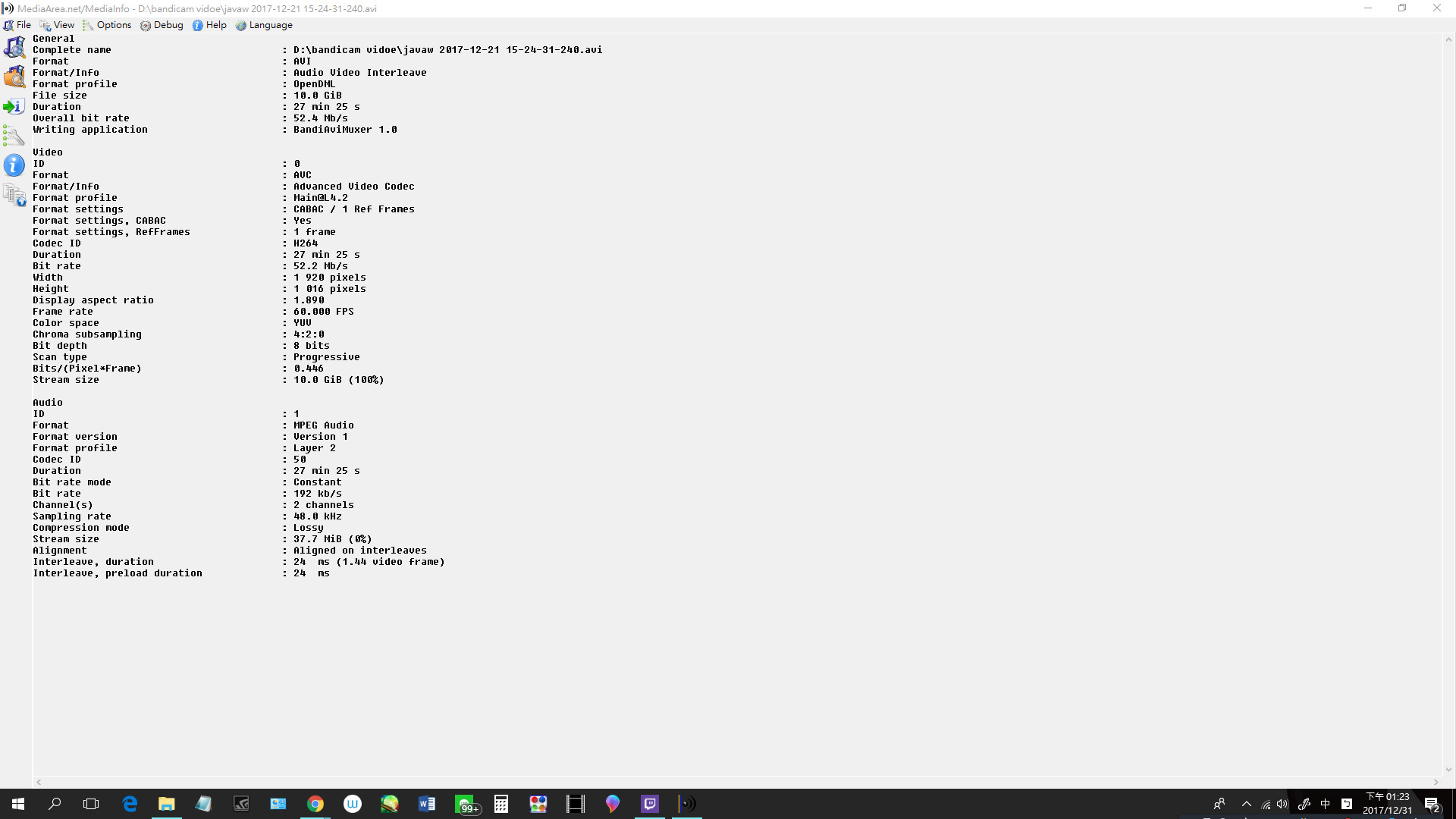

    Hello, I'm the new user of Aviutl, and I have got some trouble while I was editing. At firstly when I put the original video into aviutl, the picture and sound attach perfectly, but after I split about 15~20 times the sound and picture are not play at same time anymore the sound always came up 1~2 second earlier than the picture. And I hardly to find solution on internet it seems like nobody really getting trouble with this or maybe it's my recording program's problem?[my recording program is Bandicam] can anyone help me to solve this problem?
    P.S: I have already tick VBR-->CBR.
    Thank you.[ first time posting text on this website, so if I post to the wrong place or said something wrong please tell me and I will delete this message ]
  9. Originally Posted by liu071791 View Post
    Did you mean VFR , not VBR ?
    What does mediainfo (view=>text) say about the source ? If it is VFR , l-smash doesn't do a good VFR to CFR conversion in my experience.

    [Attachment 44243 - Click to enlarge]
    Did you mean this one, but I didn't see it's CFR or VFR[thank for correct the words] have got any idea about it?
  11. Originally Posted by liu071791 View Post
    AVI is always CFR - so that' s not the problem
    I don't know what the problem is, but it might be long-gop h264 in AVI container. The AVI container can have problems with long gop formats and seeking; sometimes frames get mixed up or you get green frames. Eitherway it's can pose problems unless you record in I-frame
    So you might try remuxing into a different container like MKV (mkvtoolnix) first, before editing
    You might be able to save your work / edits by just replacing the clip (not sure) , depending on how you have the project set up.

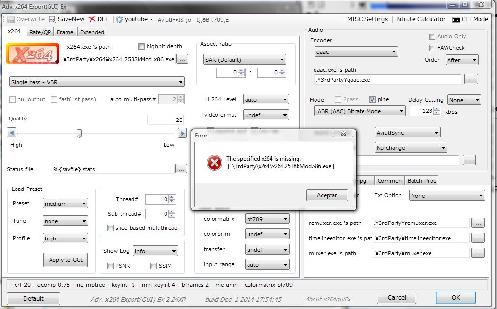

    I'm getting a issue here. I downloaded Rigaya's Nvidia encoder. I installed it, but I can't render, and I can't understand the error. Btw, I have the last graphic driver. I have a Asus Rog Strix GTX 1060 6Gb. Processor AMD Ryzen 7 1700x. If someone can help me I will thank A LOT.
Name:	error nvenc.JPG

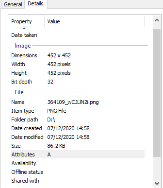

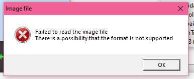

  22. Not sure if anyone'll see this, but I seem to be having a problem that I don't understand.
    So basically, I've drawn sth, I've exported to png files (I've experimented with different resolutions/dpis) and this error message comes up "Failed to read image file";
    [Attachment 56288 - Click to enlarge]
    I've tested it with a transparent png file (from picrew, if it makes any difference) w/ the properties in the image below - and this works...
    [Attachment 56287 - Click to enlarge]
    I don't understand what's wrong, maybe I should makes sure it's cel-shaded instead of blending things?? but then I'd probably have to make sure the outline is also in that style

  23. Originally Posted by 3ai6chan3 View Post
    What are the properties of the one that does not work ?
    In aviutl you can try changing the import plugin priority (file => settings => import plugins directory) . You can try moving the JPG/PNG reader higher up the list. You might have to close and restart to take effect
    You can try re-writing the PNG with another tool, either into another PNG, or another format like AVI or MOV, then importing into aviutl . Try vdub2 . File => Export => Image sequence
    You can try other free editors like shotcut - easy to use, many tutorials . Davinci Resolve is probably to resource heavy for you, not enough ram

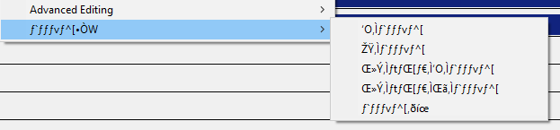

  24. I've tried EP1-10 again and PNG should work out-of-the-box. Make sure you do not swap any program or plugins from elsewhere. You may post a sample of your failing PNG file for us to test.
    If you use the Japanese version, you have to set your system codepage to Japanese, have the font for Japanese, in order to properly show any Japanese character. If you can read Japanese anyway, then there's no need to use the packages here.

  25. Originally Posted by 3ai6chan3 View Post
    I've attempted to use Blender (and a couple other freewares?), but since I have little-to-no experience w/ video editing, I feel like Aviutl is a better place to start for my purposes...[will probably try in Blender etc. in the mean time]
    Oh yeah, also my computer only has 2GB RAM, so....I 'feel' like Aviutl works, and exports a little bit faster??
    You need to FLATTEN your image (in photoshop language). No layer, No fancy feature, typical RGBA. or you may also try BMP. Try opening your PNG with IrfanView and save it to another file.
    2GB RAM is WAY under spec. You need to close all other programs to do any video/Image editing, and still the experience will be PITA. Minimum will be 4GB.

  26. Thank you both for replying!
    I've changed the language to install the other version again, and the Japanese characters are appearing properly - the image files also seems to work through that version (again, I don't rly understand why....but it's working)
    Honestly, I'm not too confident about reading Japanese - my Chinese also kinda sucks so I can't tell if kanji is easier/harder to understand sometimes - but I think I'll manage
