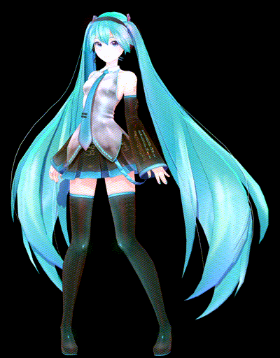

  1. still image animation example, project with assets attached below
    gif preview
    Original image from
    http://digitrevx.deviantart.com/art/MMD-Miku-Hatsune-V2-YoiStyle-DL-531222758
    I only did 2 parts to illustrate using 2 different methods in this example. Miku's L. long hair, and 1 front frond with a deformer
    I don't think aviutl allows you to move the "anchor point" of a layer like you can with other programs, so it can only rotate on the central axis of a layer. So when you are masking out layers, you need to reposition the layer such that the rotation axis is in the center . The L. long hair used this method . There should be many tutorials on masking out layers on youtube
    The front hair frond used simple wrap v2 (a deformation) to animate
    The animation is "rough" in this example (it's just to illustrate quickly a couple of methods to animate), - but you can do a better job with the timing
    So you would use the same techniques on multiple layers to get layered clothing, hair etc... to animate . You can also combine deformers and rotation of layers.
    Another way you can get even better results in real 3d, is to use a 3d application like MMD (miku miku dance) , or blender . Both free

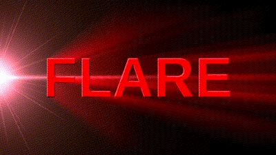

    3rd Rock from the Sun

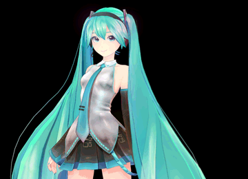

    If you enable "Advanced Drawing", you can adjust center in x,y and z directions. You won't need to use scenes unless you want to..

  3. Yes it looks like you can move the "axis center" with "advanced drawing" , or what I called the "anchor point" above. I haven't even used advanced drawing before , thx racer.
    Just to note - A little "+" sign in the preview will denote the axis rotation center location, so you know what values to move / position the layer

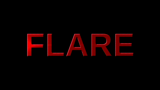

  17. I'm trying to find/figure out two things, hopefully somebody can point me in the right direction:
    1. Is it possible to have the Flash effect move from left to right behind text? So it is like a light behind it moving over the letters?
    2. I know it was somewhere but I cannot find it anymore. Can I trace text (or anything) with a light/glow? I'm sure it is possible as I saw the Vegas clip once (cannot find it anymore). Just trying to find out what technique i need to learn to do this.

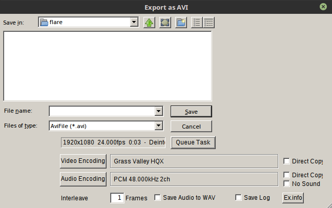

    Hi! I've been having this problem for about 2 days now.
    I've created my very first video for a song, and everything plays exactly how I want it to play in aviutl. But I am having various issues with exporting my video.
    I have tried just a normal AVI export. The result: no sound.
    I have tried plugin export (Avd. x264 Export(GUI) Ex, and Avd. x265 Export(GUI) Ex) to get no video and no sound.
    I've edited all the paths to point them to the proper places but no matter what I do I'm always missing the audio, and now the video too.
    I have no idea what to do now. I've updated aviutl to the latest version in hopes it would fix my problems, but it didn't. I'm going to tear my hair out in frustration. Can someone help me?

    I'm not sure what you're asking. Here i'm showing a simple animated flare. One behind the text, the other is used as a mask to shine on the text.
    In the AVI export window, make sure that "No Sound" is NOT checked.

    I have made sure that it is not checked the very first time I tried exporting. But there has never been any audio exported regardless of that.

    If exporting avi, make sure to use PCM audio.
    I do. I have never changed the audio to anything other than the default PCM.
    Thanks, but not what I meant. I will search for a thing like it.
    I might have named it wrong, since it is called Flash (i think) in Aviutl, but I found a static effect like it here;
    https://www.youtube.com/watch?v=RTkMkfNFd68
    I'd like to automate something like that moving from left to right.
    I already created an awesome effect with that Flash plugin/effect for something else, I thought there might be something similar maybe.
    Thanks again.

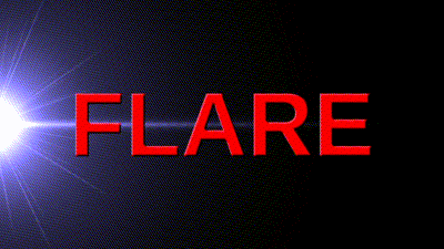

    Oh, ok. Something like this then?
    Image Attached Images
  26. Originally Posted by racer-x View Post
    Something like that, without the big white lens flare
    Cheers.
