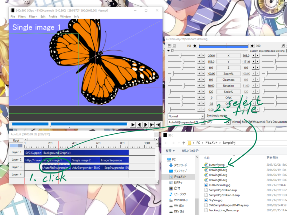

    3. For the file that gave me error upon opening, it's the "SVGSampleUsage-2014May" in the SamplePrj of the v1-10 version. I had a bit of a problem with .dll dependency when using the latest installer so I also saved that version. As for the effect error, I can't remember the exact effect and so far haven't been able to recreate it. From what I remember, it was when I was trying to input a decimal value on one of the animation effects. If it happens again, I'll be sure to post it here.

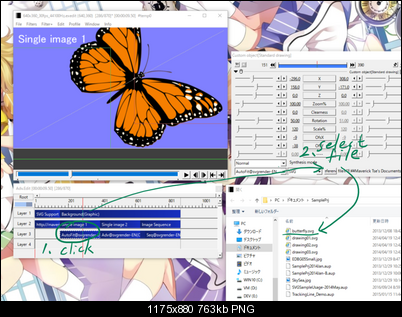

  6. Originally Posted by nashi View Post
    Thank you for the detailed response! I'm glad to learn that the Toolbox menu is not necessary.
    I am able to track down the error. It is due to invalid filename reference.
    When you open that SVG project, click Yes on the error popup until it go away.
    Then fix all the layer 3 objects like the following:
    (for the last SVG object, choose the drawing01.svg)
Name:	fix_svg sample.png
    When done, choose File > [ Project ] Overwrite
    to save the project.
    Close AviUtl, start it up again and load the SVG project again.
    Stopping development until someone save me from poverty or get me out of Hong Kong...

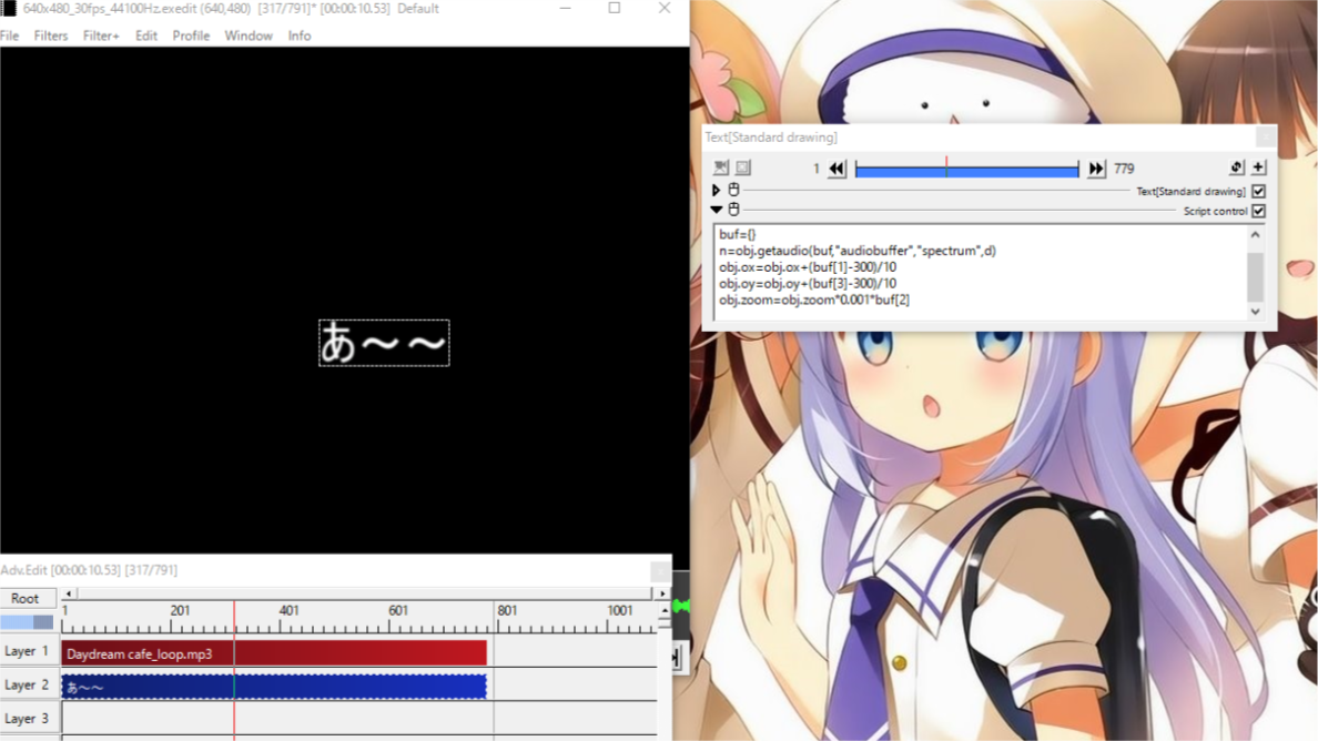

  16. Thanks, can you explain to me something bout the script thing to make the zoom effect at the music's rithm??

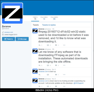

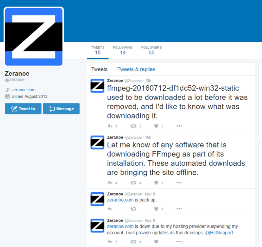

  17. EMERGENCY ANNOUNCEMENT
    Major FFmpeg distribution site, Zeranoe, seems to have experienced a bandwidth problem.
    It seems that the site BLOCK all bots and scripts from downloading, while usual download using common browsers should be fine.
    Though probably not caused by AviUtl installer, I urge everyone STOP using AviUtl Installer 1.11 and 1.12 and delete them.
    The current installer would not work either unless you uncheck the components relating to FFmpeg.
    For the meantime, go to the "old version" link and get v1.10 standalone

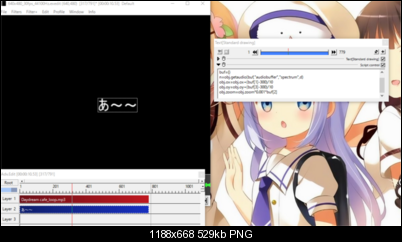

  18. Originally Posted by Saiwo View Post
    First have a look at the screenshot below:
    The screenshot shows a minimal project, with an audio track and a text object below it.
    The text object, has a "Script control" effect attaching to it.
    The content:
    d=3
    buf={}
    n=obj.getaudio(buf,"audiobuffer","spectrum",d)
    obj.ox=obj.ox+(buf[1]-300)/10
    obj.oy=obj.oy+(buf[3]-300)/10
    obj.zoom=obj.zoom*0.001*buf[2]
    here, d is a simple numeric varaible, buf is an emty array.
    the obj.getaudio() function sample the currently playing sound (due to the "audiobuffer" string here, you may also try to replace it with a filename),
    present it as a spectrum with volume against frequency range (due to "spectrum" keyword, other options are "pcm" and "fourier")
    and group the frequency range into 3 groups (due to d=3. you can get a finer division by increasing d. "fourier" has a fixed value of 1024 for d).
    n is the number of audio sample which is rarely used.
    this function put the volume data into the array "buf" and you can access it with index value 1...d
    in this example buf[1] is the bass, buf[2] is themidrange, buf[3] for the high pitch area.
    Now comes the tricky part. You want to move the text or image using such audio data.
    obj.ox and obj.oy represents the coordinate.
    You see I'm doing a bit of calculation here... /10 to reduce the value range and -300 to make some value +ve while some with -ve.
    YOU WILL NEED TO TWEAK THIS PART to get the desired result.
    obj.zoom set the magnification.
    Surprisingly, obj.w and obj.h are read-only. So if you need to deform width independent of height, you will need to call other functions.
    Twitter @MaverickTse

  20. Member racer-x's Avatar
    Mar 2003
    3rd Rock from the Sun
    Changing the divisor to around 50 makes it more uniform and less erratic I think. I like the effect, it's kinda a throwback to the 60's / 70's.
    d=3
    buf={}
    obj.ox=obj.ox+(buf[1]-300)/50
    obj.oy=obj.oy+(buf[3]-300)/50
  21. Hint:
    You may want to make use of the trigonometric functions, esp. Sine and Cosine, to make the buf array more manageable.... guarantee to transform it into -1...+1 range
    the trigo function is a part of LUA math library
    obj.ox=obj.ox+math.sin(buf[1])*100

    Probably media object => particle output set to "square" . Some keyframed parameters like size , position of emitter, gravity . Probably done as two separate instances , left and right. They are not mirror symmetrical
  24. Member racer-x's Avatar
    Mar 2003
    If you enable "1char1obj" in the Standard Text Drawing it makes for some cool effects. It takes me back to the 70's.....

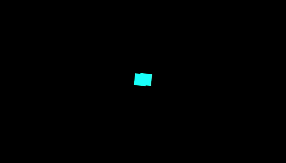

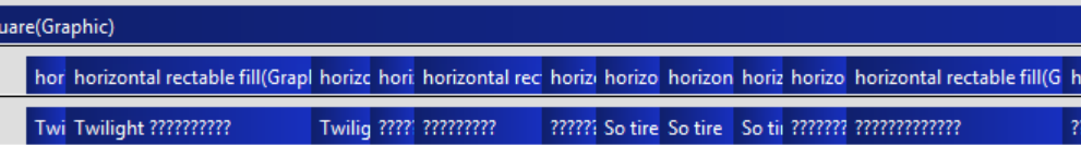

  30. "blue box" particle wipe reveal example, project attached below
    gif preview
    So the blue boxes is just 2 instances of the particle output as mentioned earlier. Play with the settings to get what you want, but this was set to "square" . I was lazy and used only 1 instance in scene 1, and in the root scene I just duplicated it and rotated/positioned it . Add motion blur or whatever other effects to customize . The timing in this sample project is slow motion so you can "see" what is going on more easily. The gif preview shows a more sped up version (frames dropped /subsampled) , but slower than the youtube example. You can change the timing to whatever you want. Once you get it how you want, I recommend you render it out as a RGBA intermediate, so you can use it again easily without having to recalculate motionblur etc.. each time. Likely that is what the user in the youtube video did. It will be much faster as a pre rendered asset when you are making a final video
    Of course you can change the particle shape, color, timing etc... or combine multiple layers or instances with alpha channel. Don't limit yourself to doing something similar as to what the other video showed. Learn from the basic technique and expand on it, be creative
