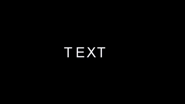

  28. Hello I was wondering if any one know how can I do this effect
    https://www.youtube.com/watch?v=Eo4lDmimpng '0:44 to 0:46', the text begin to separate....

    One way to do it is keyframe the movement at different rates. ie. the outside letters move faster than the inside letters. You can do this by using layers.

    .....And that should give you something like this.
