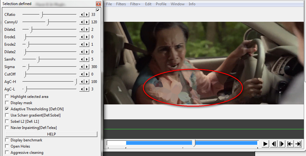

    thanks i have the IppRepair working now and tried testing a small area of subtitles but how can i stop it blurring the part where subtitles are
    as you can see here its blurred
  9. The mask created, using the default setting, may be too large.
    Tweaking is required.... (those sliders above)
    The ideal mask (the red highlights), should be just slightly larger than the text
    You can post a screenshot here (using MPC-HC or VLC, with the subtitle) for us to try tweaking it.
    If there are sections without text that got messed, you may use the "profile" feature of AviUtl to switch the plugin on and off, or cut the video in to segments prior subtitle removal, than join them back.

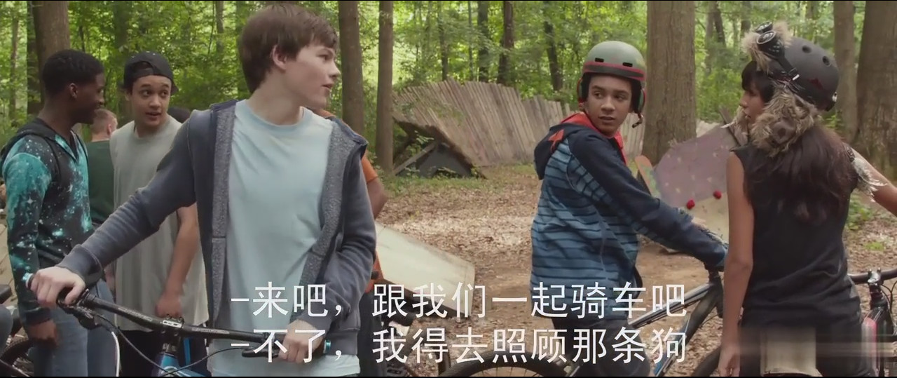

    here is a screenshot of a long subtitle
  11. I saw your another thread.
    and then I know why you AviUtl installation has no IppRepair by default: your CPU is too old.
    In this case, use a faster but less complete remover, also in the AviUtl package, regardless of your machine spec.
    (I hope you are not working with warez...)
