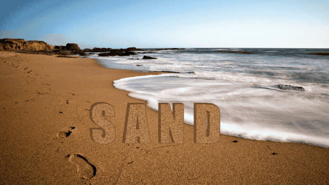

  1. Sand Effect
    Stopping development until someone save me from poverty or get me out of Hong Kong...
    Twitter @MaverickTse
  2. Member racer-x's Avatar
    Mar 2003
    3rd Rock from the Sun
    Excellent! Thanks to posting the animation plugin, I'll try it out when I get home.

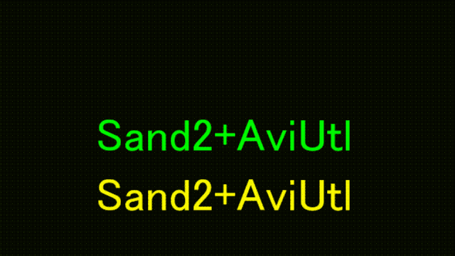

  3. Member racer-x's Avatar
    Mar 2003
    Works great, thanks....
