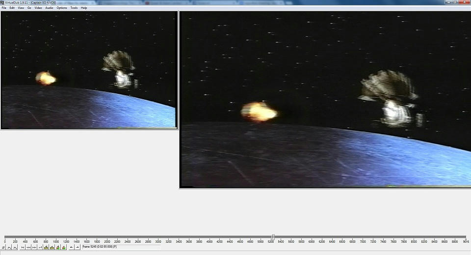

  4. I think deinterlacing should be done first regardless of what source is it.
    If you resize first then you won't be able to properly deinterlace it.
    Examples below.
    Resized to 1280x720 -> yadif
    Yadif -> resized to 1280x720
    Once you have done this you can add any other filters you please. That's how I would do.

  15. Looking for something like this?
  16. Anonymous
    Guest
    that looks pretty good, was that qtgmc or just yadif with double frame rate in avisynth? did you use any denoising?
